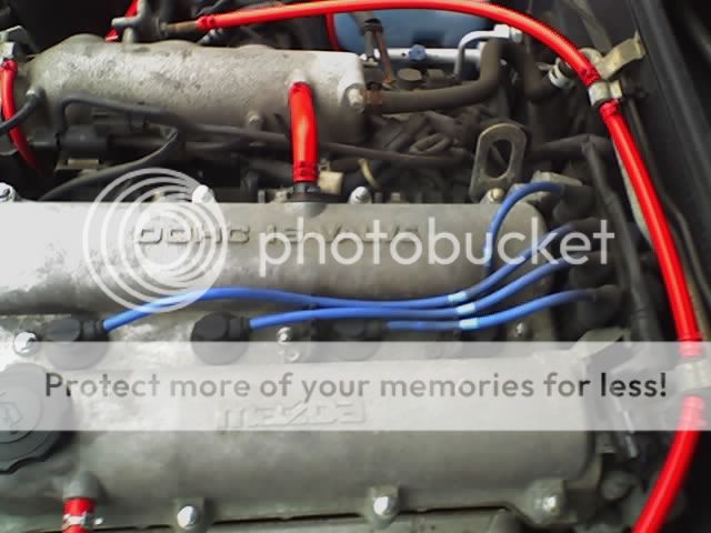

heres the order on my 95
check the metal bracket that holds the coils. On my 1.6 they are numbered but its really small. also i think the 1.8 and the 1.6 are dif so i cant help ya out but try looking at the bracket anyway
Thanks for the pic, I tried that connection with no success. Is your coil bracket labeled with numbers? Can you tell me your order at the coil from left-to-right, referenced if in the driver seat.
If I connect mine like yours, it doesn't follow a sequential order from front-to-back, I think it is supposed to be sequential.

WildMrid's picture is that of a 1.8L, therefore that order won't work for a 1.6.
Kevins got it - but dood, you need to specify what engine you have (!) - makes a huge difference. And Miata.net should be bookmarked in your skull - like mine.

Cylinders are 1-4 from front to back and the order on the coil pack is 3-2-1-4. I say this seeing he said he has a 93 and 93s are 1.6 engines.
*Didnt see the pictures, they were x's before....but in anycase the answer was found.....finally. (nuts)
