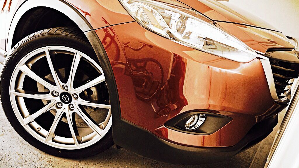

Was kinda freaking out since i was still rolling on my snow tires with the higher temps lately. So started seeing what was available locally at a good price to get my by for the summer. Ended up grabbing a set of 22x9.5 ET35 Forte F50's for a decent price.
Im not totally in love. But there not horrible. And the fitment is on point, and tire diameter is unchanged which is nice. If i end up keeping these, i will probably +size the tires to a 40 series sidewall next year instead of these 265/35's.

Not too shabby! I was gonna comment on the series, I think going up a tad would look better and probably feel better in the butt!
We still have our winters on too (it was supposed to snow 8-10" yesterday but missed us just south of the metro), I better get the summer setup on here pretty soon.
Yea, The speedo being off a few MPH will be worth it to have a slightly tall sidewall. And i have room to spare even inside the fender wells. But I might still just get the 20's i wanted next year, and just use these to get by.

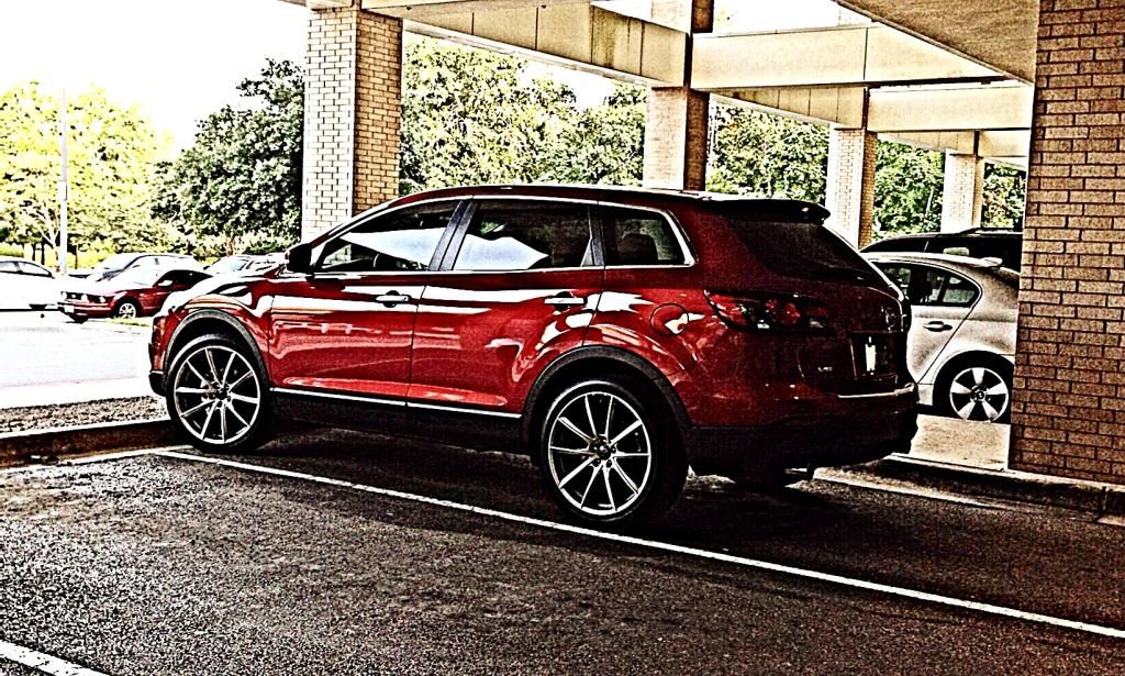

Not aware of this thread till now. Well, here's my 2013 CX-9 GT with the 22x9 35mm offset. Tire's are 265/40 R22s.
