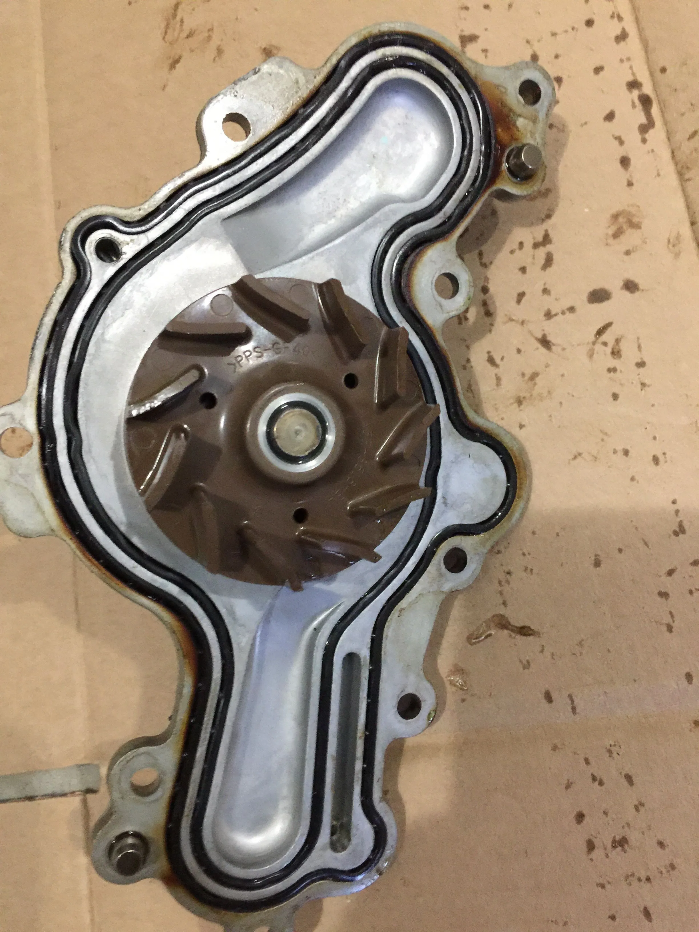

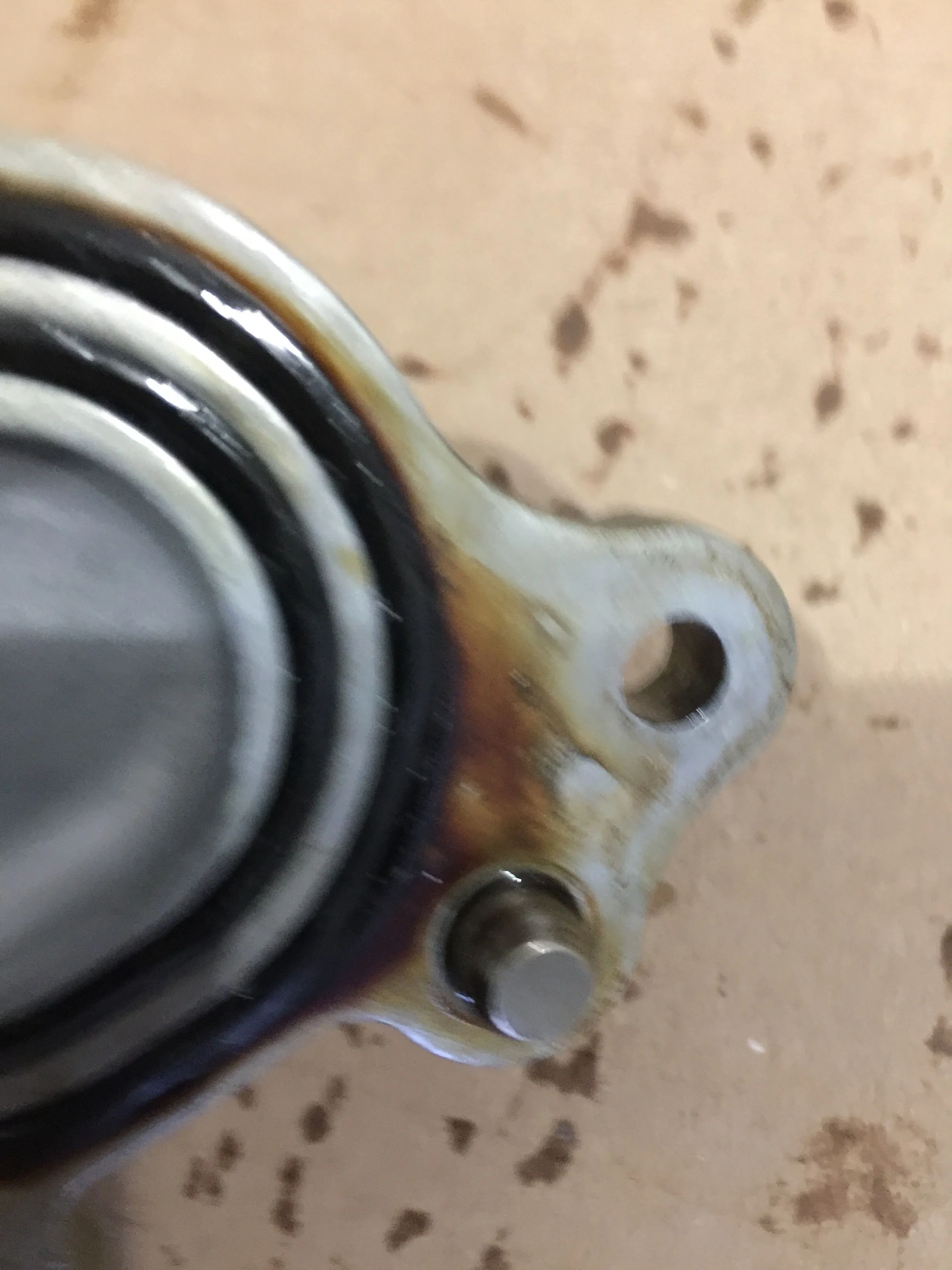

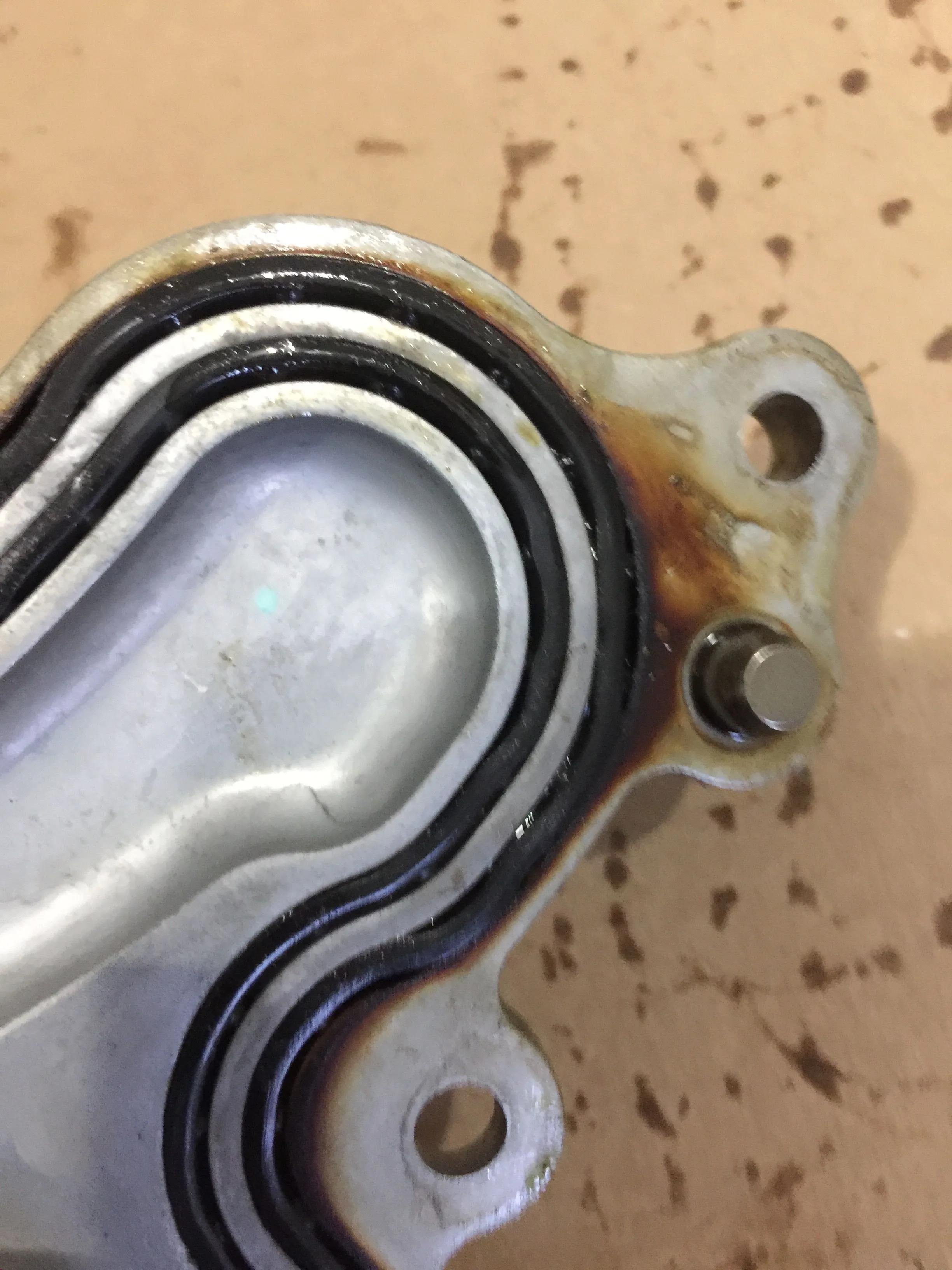

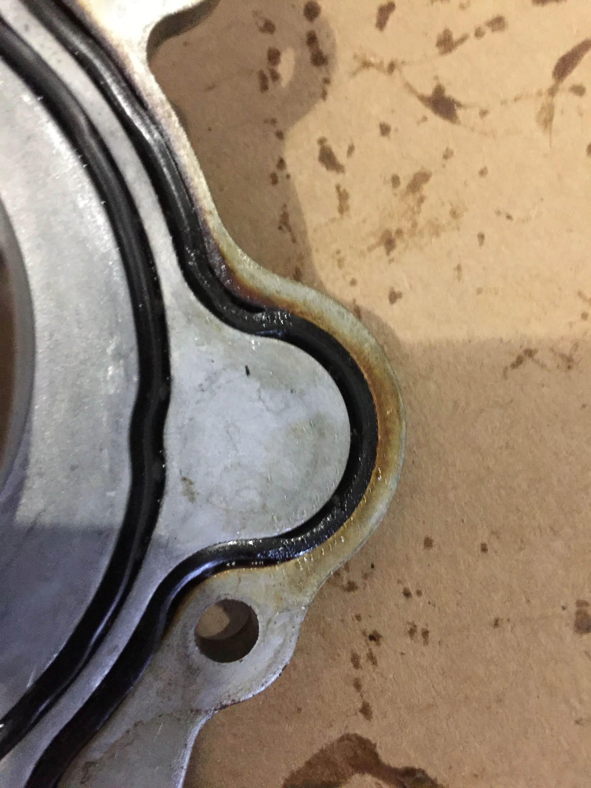

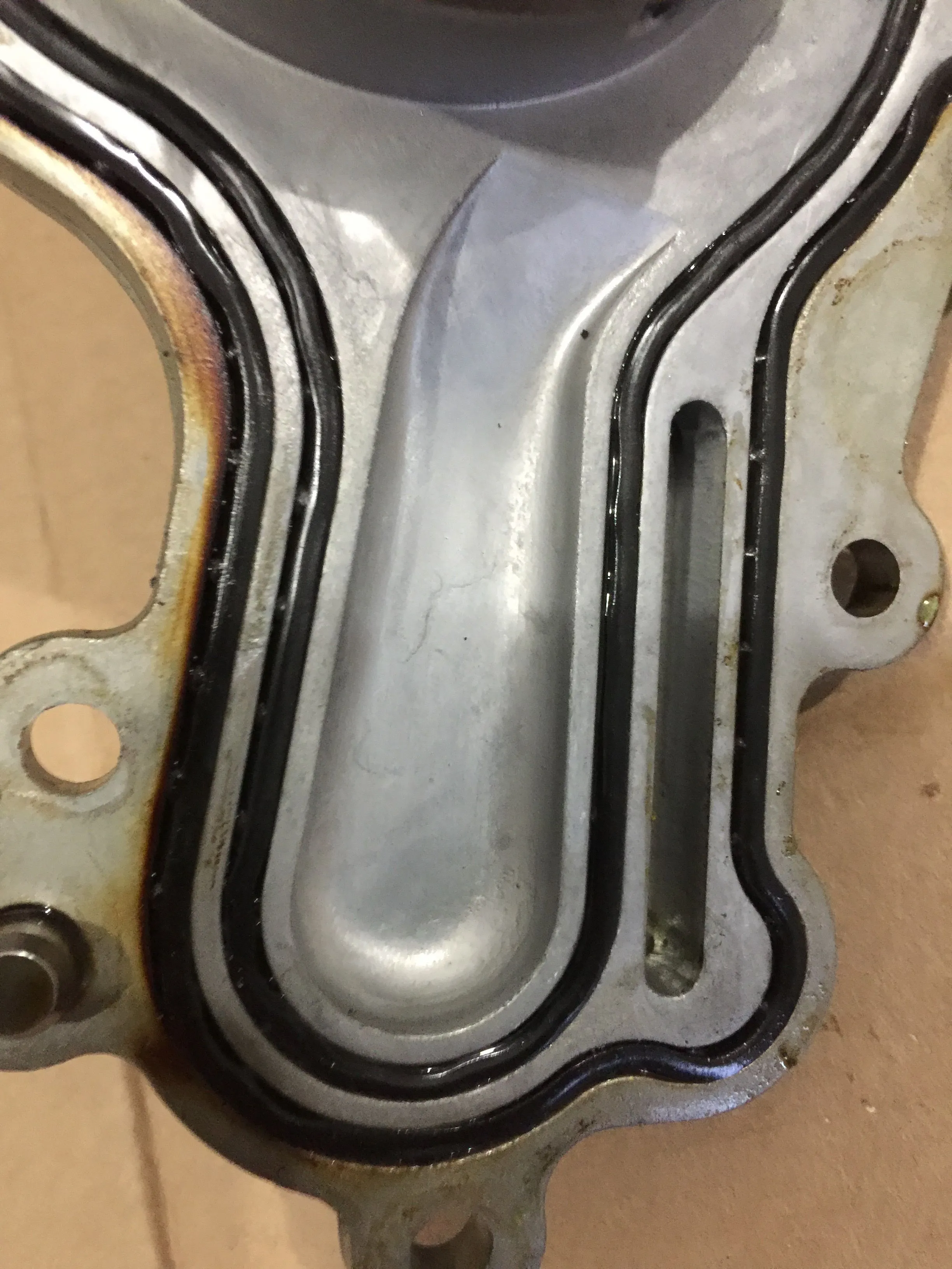

I'm attaching pictures of the water pump. It doesn't look too bad and certainly has not leaked in between the gaskets. There are a couple of rough places on the corner gaskets that look sketchy. When I spin the impeller, it spins fine with no looseness but had a bit of drag on it like the bearings where starting to wear.
If you are in this position of a vehicle over 100k, you probably would be fine going to 120k, but I wouldn't push it much further.
