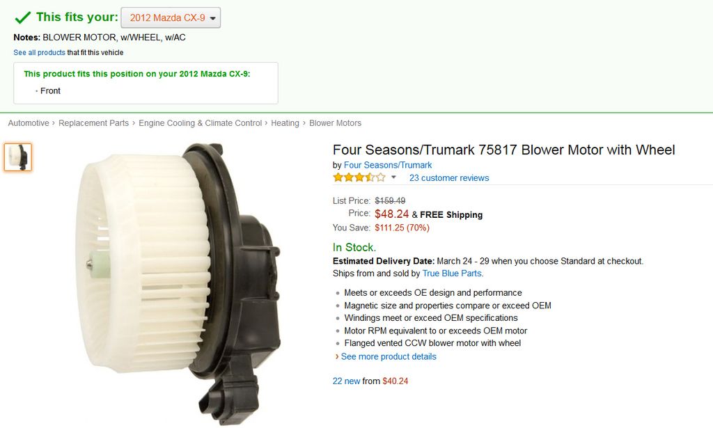

if it's not a clogged drain and you have a faulty blower motor, you can buy an plug and play aftermarket replacement
from Amazon for $48 and fix it yourself, it's really easy, the blower is easily accessible behind and below the glovebox
http://www.mazdas247.com/forum/showthread.php?123837138-2010-CX-9-cabin-air-blower-motor-options
https://www.amazon.com/dp/ (commissions earned)
