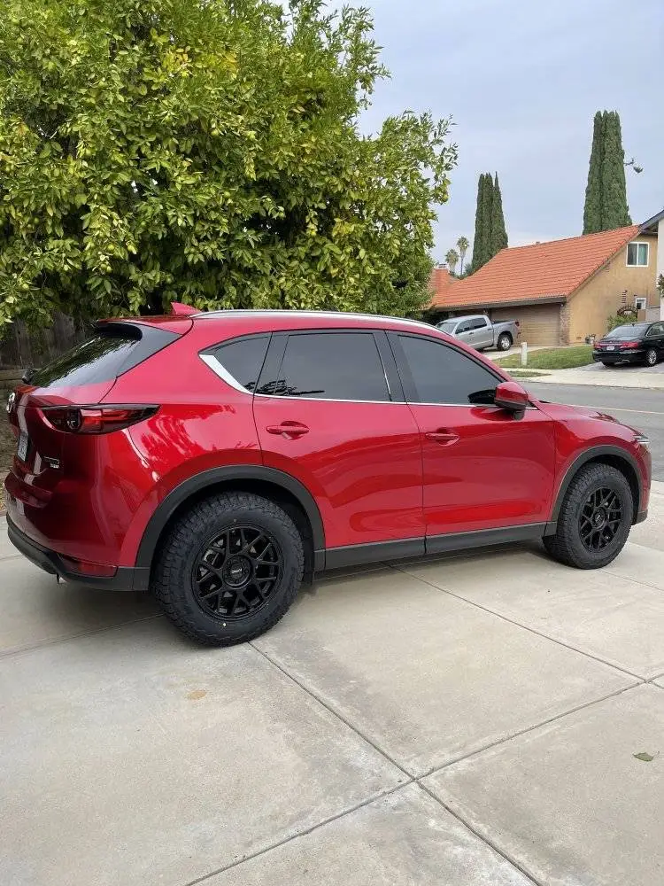

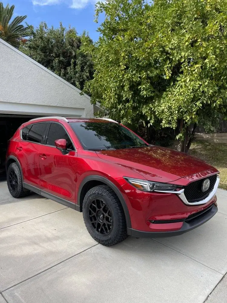

Just went 17s today from 20s. Love it
Looks great with the Falkens. Great choice. Black rims always look good on red or white.
I shoulda got the soul red...but gonna make the machine gray work.
For tire, narrowed my choices down to Falken trails or the Firestone destination at2s.
Falkens got the edge for cost, looks and doubled back sidewall. But the Firestones are lighter, and look potentially to have the best rolling resistance and least noise for a daily driver out of the whole class. Expensive though. It'll be a 50/50 tossup.

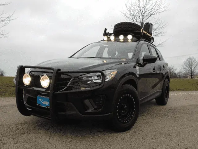

Here you go. I actually think this one looks good.
Yeah... Roof looks great...everything except the bullbars... too much weight . Wheels/tires would look great on soul red and white but not my machine grey. Really hard to find a rim that goes well with machine gray. Gonna spend winter months finding the right color to match or contrast in either a low cast or flow form/ rim roll type rims.
