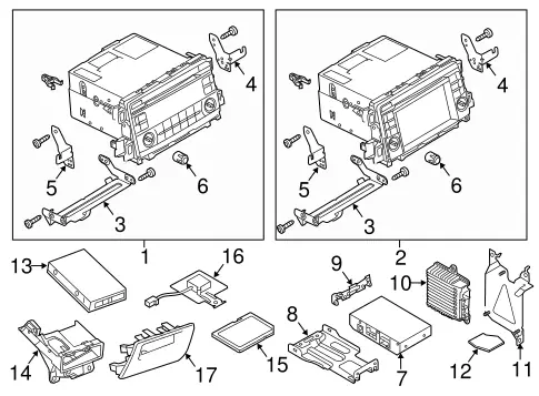

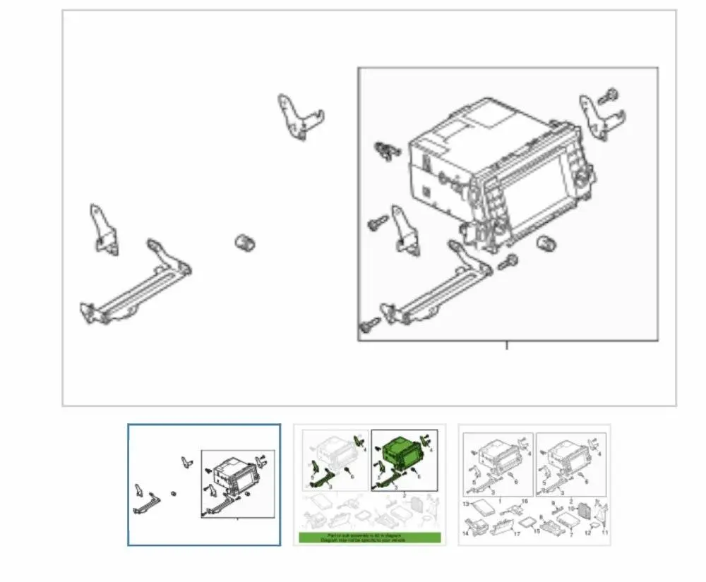

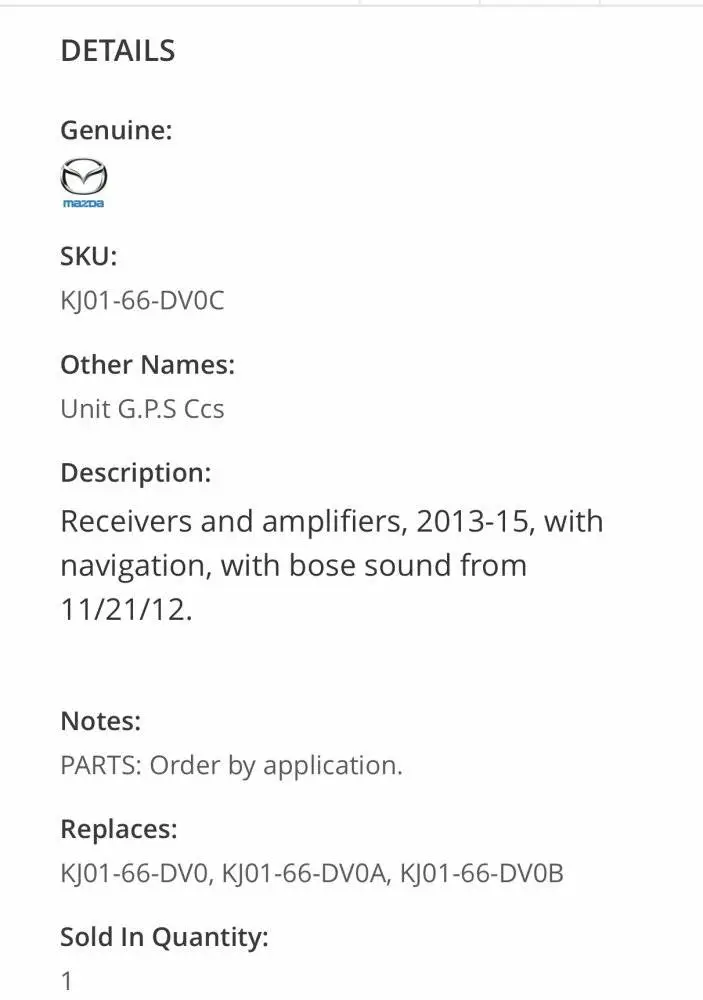

Unfortunately the video driver is within the audio unit with the screen. Looks like you have to get the entire unit, part no.: KJ01-66-DV0C, which will be very expensive. A used unit is a better option, unless you can find someone who can do component level repair.
