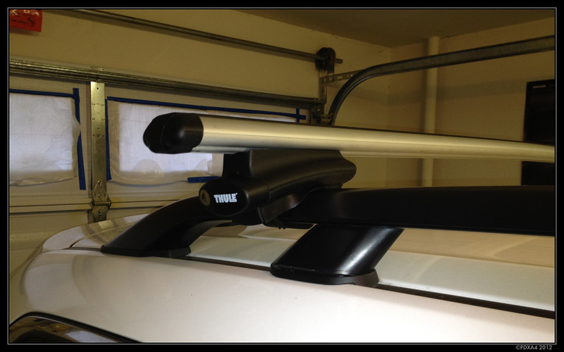

I have the newer Thule's, not sure of the number. They have a belted rubber strap that wraps under the factory rails and and then fits into a slot on the outside of the "foot". When you tighten it the strap pulls the rail slightly towards the center of the car. Where it became obvious was the middle foot on the factory rack. The plastic cover began to misalign with it's base. I may call Thule and complain, maybe they will do something for me. The OEM rack isn't all to blame but the flimsy nature of it doesn't help.

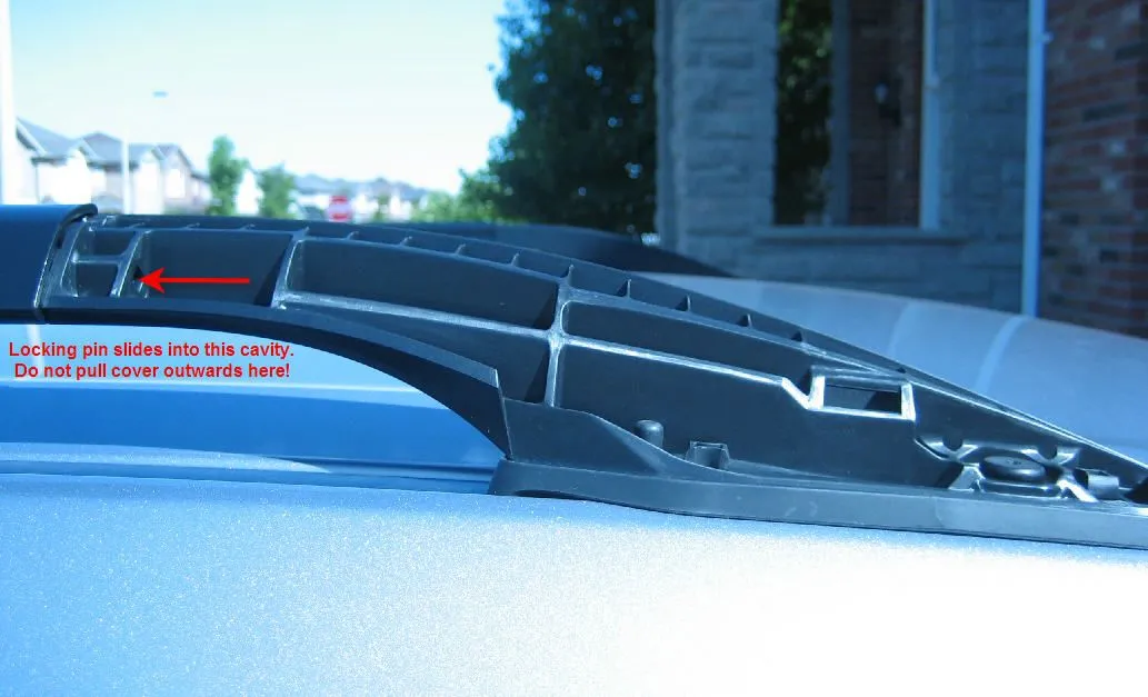

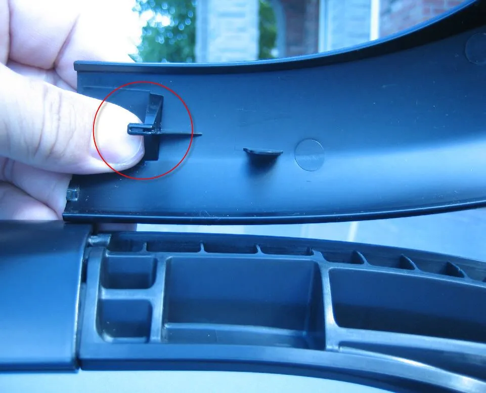

Before you get the plastic clips... Here are two pictures of the installation. Be careful with the removal of the front cover, there is a locking pin that can break off (circled with red) from the front cover. This is not shown in the Installation Instructions!
Good luck,
George

No picts here yet but I just put the rapid aeros and aeroblades on my 2012 Touring.
The ends of the factory rails have thin plastic covers and you need to completely avoid these areas if carrying heavy loads. The maximum spread left on the remaining bars is less that 37".

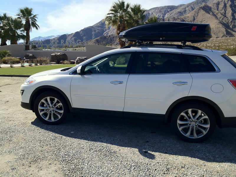

I mounted my 450's and had no issue with them on a long roadtrip with my Thule Atlantis 1600 box...
Car was rock solid on the trip...
No noise at 80mph...

However, I believe I have the same lateral pull from the 450 installation that has been mentioned here already. In fact my middle foot looks similar to pdx's photos (not saying he has pulling, just seems like it from that top pic). My middle foot's outside edge appears to be pulling away from the rubber boot but the other two feet are ok. Is it possible to over tighten the 450 straps? Is this something I should be concerned about? From the info here knowing the parts are plastic and held together by one screw has me a bit worried.
FYI I placed each 450 near the allen screws on the bottom of the factory rail.
