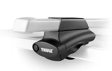

I just took my Thule cross bars off my factory rack for the winter. When I did so I noticed the factory rack was bending in towards the center of the car. Anyone here who thinks the factory rack is sturdy should actually see how it is mounted and what it is made of. The "feet" on the factory rack are plastic, no metal at all. I just took the whole factory rack off my car. I will not trust it to carry my bikes and I am looking for an alternative. Trying to find out more on the Thule Podiums.

I suppose you are implying I am arrogant. Maybe I just don't want to lose my bikes to a flimsy rack? Thanks for the unnecessary jab? The crossbars do lock the rails in place but when they are tightened there is a slight pull to the center of the car. So, after investigating I looked closer and removed the entire factory rack. While I have no doubt you've successfully used it as I have, the bottom line is it is not a robust, strong rack by any means.

I have the newer Thule's, not sure of the number. They have a belted rubber strap that wraps under the factory rails and and then fits into a slot on the outside of the "foot". When you tighten it the strap pulls the rail slightly towards the center of the car. Where it became obvious was the middle foot on the factory rack. The plastic cover began to misalign with it's base. I may call Thule and complain, maybe they will do something for me. The OEM rack isn't all to blame but the flimsy nature of it doesn't help.

If you look at your pic... the plastic cover over the middle foot actually got misaligned from the pull on the rail. I think I am going to go with a setup that actually bolts to the fixed points on the roof. Should be a bit stronger, less complex and lower the whole rack a little. If I do this I will post up some pics. Thanks.

Actually, it's exactly where it's supposed to be. You really want there to be something wrong with my setup, but there isn't.

I even looked at the aero version of the Thules you show, but they don't fit the rails very well and still pull laterally on them. They also cost about 3 times as much as the Mont Blancs. The MBs also come standard with locks that are harder to defeat.
I'm not saying there's anything wrong with yours, there is with mine. I'm just saying........if I am going to rethink this than I would rather completely replace the factory rack with a new one that mount directly to the fixed points on the roof.

Yeah I wasn't implying anything wrong with yours, it looks fine. I actually sent in some feedback to Thule and I will wait to see what they say.
