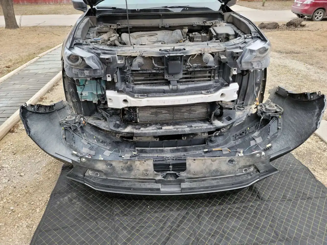

On Tuesday, I finally got around to pulling off the bumper for the JB4 install and the horn install. Not nearly as productive as I had hoped, since the JB4 threw codes that wouldn't clear, and I couldn't figure out how to remove the OEM horns, lol. I took the day off on Wednesday so that I could remove the JB4 and run errands with the wife and kids, then in the afternoon I took the bumper off again and connected the JB4, making sure all connections were secure. Still throwing codes, so I disconnected the JB4 again before putting the bumper back on. It's snowing now, so I'll have to wait for better weather to try again, but I don't even know if there's a point. I don't know if there's anything else I can do.
@jcrout7992 said he never had any issues with his install, so I don't know why it isn't working for me. As far as I can tell, all the connections are secure and push in as far as they will allow. I've sent emails to Burger and posted to the JB4tech forums, but no help there yet.
EDIT: Oh and also, I had to remove the tow hook license plate mount to remove the front bumper, and one of the screws broke clean off, so now I can't even put the front plate back on lol.
If anyone can help me figure this out, it would be greatly appreciated. As of right now, I'm leaning towards getting a refund on the $35 for the app, and then putting this JB4 up for sale at a massive loss.. :confused:

For future reference, on the 2016+ CX-9, the connectors are on the MAF sensor (on the intake), the TMAP sensor (on the side of the intercooler), and the MAP sensor (front of the engine, dead center). Pic below is the MAP sensor connection. I could not find a picture of this connection in my quick searches on the internet.
For connector removal, I would suggest using a pair of pliers in one hand to pinch the tab to release the clip, then using your other hand to work the connector loose. You also want to make sure the connectors are fully seated. You should be able to hear them clip in, but you can also take pics of each connector before you start so that you know how they should look when connected properly.
