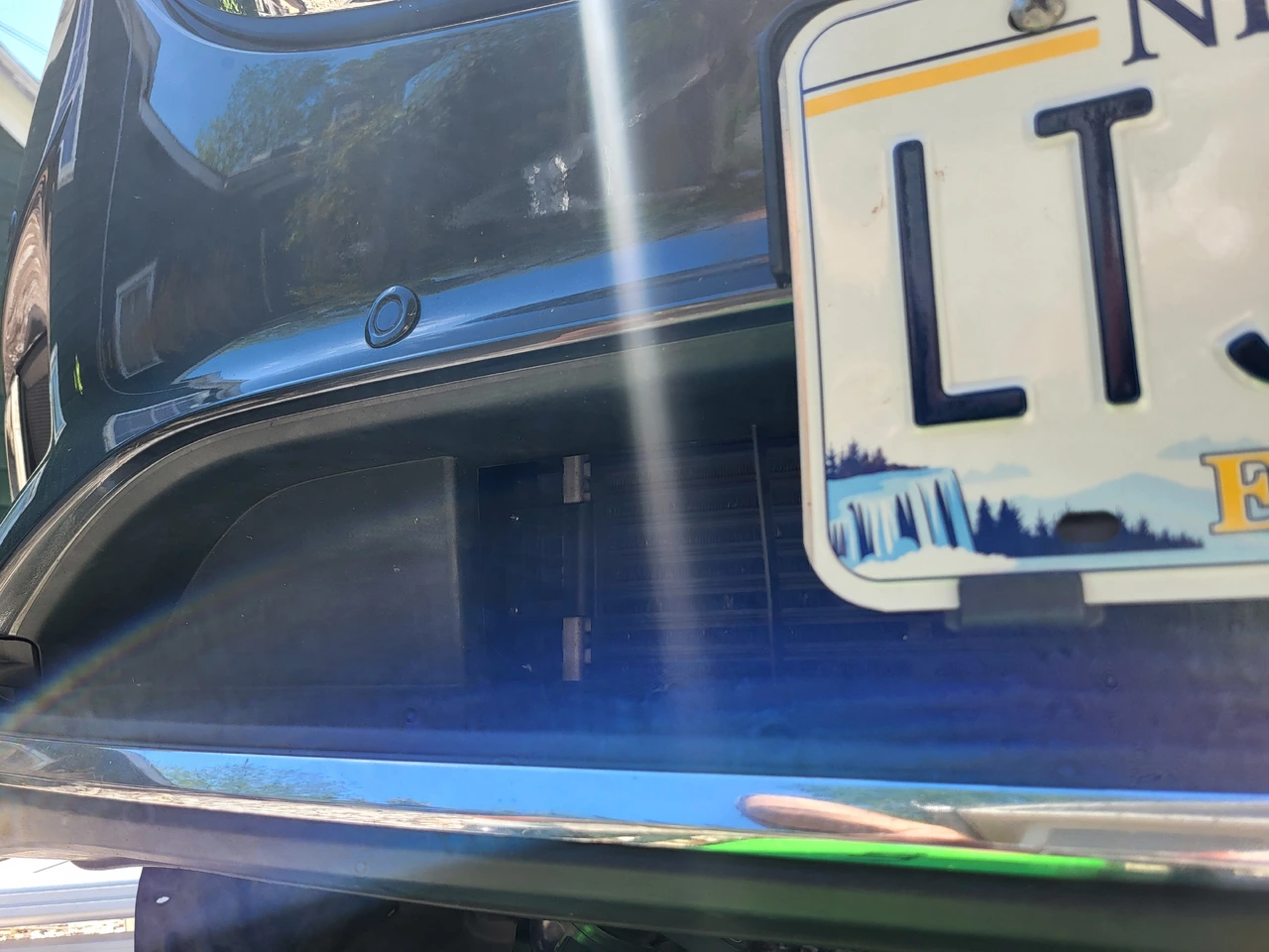

I installed mine in a 2020 a few weeks ago. Lots fun. I refused to remove the bumper for the connector down low. Easier to go through the passenger side lower grill aperture. Still a b****...
I tried to do it that way too at first. I probably spent an hour or two over two days trying to reach and unplug the connector. It ended up being a lot quicker for me to just pull the front bumper lol
