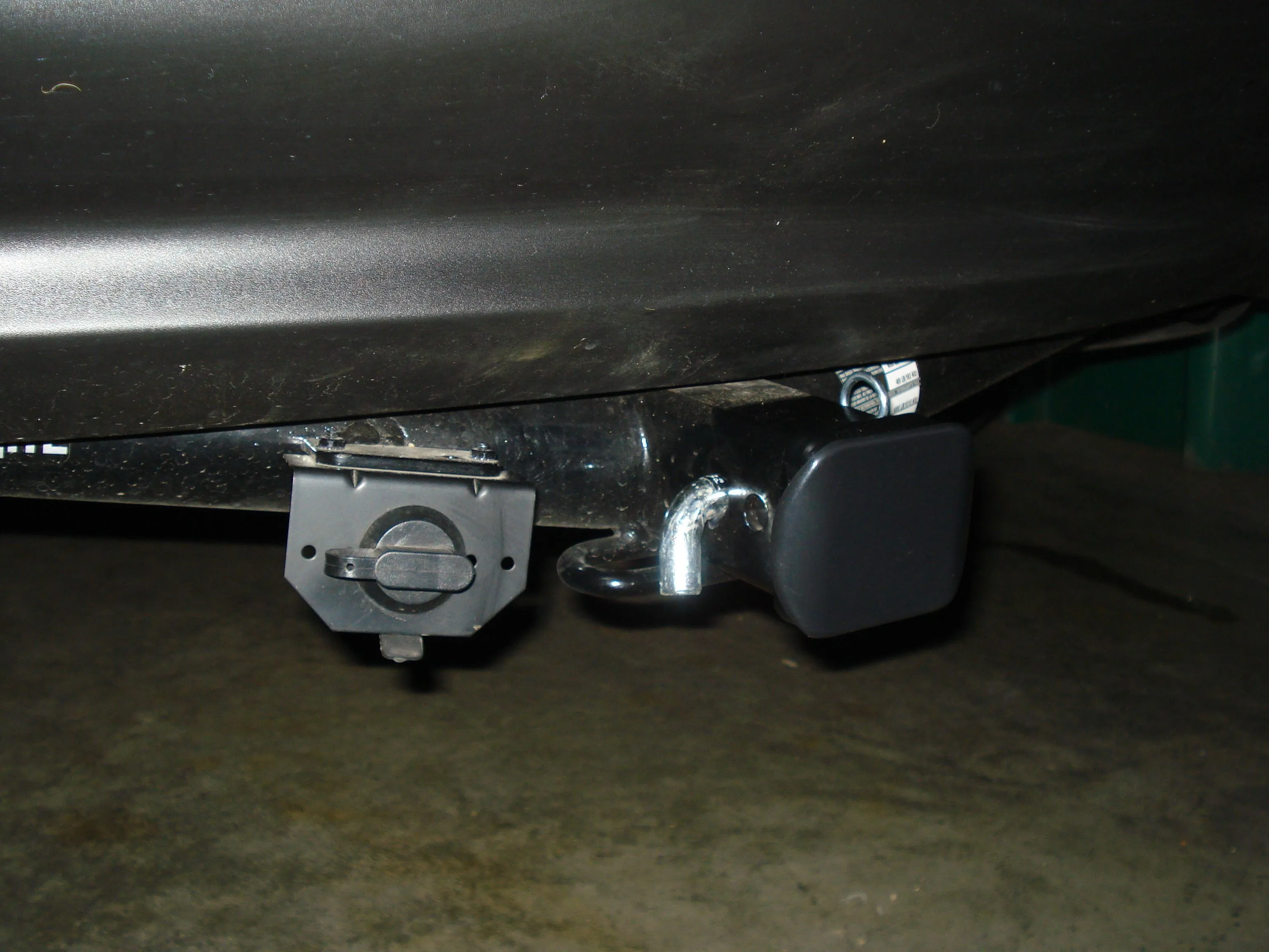

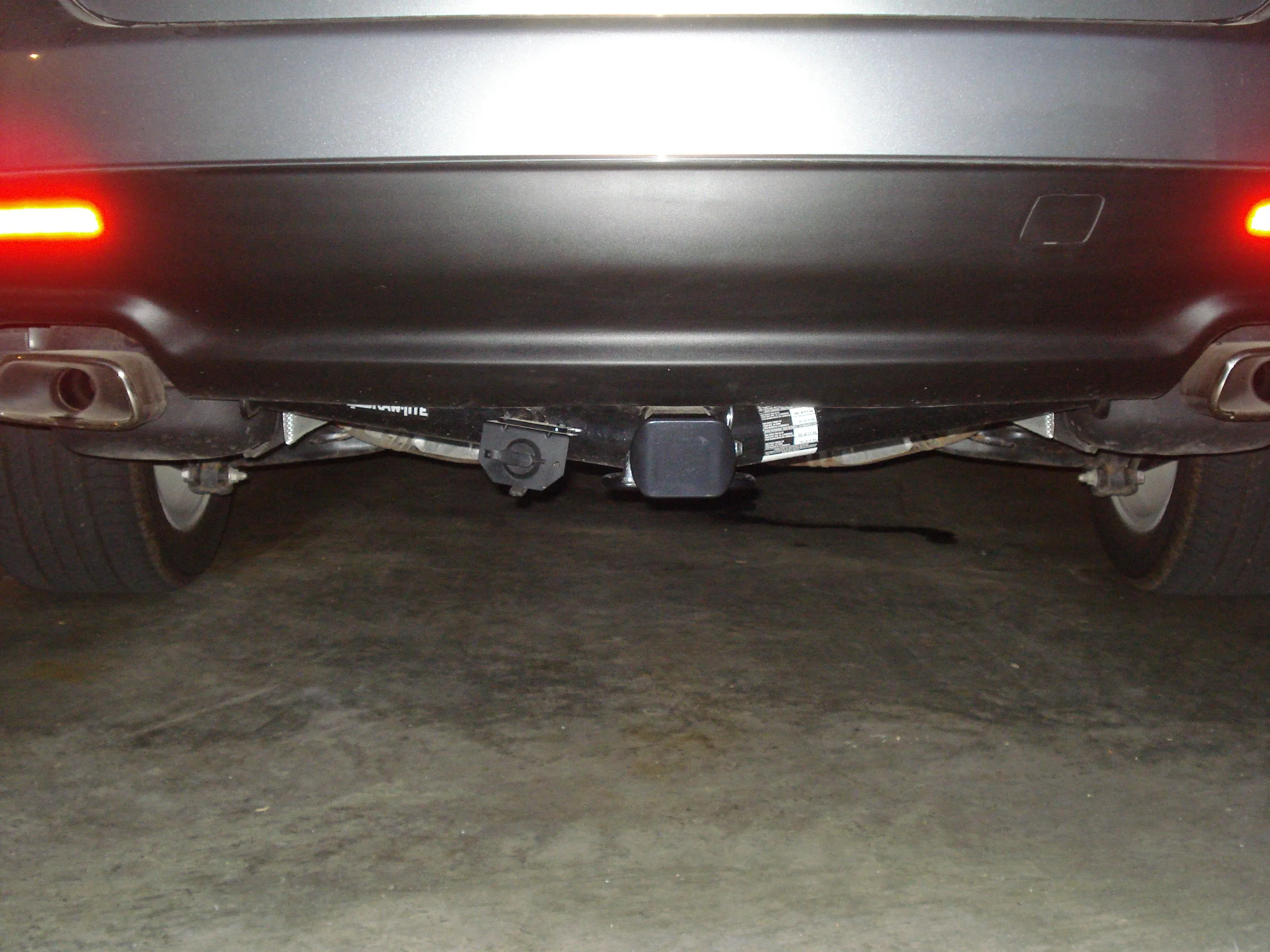

Draw Tite Install
I installed the Draw Tite hitch (same as the Hidden Hitch) and Mazda wiring harness a couple of weeks ago on my 2011 CX-9 Grand Touring without much drama. As others have already noted, the following will make it go easier.
- have someone help you lift it and hold it while you thread the bolts . I did on my own but it definately would have been easier with help
- you need to alternate sides when tightening the bolts. There was about a 1/4" gap on each side that you need to "stretch" the hitch to fit tight against the frame and if you do one side first it won't work
- remove the spare tire
- I needed to use a wrench on two of the bolts becasue of interference from the spare tire winch box. Only after they were almost all the way in I was able to fit my torque ratchet and socket in the space
- you do not need to remove any side panels or the sub woofer - the other trim comes on easily and I didn't break any fasteners even after doing it a couple of times
- the plug for the harness is on the passenger side, but you need to thread it over the the drivers side to get to the grommet hole to feed it outside the vehicle
- I purchased a metal holder and 4 pin plug to make the install look a little cleaner versus just wrapping the wires around the hitch

The unit I installed called for a 7.5A fused line to the battery. I did nothing of the sort and instead tapped the 12V power outlet on the pass side compartment. For piece of mind I did install the provided 7.5A fuse after the tap to properly protect the trailer wiring circuitry. Should work fine.
I installed the Curt wiring harness (made specifically for the Mazda) and tapped the 12v power outlet as well. Although my kit came with a 10amp fuse vs the 7.5amp that yours came with. Should I switch mine out to a 7.5amp fuse? It is working fine so far with the 10 amp but have only driven it around town for 20 minutes with the trailer hooked up.

Do you have an AWD or FWD GT? Tow Prep is included on AWD and optional on FWD. If you have Tow Prep then you have the connector for the Towing Harness. It's in the back under the storage box. All you need then is the Mazda Tow Harness Part # 0000-8E-N13A.

Thanks for posting your pictures and experience, saved me a bunch of time I'm sure. I installed the draw-tite hitch with OEM wiring without any problems. I wish I would have run the wiring before bolting the hitch in place though, as it was tougher to get to external wiring. I didn't find it necessary to remove the threshold plate and I ended up installing the module under the jack like you did. It was a very simple install overall. I wedged the plug between the bumper and hitch and then used one of the supplied zip ties to hold the plug to the small metal platform on the hitch, the zip tied fits nicely in the "channel" of the OEM trailer plug. I probably won't be pulling a trailer very often, but it's nice having it available when needed, the hitch will get used more for transporting our bikes around. I paid $150 for the Draw-Tite hitch and $60 for the OEM Mazda trailer harness.
