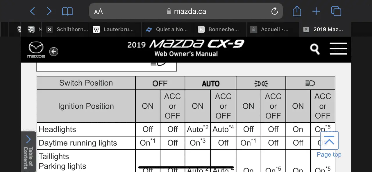

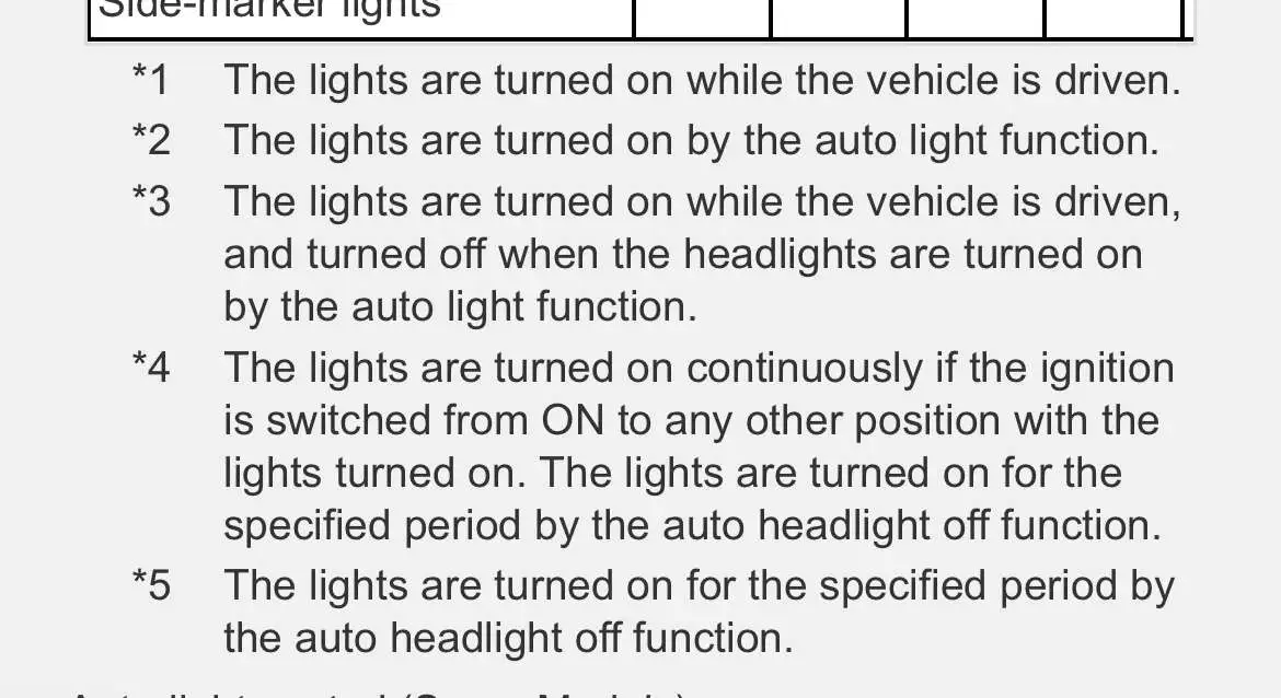

Have you confirmed it while driving (like by having someone else see you drive by)? If i recall correctly the DRL don’t turn on until a certain speed is reached (3mph or something like that).
Here is what the manual says. Based on the little *3 notes, it looks like the DRL are turned off when headlights are on in auto mode, but would be on in manual mode.
