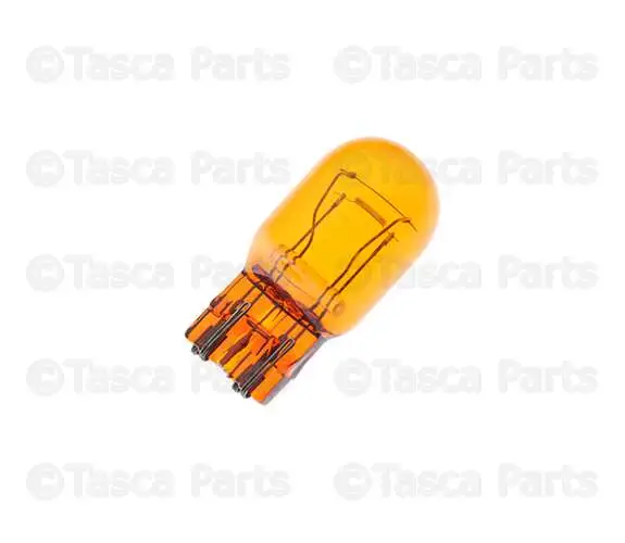

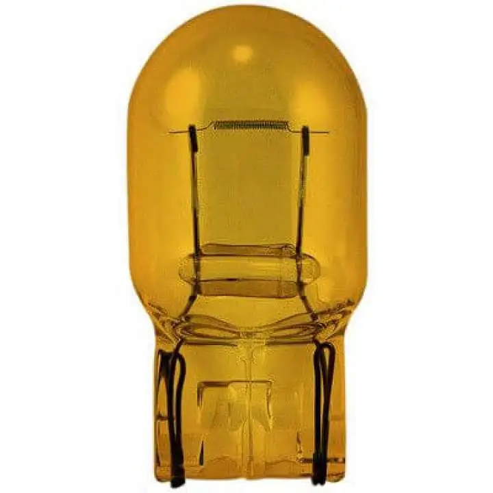

I think the original might be dual filament lightbulb since they are doing two functions (low voltage parking and brighter signal light) and also because only one of the 2 functions went out (parking light). But I wasn’t able to confirm from internet searches. Images from the part number shows the dual filament one like a 7443 but aftermarket sites say a 7440 is needed (7440 is a single filament i believe). The aftermarket sites might be wrong. Sometime there is confusion between these bulbs since they look identical from the outside and have the same plug. And as i said i can’t confirm from my car either.
If you still have the original try to see if they are dual filament or not (if they are burnt the filament may be broken, but you would still see it), Or you can ask your local dealer service department to confirm. And compare with the ones you have installed (Photo of a dual filament bulb and a single filament below)
Yes you are correct they are dual filament and the ones I took out were fine, both filaments were intact . I’m completely out of ideas I may just have to eat the cost of taking it to the dealer
