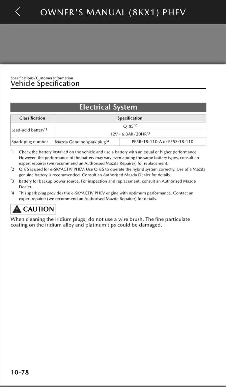

To be honest I’ve no idea what that spec means.
It states 6.3Ah/20HR. If HR stands for Hours (which it shouldn’t since the h stands for hours) and it should read as 6.3A for 20h that would indicate a capacity of 126Ah.
Looking up a Q85 battery results in 65 Ah spec.
I’m baffled Mazda quoted what they did.
Anyway, it’s with the dealer so let’s see if they can fix it.
I think there is a slight misunderstanding about the two 12 volt batteries in the CX-60.
The page from the owners manual that @SteveMilner posted , shows correctly that for the main 12 volt battery it's a Q-85
The line below that refers to the 12 volt backup battery that's located inside the cabin I believe, if you read the text marked with *3
I’ll bow to your superior knowledge. Thanks for helping clear this up.
It’s not entirely clear though.
