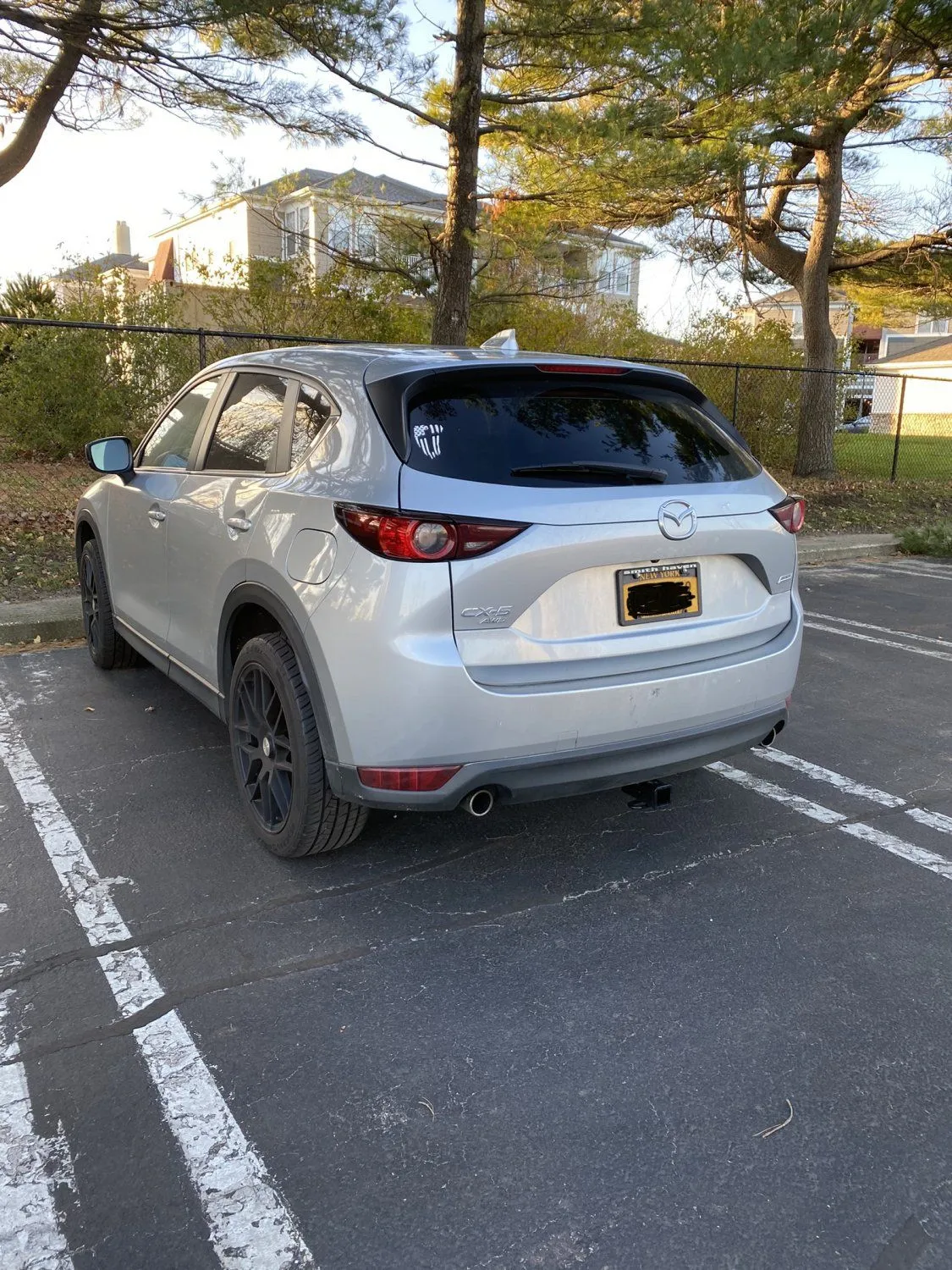

Just got the hitch installed at u-haul and extremely pleased! Thanks everyone for the suggestions.
Looks good.
