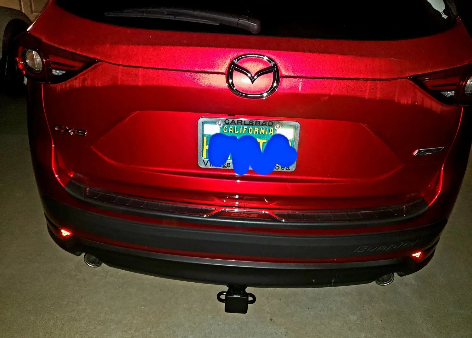

Appreciate it, I’ve been looking into this option today. Can you post a pic? I wanted to see how the cut on the bumper looks
That's why I chose the Curt, no cut! This picture is a bit distorted but the hitch is actually even with the bumper, it doesn't stick out at all.

That's why I chose the Curt, no cut! This picture is a bit distorted but the hitch is actually even with the bumper, it doesn't stick out at all.View attachment 229112
Looks awesome!! Thanks for posting. I definitely think my best option here is to go get this done at a local u-haul

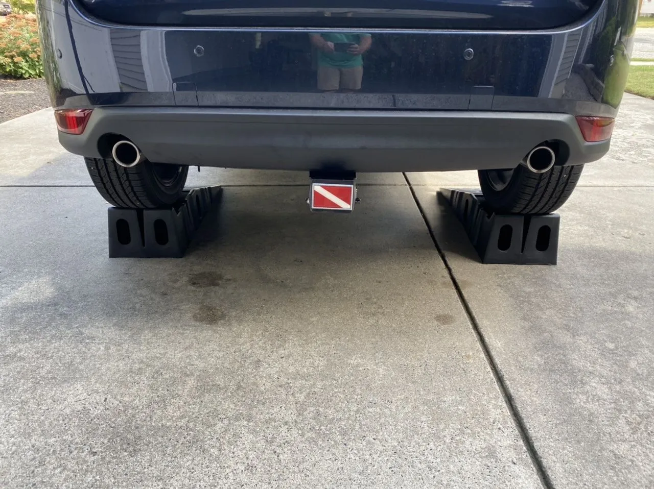

It’s also not hard to do it yourself. I did my CX-5 and my wife’s CX-9 both in under an hour.
I backed up onto some rhino ramps and used a Coleman 72 can cooler with wheels to rest the hitch on. Perfect height! Fish bolts and washer through channel, easy stuff.

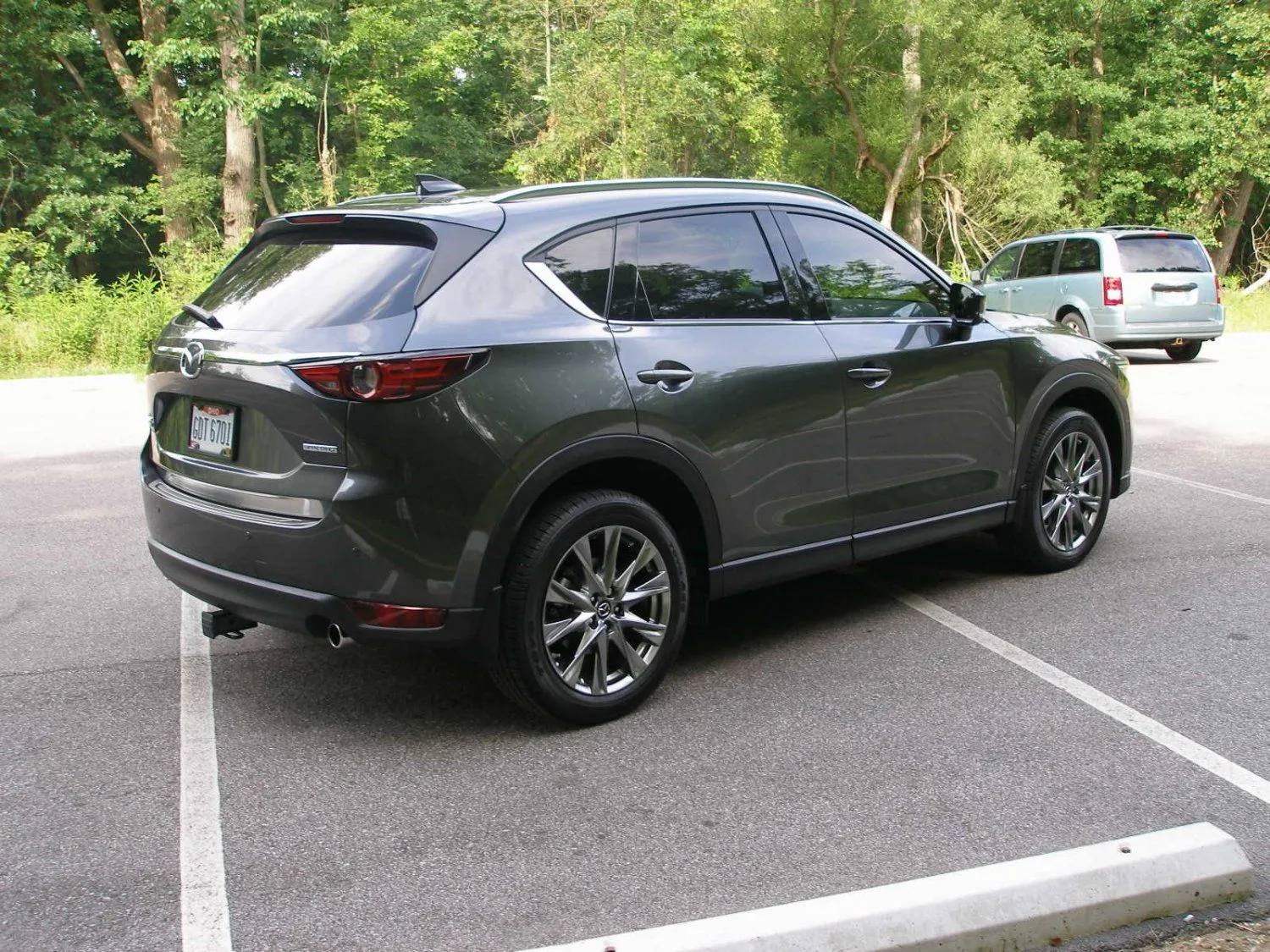

I installed the Curt on my 2016 and on my 2020. It does a great job and fits very well.
