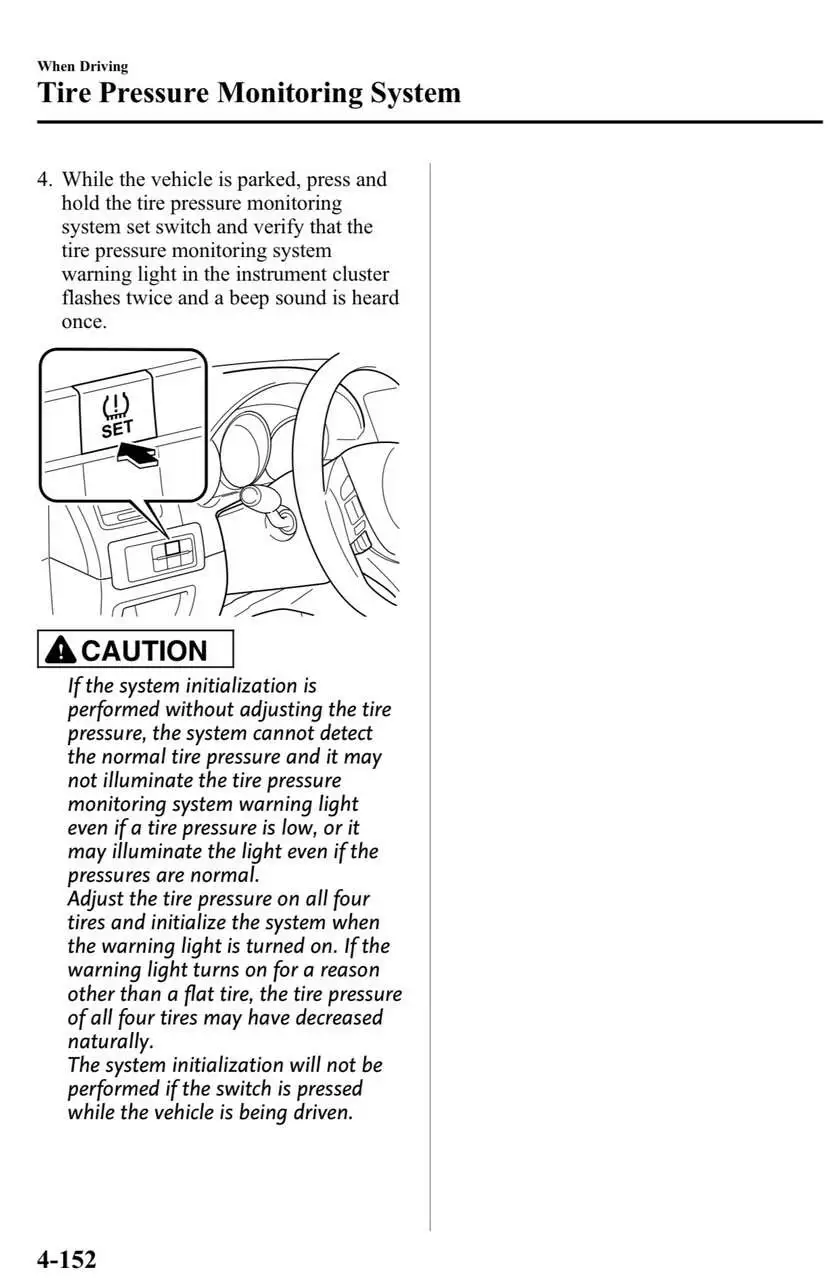

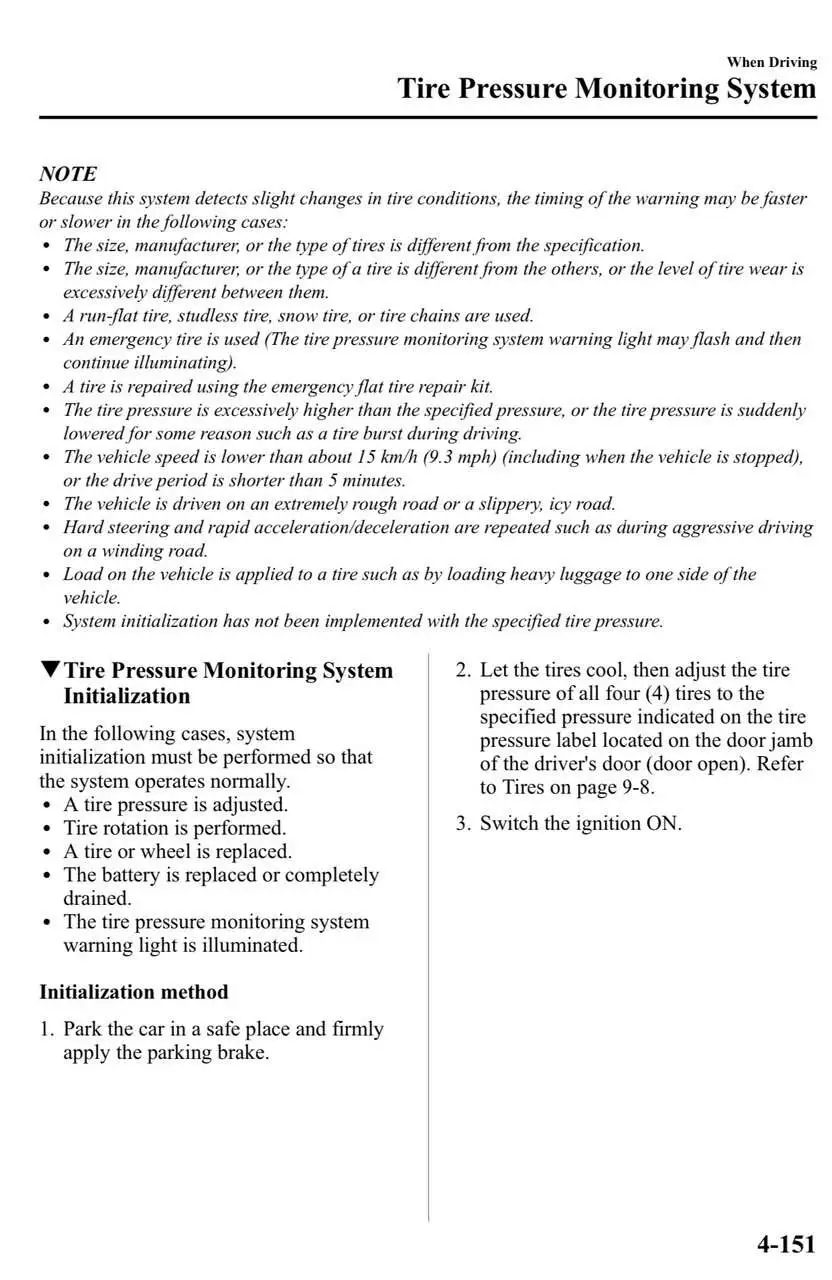

Try a reset again with engine off but in run mode (two presses of the start button no foot on brake) and parking brake on. Push and hold TPMS reset until it flashes twice then a beep. (I don't think the manual requires the e-brake on, I just always have)

Read the “CAUTION” note:
