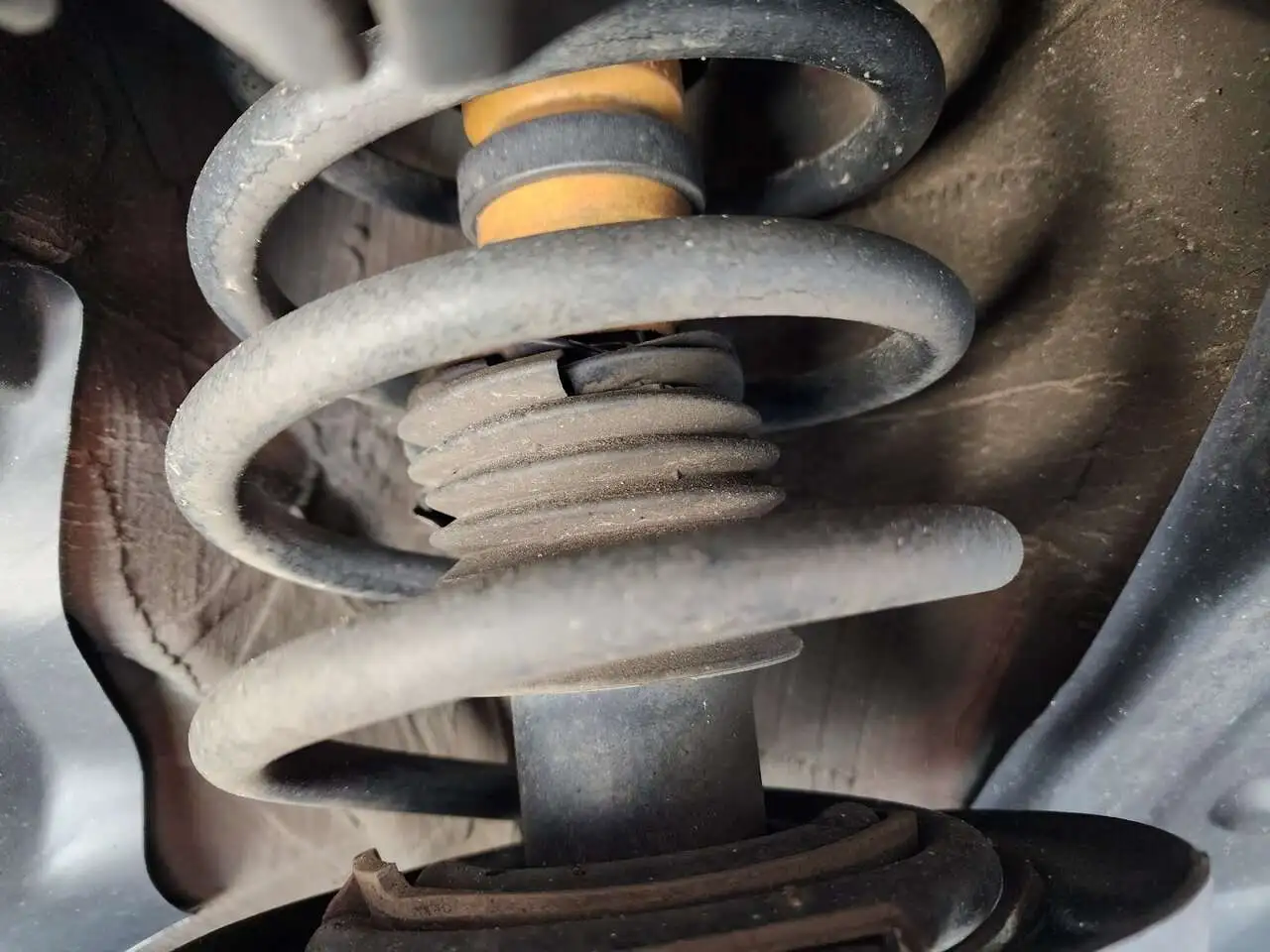

Think it might be the front passenger strut.
Looked at it a little closer and not seeing anything leaking, so maybe just torn boot.

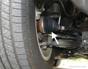

Hah! I replied to this yesterday, but apparently didn't press the 'Post' button. Maybe a little late now...
Sounds like a CV joint on one of the driveshafts has failed. Turn your wheels all the way to the right & left and look both sides to see if the one/both rubber bellows has/have split. See pic - not a Mazda, but should look similar:

Honestly I didn't visually see anything leaking from the struts, and only saw the torn boot on the passenger side.
The mechanic that looked at it said it was "binding up" but I am not really sure what he means by that.
