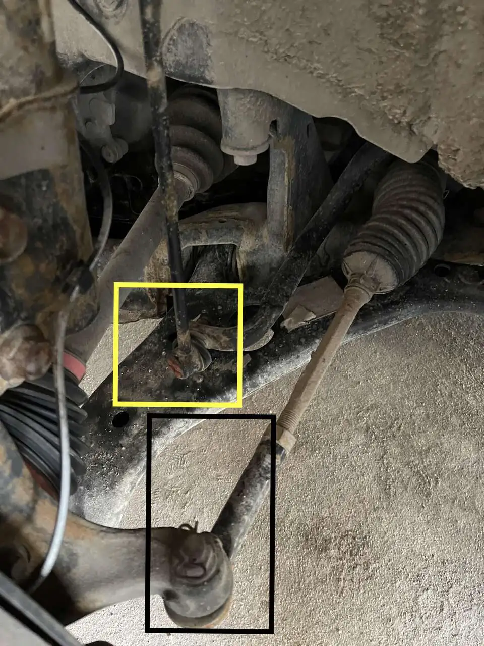

Hi,
I was checking my suspension to find issues and it seems I can hear a metal noise on the tie rod on the black square in the picture. I also notice that I can move the yellow part with my hand. Is that normal that i can move it? If not, might as well replace it?
Any other recommendations on what to check? I already replaced my control arm recently.
That's a sway bar link. The ball joint(s) SHOULD be movebale left-to-right by hand, but there shouldn't be noticeable play if you force the sway bar itsef up or down with a pry bar. They are very quick swap, and there are cheap, decent aftermarket sources. See RockAuto.

Hi,
I recently replaced my end links at 57,000 miles. The nuts take a 14mm socket. I used needle nose vise grips to grip the ball (remove the rubber boot or pop off the end to completely expose the ball to grip it) otherwise the ball and stud will turn when trying to loosen the nut. The top nuts face outward and are easy to access the nut. I held the ball and used an impact driver to zip the nut off. The bottom nuts face inward and I accessed them as shown in the attached video. There are other youtube videos on this as well.
Naturally the rod should be able to be rotated left and right about the vertical axis but there should be zero play in the ball and socket. Mine was able to be pushed in and out of the socket and the boot was torn and leaked greased. And it was the source of a constant clunking over even small bumps. Only one out of the 4 joints was bad (lower right) but I changed both links.
