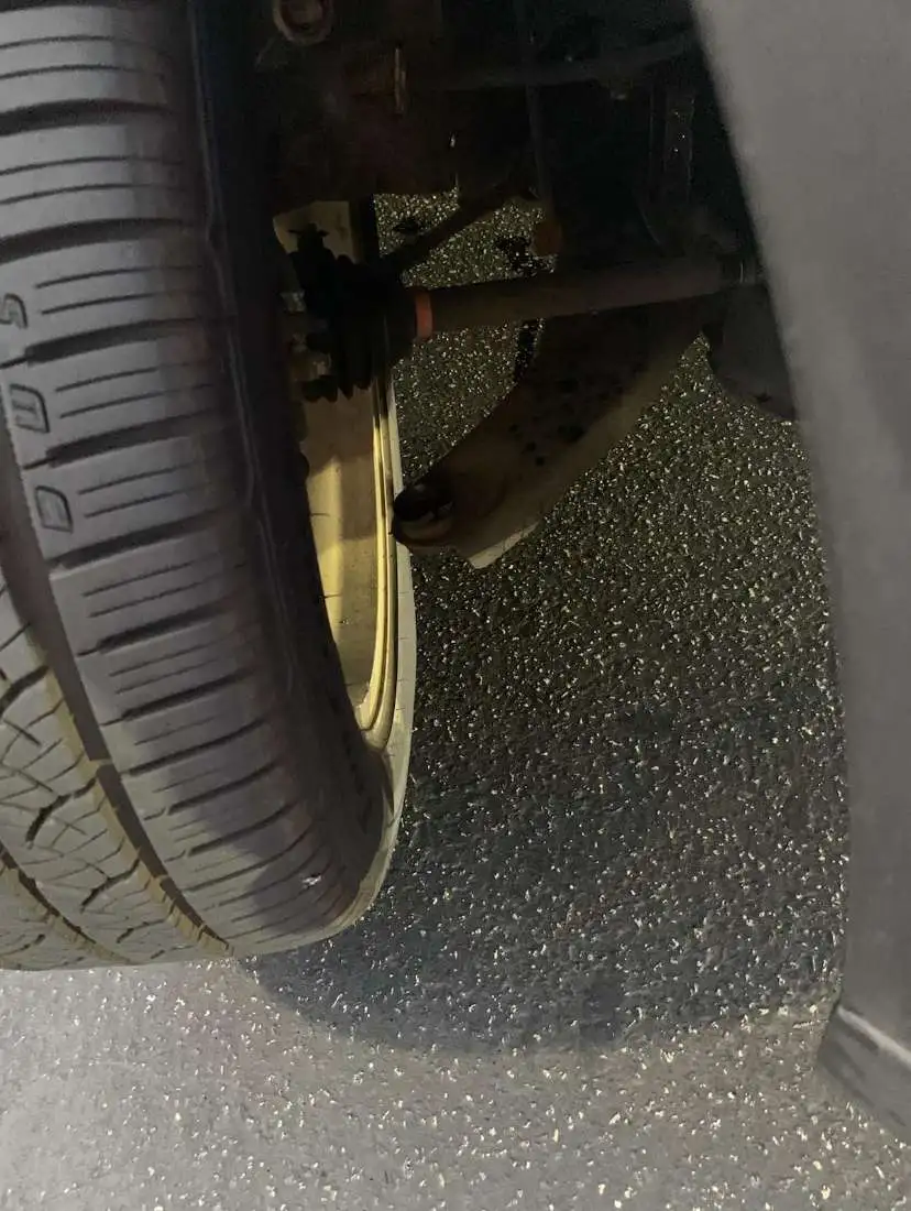

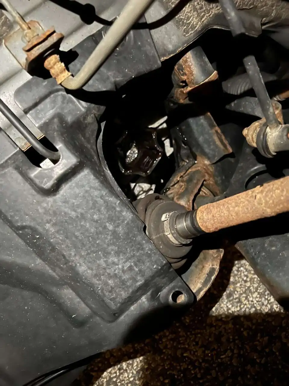

CX-5 Suspension control arm failure
Hi, I was recently travelling in a Mazda CX-5 2013, which has done 73K miles, when the suspension control arm suddenly detached, causing the steering to be lost and the wheel to cave in. The car has been regularly serviced, MOTd, and has had no accidents. Furthermore, it has not been driven on rough terrain.
The incident happened after travelling around 170 miles and there had been no signs of any suspension issues leading up to the incident. Thankfully the problem happened as the car was entering a car park. Had it occurred at speed, the consequences would most likely have caused fatalities.
Has anyone experienced anything similar or has suggestions to make? I'm still reeling from the trauma!
Thanks!

If i had to take a guess, some nasty mechanic loosened the bolts under your car expecting you to come back a few days later so they can fix it and charge you. I have seen mechanics at Canadian Tire and GM dealerships here in Halton do crap like that! Get every bolt and nut checked under car to ensure they are tight. The dealership are PAID by car companies to check all nut and bolts under car on first oil change to see if loose. Do they do it, i bet not. But i think u have been had! Tell Transportation Safety Board and Mazda. Take photos and document. Send by registered letter. In the uk, mechanics are just as crocked! I had equally bad experience in Uk and Canada and USA!
Upvote 0
THIS ABOVE!
A control arm doesnt just fall off @ 73 k miles.
Was there previous work done on the car?ball joints or CV joints replaced, etc?
Either
1.)balljoint/cv joints failure( unusual at 73k)
2.)Someone forgot a clip or nut or didnt tighten something correctly...
3.)worst case scenario would be someone loosened nuts which is criminal.
Where was last place you took the car for auto work? Did they work near that area?
If it was a joints failure, unusual but those do happens. Just bad luck.
However, if it was loose nut/bolts then it seems high probablity that someone didnt tighten nuts correctly torque or worse loosened them.
Good luck with everything.

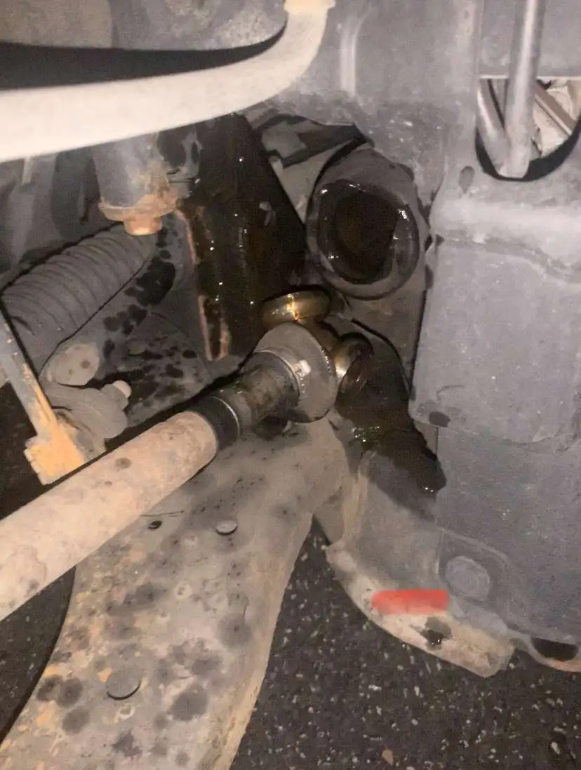

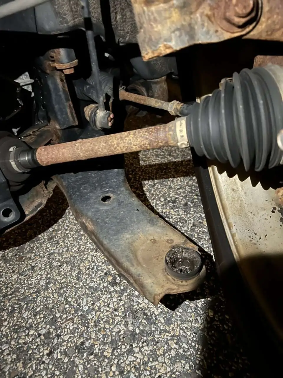

Hi to all , 2013 cx5 with 119.00 miles
Same failure to me , but also pull the drive shaft..
Fortunately it was during a turn with very low speed..
What to say…
What to say…
While i've had ball-joints last longer, 119,000 miles is about an average lifespan.
Whats suprising is that you didnt hear or feel anything going wrong.
Usually these things just don't come apart without warning and you have a few /several weeks to fix. From the posts on this board, it sounds as if these failure just happen suddenly without any warning on mazda vehicles.
Upvote 1

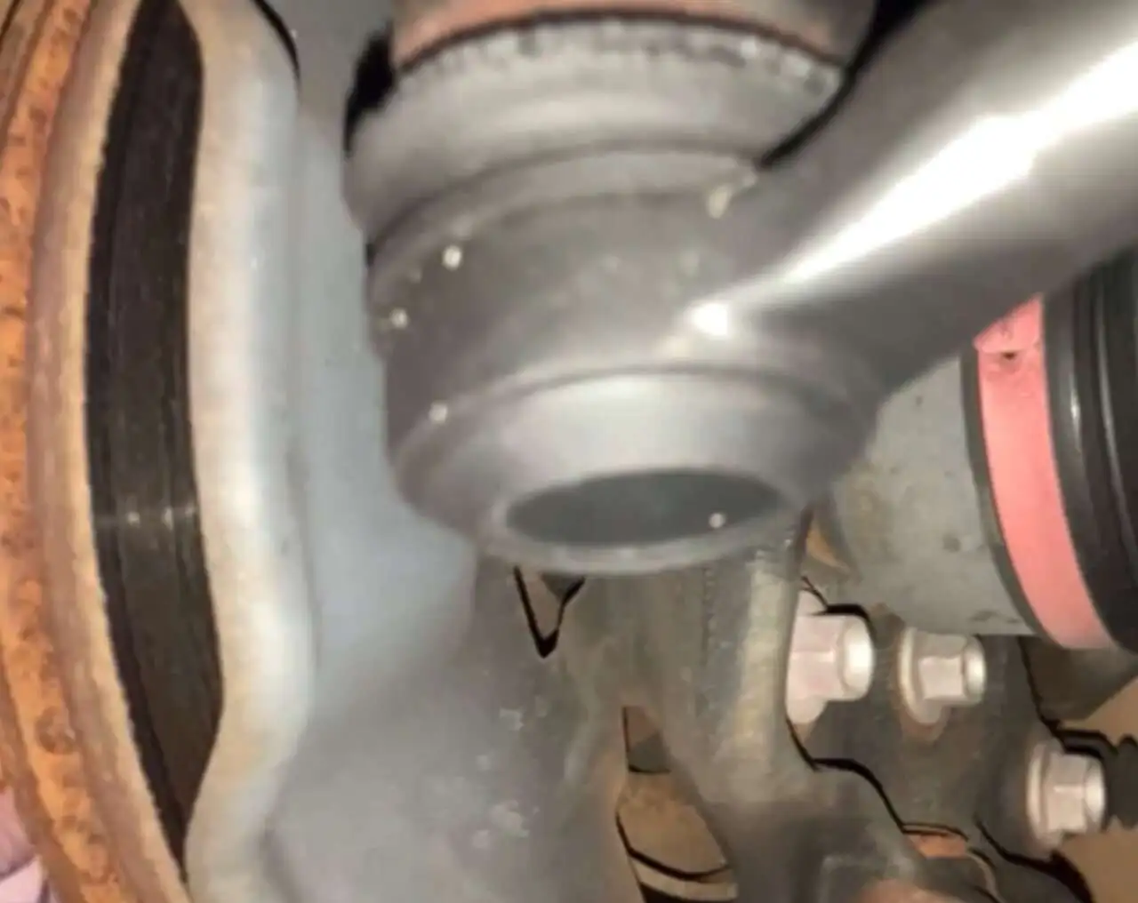

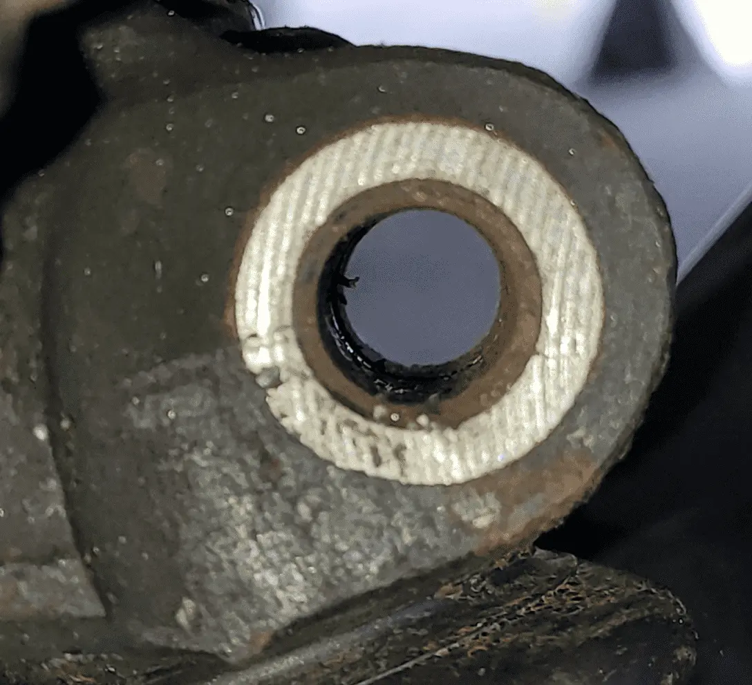

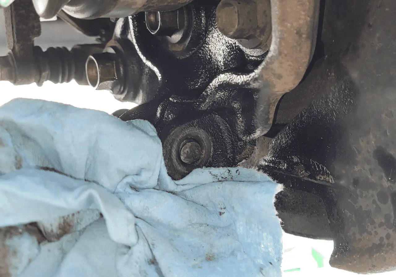

Last night my daughter pulled out of a parking space in our 2014 CX-5 and her wheel just separated from the car. It has 75K miles on it and we bought it as a Mazda certified car in 2019. The mechanic told me that the lower control arm failed, causing the axle to break. When I looked inside I saw that the ball joint was detached. When the tow truck driver came out, he knew exactly what it was and told me that he has seen this many times on Hondas and a number of times on Mazdas. At the shop, a number of the technicians were shocked at what they saw. They kept telling me how lucky we were.
Has there been a recall on this? I didn’t see one for the year 2014, yet I see this topic is repeated. I am shook because this could have been fatal if it was at high speed. My last 3 cars have all been Toyotas that were safety/reliability dreams well past 150K miles. My previous 2 Mazdas were leases, so I haven’t tested their reliability and I am concerned. The car has mainly been driven 8K miles per year within my MA town, with a few 200 mile road trips. It was last serviced 3 months ago for an oil change and tire rotation, not done at the dealer, but by an ASE certified mechanic.
I’m looking for feedback on this more unusual repair. I took it to a very reputable shop, but am also wondering if I should have gone to Mazda. I chose the closer shop because it took 3 different tow trucks to be able to load it on the flatbed without creating further damage and I wanted to minimize the travel distance. I also knew I wanted both sides repaired, out of caution, and was concerned about the price differential at the dealer.
The photos are not the best, but I can go back and take more as the parts will take a week or more.

A similar thing happened to my 2014 CX-5, 75K miles. Pulling out of a parking space and the front drivers side wheel detached-separated at the ball joint, broken axle, and need to replace the control arm. I posted details and photos on a more recent thread, but just wanted to share.
Upvote 0
From the photo, looks like the ball shell split apart. Not a ball stud or fastener failure. The other half of the ball joint isn't in the photo to tell if the the boot split, possibly letting water/dirt/salt into the joint and the grinding the ball socket until the shell got too thin to withstand the force. Or if the shell crimp was faulty/weak. Certainly something to have inspected regularly, starting at 60k miles or so, I'd think.
Upvote 0
I agree, it would be nice to see the rest of the ball joint to get a better idea. And your comment about 60k miles warranting an inspection is a good one. In fact, maybe a bit sooner.

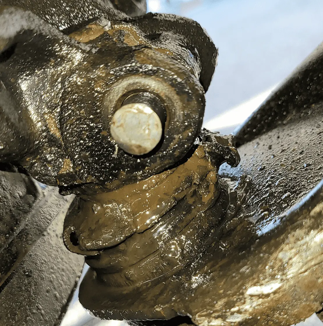

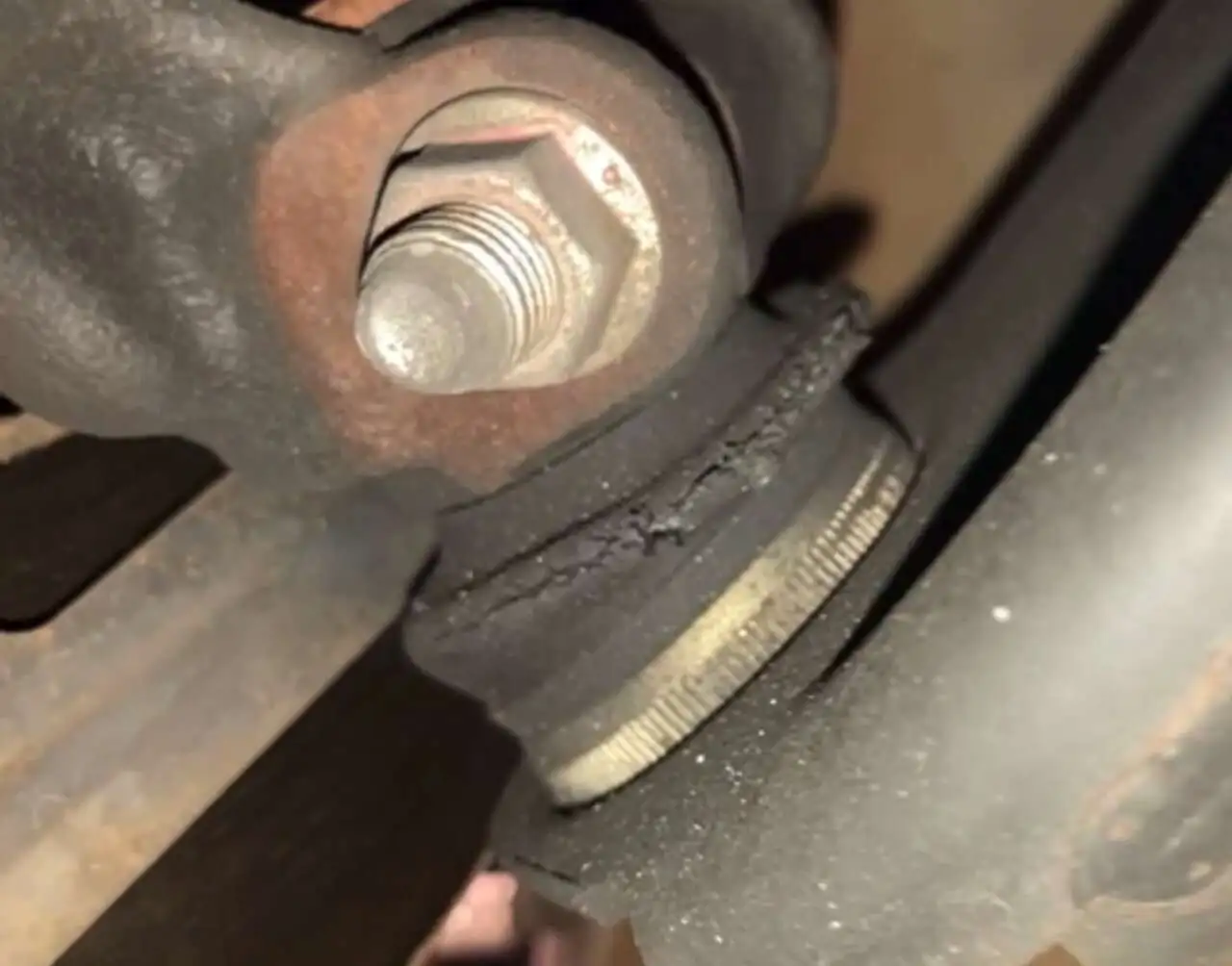

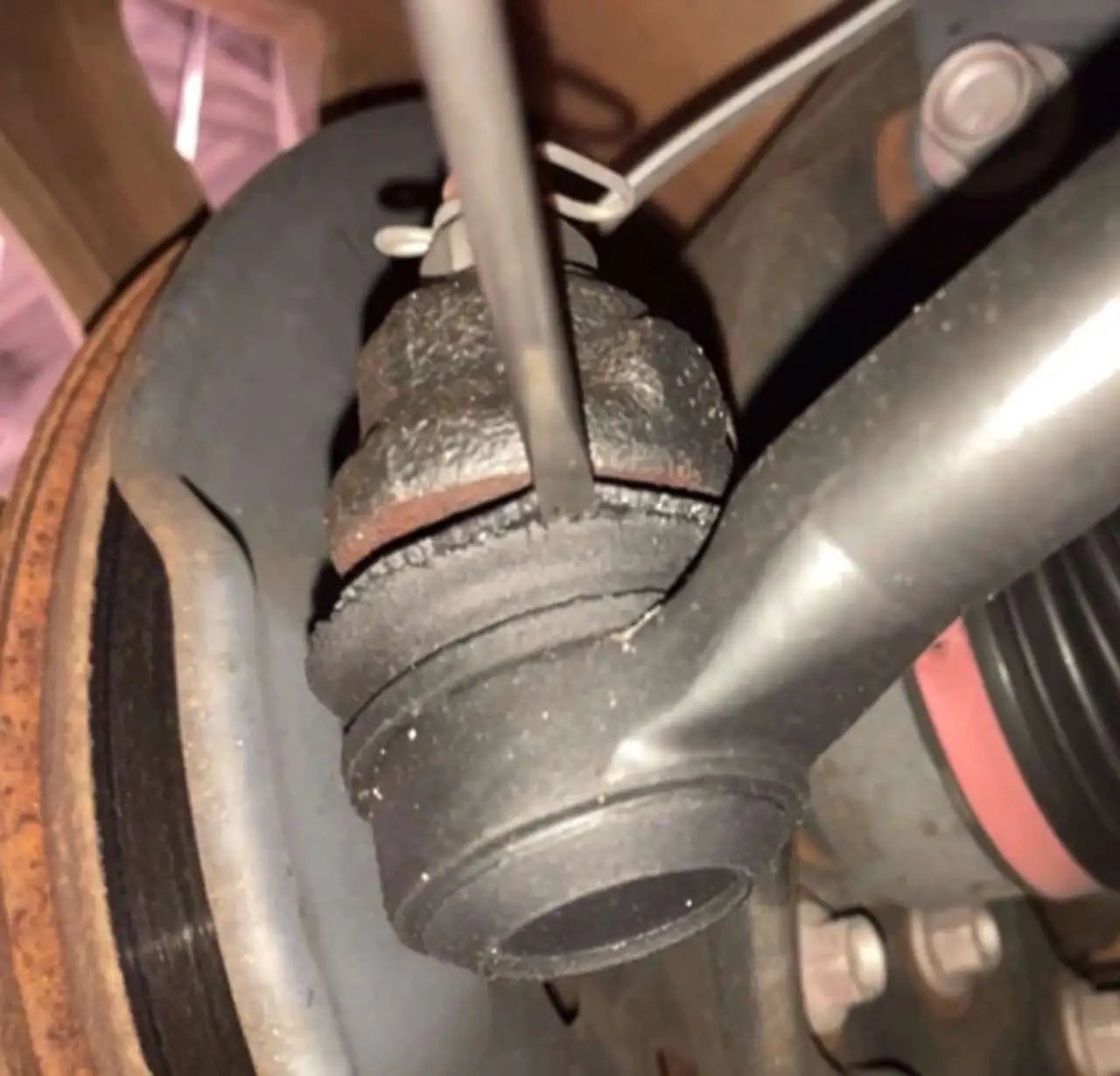

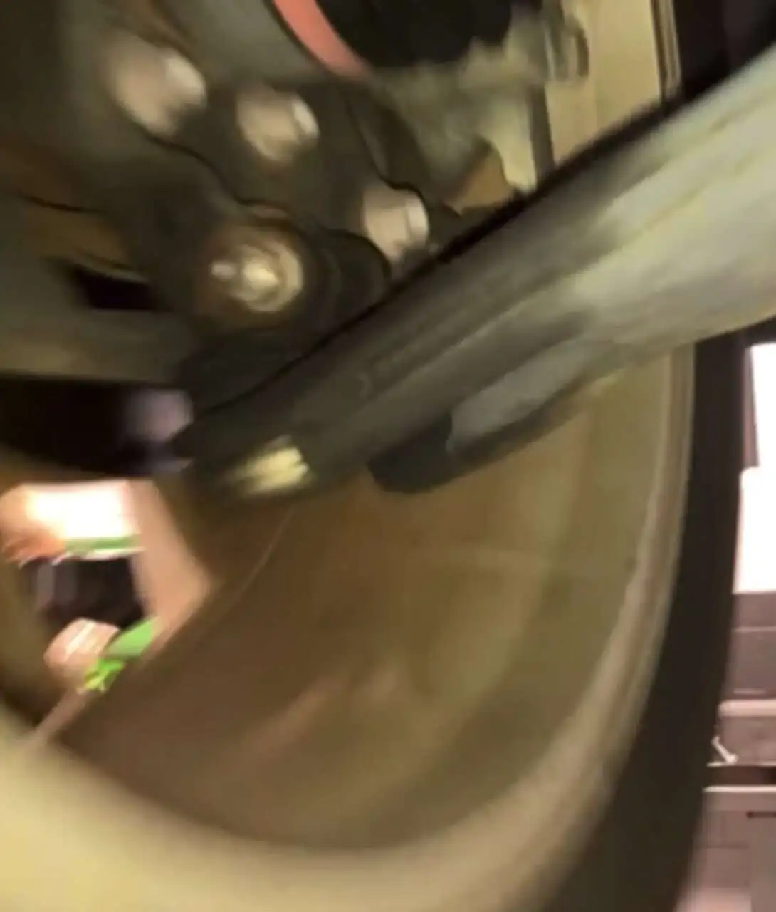

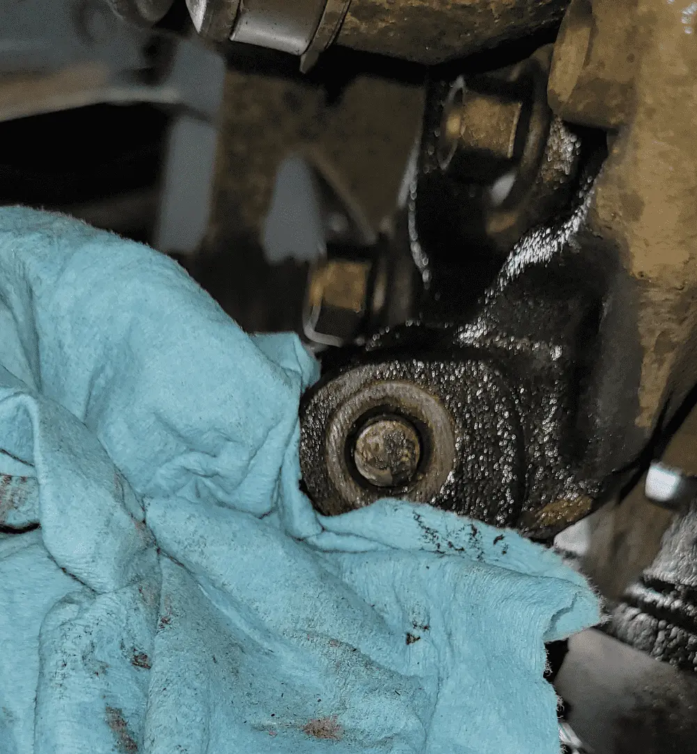

Apologies for the one-year bump, but it looks like I could the expertise of the folks in this thread. My local Mazda dealer suggested a driver-side control arm replacement for $1400 and tierods repair/replacement with alignment for $700 on my 2014 Mazda CX-5 GT, 65k miles, because of torn bushings.
It’s clear that this needs to be fixed (ASAP?) but I’m wondering if this can be repaired instead of replaced, and whether you guys think it’s better to do this at the dealer at the quoted prices, or at a local repair shop with or without buying parts first. Thanks in advance for any advice!
Below some screenshots from their inspection video. The blurry shots are my attempt to show where the close-ups are taken.
Front left wheel
Torn lower bushing
Torn upper bushing
Close-up with pry tool
Front left wheel
Torn lower bushing
Torn upper bushing
Yeah those Mazda rubber boots seems not as durable as my 1998 Honda CR-V. Dealer price of course will be very high as the labor charge has been up to $200+ per hour!
If the play isn’t too bad, you should be able to take time to find some good and reasonable indie to replace those ball joints and tie-rod ends. Unfortunately Mazda doesn’t sell those rubber boots like my Honda CR-V does, where I replaced all of them including steering rack boots at 180K miles.

Exactly, the dealer told me replacement was the only option, but I was hoping they were omitting some acceptable third party solution.
I wonder if it makes sense to order the parts myself, not sure about the upcharge if an independent shop orders it. If anyone here knows that'd be great.
As for driving on it, I was going to do that, but I have to say reading this thread is giving me pause!

As @yrwei52 said. If it's not rattling/clunking then there's some life in it yet. Find an independent and ask them the cost and if they'll accept your parts (some will, many won't). I got my (non-OEM) replacements from RockAuto for ~$110 ea. I will say that if one side is going, the other side will follow soon, so you may as well bite the bullet and get both sides done together. I certainly wouldn't pay $1400 for one side. That's daylight robbery. It's not that big a job if you have a lift and access to the required tools.
Upvote 0
Thanks for all that, I'll check and see what the local repair shop says. Yeah $1400 seemed steep!
I'll do some searching later today, but if you or anyone else here happen to have a link ready to the part(s) I'd appreciate it. If not I'll post what I find and maybe someone can give their thoughts. Thanks again!
Looks like you also need tie-rod ends in addition to the ball joints on LCA.
If you have Brakes Plus near by, try them first.
Upvote 0
I wonder if it makes sense to order the parts myself, not sure about the upcharge if an independent shop orders it. ....
Although I'm a DIYer and don't use shops, I have a fairly good idea how they operate. They're going to have a target amount of profit to make for any given job, which is certainly understandable and reasonable IMO. So even for those shops that would agree to install owner-purchased parts, I suspect they would make up the lost markup on the parts, by padding the labor. And that aside, they almost certainly would not warranty any subsequent issues with those parts. I recommend going to 2-3 indy shops, getting quotes for all of the work, and then comparing the quotes, along with your gut feelings about your conversations with them.
