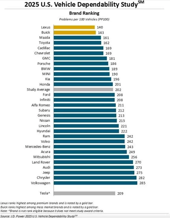

If this happens at less than 100k mile with no acknowledgement or accountability, why not go to honda or toyota, where these expensive issues are unheard of.
Unfortunately these types of issues plague every manufacturer, regardless of their reputation or past history. Some happen more often than others. Believe it or not, prior to the CX-90 and CX-70, Mazda as a brand ranks between Toyota and Honda when it comes to reliability. More recently, Honda is further down the list, and Mazda is usually very close to Toyota.
I recognize that this doesn't help your current situation. Ultimately it comes down to the person on the other side of the phone/computer screen that has the final say regarding coverage. Some people have been able to get full payment coverage with their reps, while others get nothing more than a "Sorry, here's a free oil change". So much of it depends on who you get on the phone and how far that person is willing to go, or how much you can wear them down.
