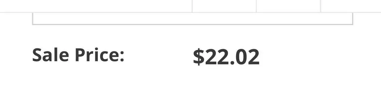

$22 for the part, $51 for the labor and $9 for shop supplies. Mazda Extended Confidence service plan covered all but the supplies. First claim since Factory warranty expired 3.5 years and 33k miles ago. (69k total miles on my trusty GT).

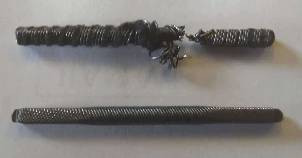

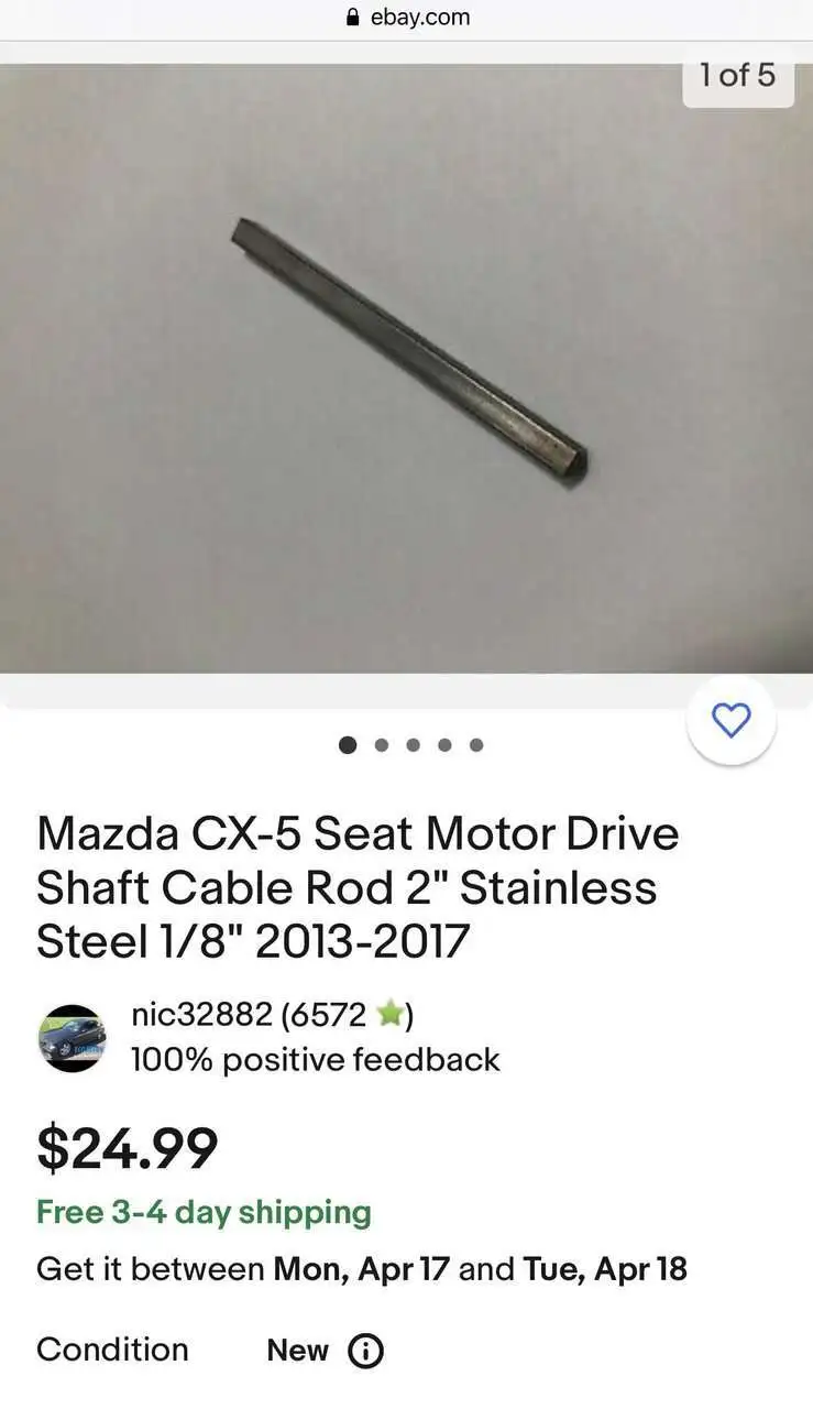

PaulZooms, thanks for your response but that is the long cable that spans across the width of the seat adjuster frame. The short cable that is directly from the motor to the closest seat adjuster track is the one that I need. I am going to see if I can measure what's needed (+- 2" length) and have a machine shop make up for me.
@Eddie B. Did you see the thread that yrwei52 posted above? It shows alternatives for the short cable too.
RedBaron, thank you for referring me to the post by yrwei52 which I followed and have ordered the short 2" cable on eBay for $24 from nic32882. Also, the pictures of the short broken cable that were posted were exactly the same as my broken cable situation. Since I was able to remove the motor and cables without removing the seat ( similar problem in that the seat failed all the way back and a wrench could not access the seat bolt) I expect to be able to install the short cable when I receive. Thank you everyone for the input. Eddie B.

The replacement part you ordered won’t be the speedometer cable type like the original as you can see in post #6 in that thread by the OP. Instead, it will be a solid stainless rod / shaft and it’ll serve the same purpose stronger and better.
Yes, I understand that the replacement cable will be a solid piece of stainless steel and since it is a very short length it should not need to be very flexible like the long cable. By the way, those are excellent close up pics of the original broken and new cables which give a very clear picture of the situation.

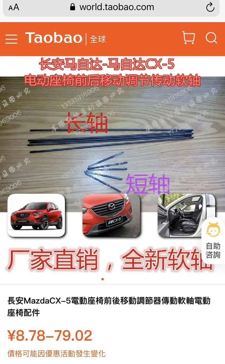

No, Mazda doesn’t sell the short flexible steel braided cable for its power seat in the US. If it breaks, you need to get the whole seat bottom which’ll cost your hundreds. I have seen CX-5’s short flexible steel braided cable for sale in China. Unless somehow you can import it here, the $25 solid shaft is your only choice in the US.

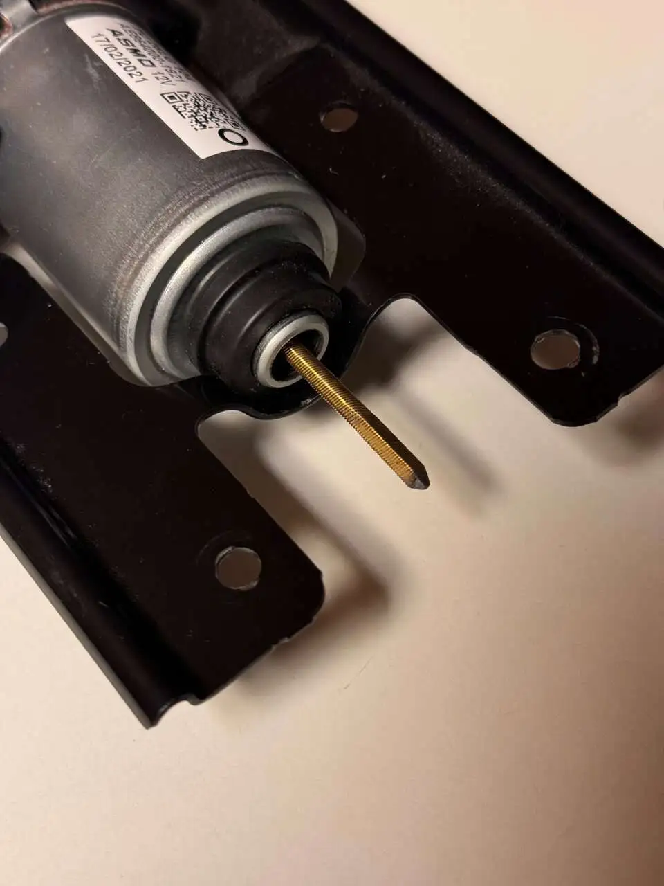

Update: I found a perfect flexible short (50 mm) shaft for $9 including shipping from China on AliExpress. It took only 11 days from order to delivery. See photo below.
The solid shaft sold on Amazon for $25 is a ripoff. At Home Depot, you can get 1/8" square key stock 12 inches long for $2 - enough to make 6 shafts.
As I mentioned above, I think the solid shaft is a bad idea. If the seat jams, then the shaft will not break and something more expensive will fail, like the motor or the gear drive.
