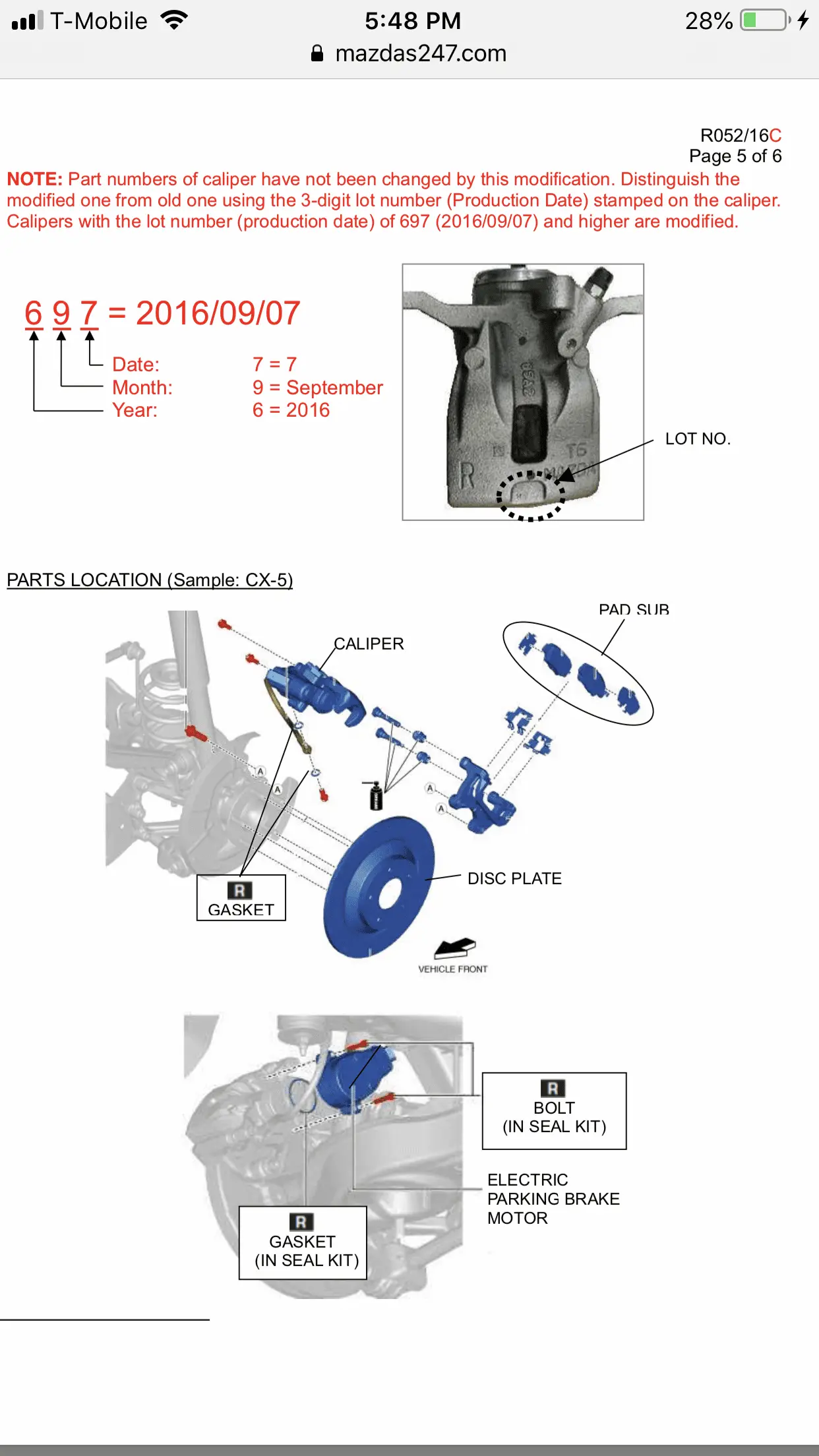

Well crap! I knew that there was something that else that I should have checked on while I had the wheels off! Do you know where exactly that stamp is located on the caliper? I just checked the built date as shown on the driver's door sticker. It says 8/16.
"The TSB says CX-5*s with VIN JM3 KE 600015 - 866136 are affected" My VIN falls within those numbers, it's near the end of that sequence but it is within it.
The lot number is stamped on the middle-lower side of rear caliper:

I post 2 related TSBs of this EPB dragging issue with links in post #52 above. TSB R052/16C still can be seen in the attachment of the post. Therere plenty of informations in there including the lot info I posted here.
My 16 falls in the VIN range and no problems. Was in for service couple weeks ago and all 4 brakes are fine. Somebody said it will affect all CX-5's in the VIN range but I'm not so sure. I don't let the parking brake snap off, I release it manually each time before putting the car in gear. I also apply it with the vehicle in park and my foot on the brake.
Just because your Mazda dealer says no problems it doesnt mean you have no problems on your rear calipers. The tech told me no problems on rear brakes when I took my CX-5 in for last warranty service and checking this EPB dragging issue based on the TSB is one of the items to check. But I pushed it to a master mechanic and asked him to check it in person. He agreed therere signs of dragging and replaced everything for me.
If you read the TSB carefully, youll find Mazda started to resolve this EPB dragging issue with firmware update by replacing the EPB control module, see TSB 04-005/16 in post #52 above. Apparently that couldnt resolve the issue and Mazda had to modify the ball and ramp which are part of EPB mechanism to improve the accuracy of screw threads. And this EPB mechanism is a part of rear disk caliper. Just like cylinder deactivation problem, Mazda would start with the cheaper way to fix with software update, but IMO Mazda has to physically modify the system so that the rocker arms wont fall off even if the oil pressure is changing out of the range.
So if you have original rear disk calipers, you will see some dragging problem until you get revised calipers. One Australian member was questioning my statement earlier, and he ended up needing new rear calipers for himself.

Mazda uses the same part numbers for both revised left and right rear brake calipers. The difference is the 3-digit lot number / production date code stamped on it. See post #61 above and the TSB for details on all parts needed for the caliper replacement.
