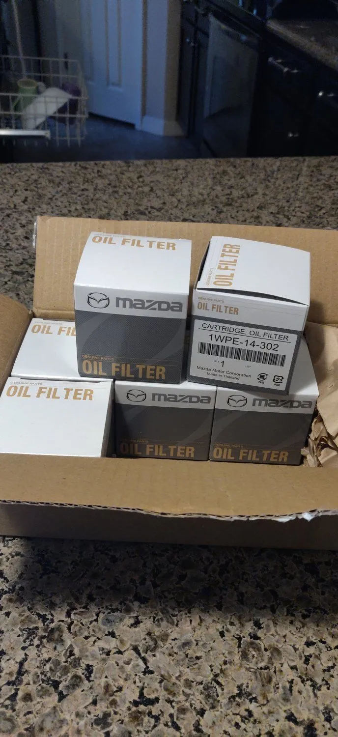

This just came in. 6-pack from a local dealer.....whom sold them cheaper when ordered though Am@z0n. Averaged to $7.67 each. Made in Thailand filters which is premium. Made in Japan are like limited edition Jordans lol!!! Avondale Mazda ftw.

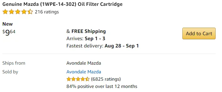

Looks like they updated their listing:
https://www.amazon.com/dp/ (commissions earned)
Perhaps get a direct quote?
6-packs has multiple sellers if you look on the right hand side of likn posted^. I selected Avondale Mazda mainly since thats where we got our car from and where I usually order OEM parts from. If there's an issue I can take it up with them locally.....have no experience with the other sellers though.
Other Sellers on Amazon
$43.99
+ Free Shipping
Sold by: Mastria Parts
$46.04
+ Free Shipping
Sold by: Avondale Mazda
$48.15
+ Free Shipping
Sold by: Dealer Sales Solutions LLC.
