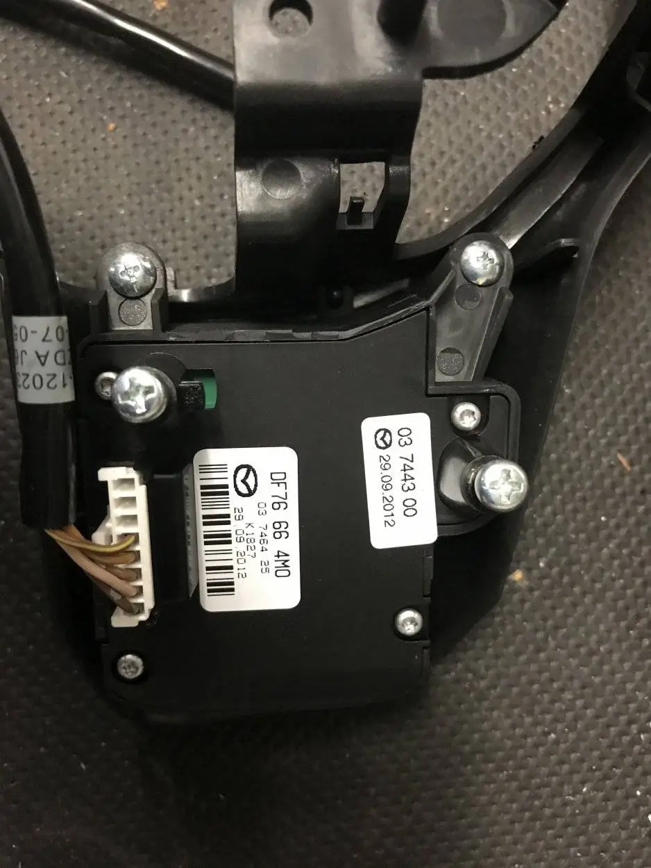

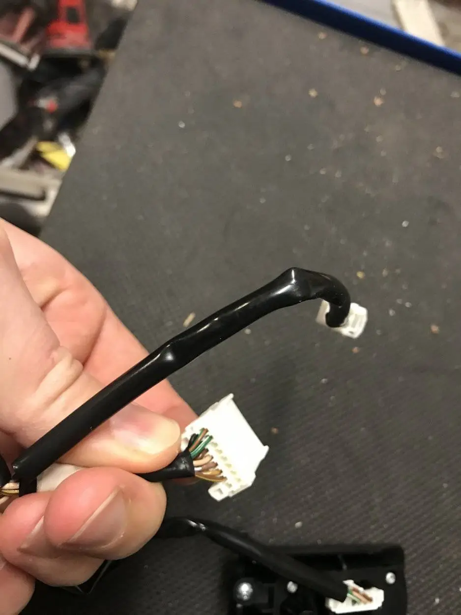

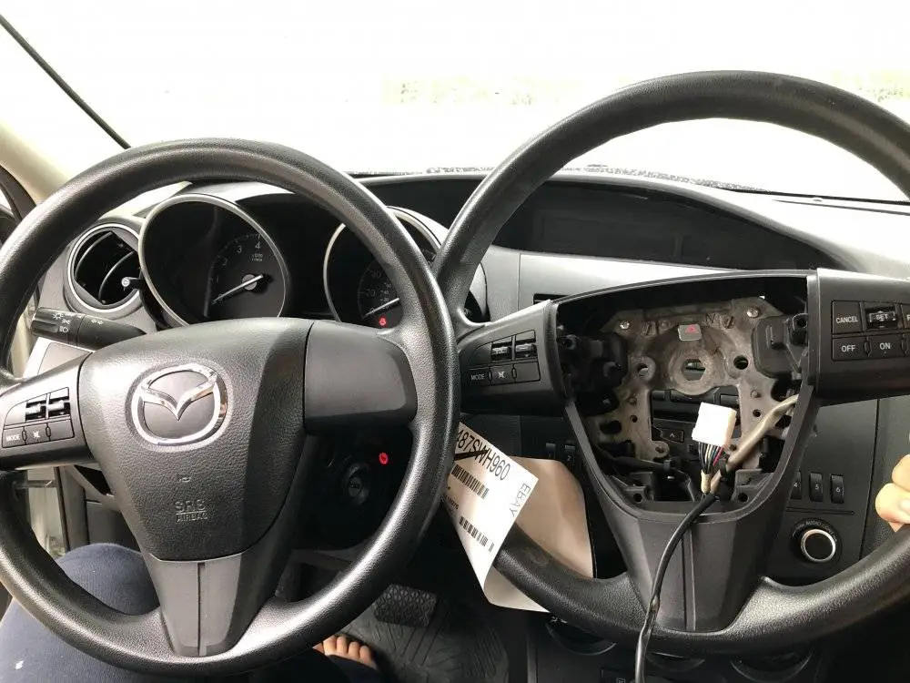

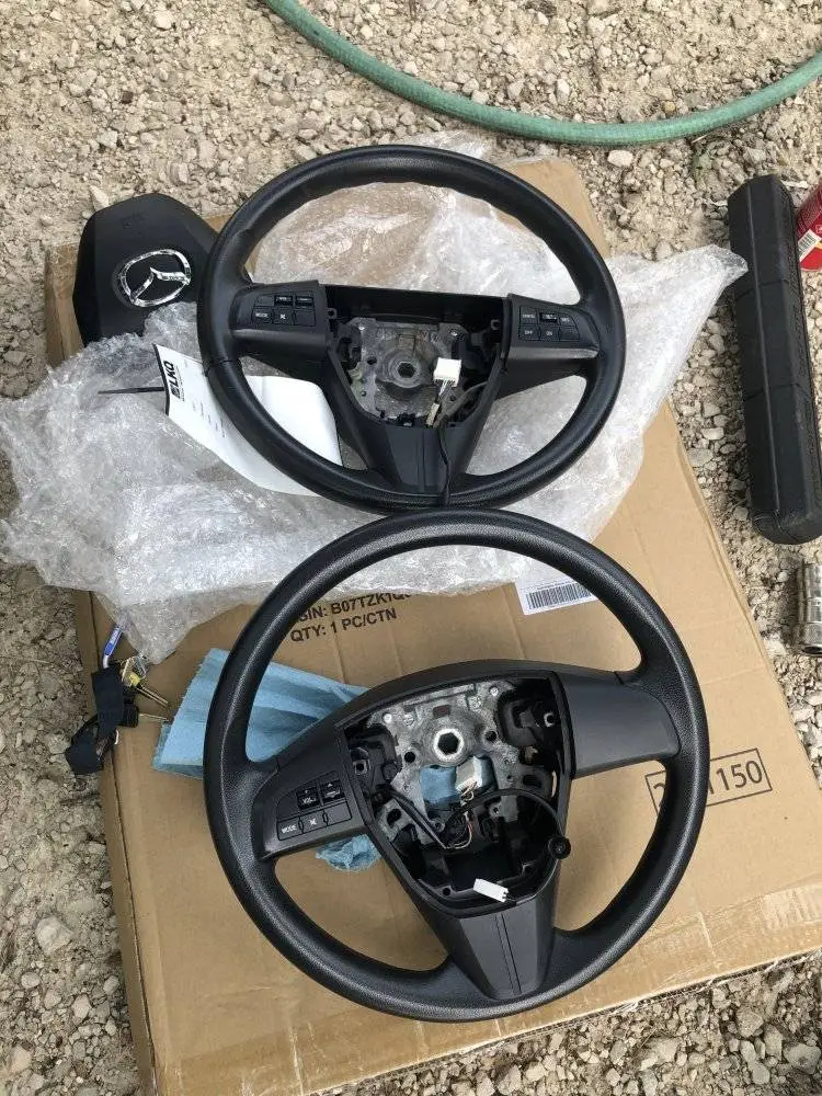

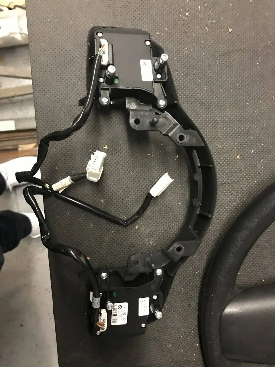

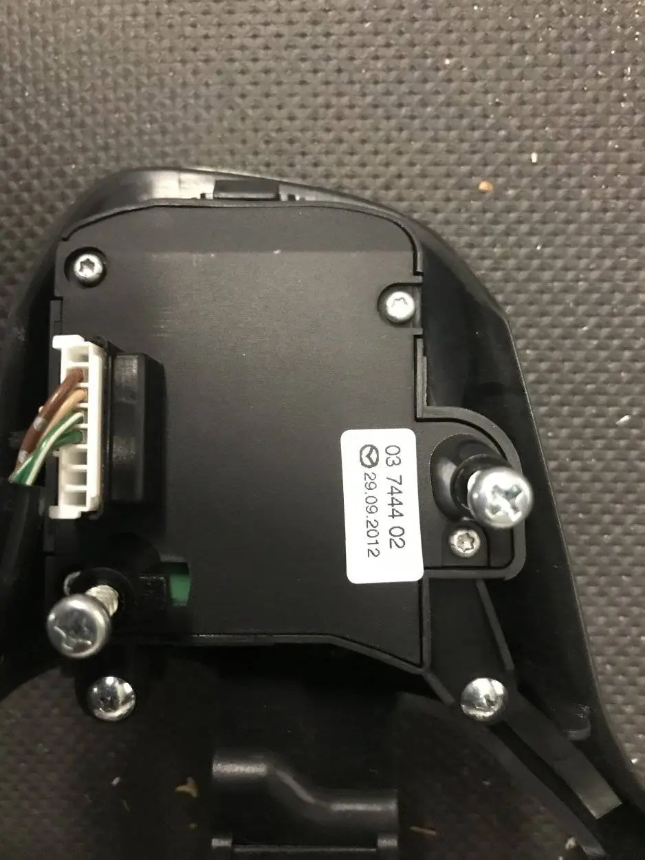

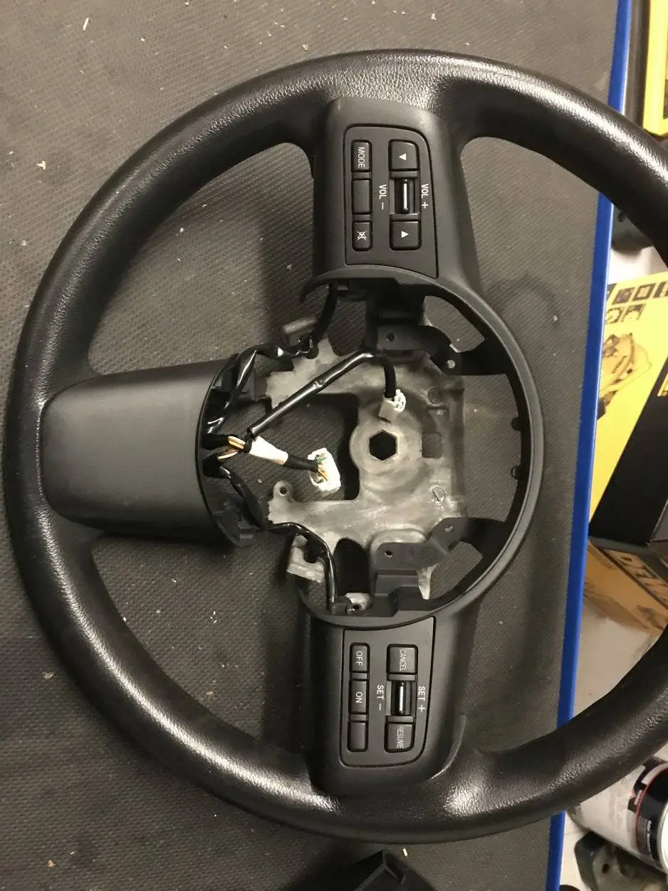

Well I figure I will give this a go. I have acquired a steering wheel as a donor for the switches.

Well, the wheel has been swapped over and plugged in. No dash warning lights thus far, disconnected the battery before starting.

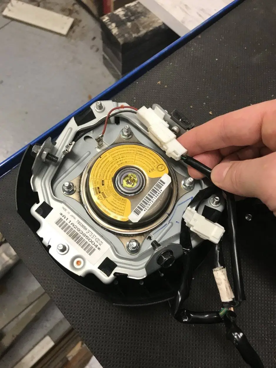

Probably the hardest part is getting the air bag module unplugged. You need to pry up the small black clip in the center of the yellow connector before it will release.
Waiting on a OBDII USB cable at the moment and am yet to work out what the brake switch is. Looks like i have one already on the pedal. Will check and see if there is any other spare plugs down there shortly.
I was a bit unsure about the brake switch. This video seems to indicate that the one I currently have only has 1 set of pins. So that would tie in with what is mentioned above about the 4 pin brake switch.
Also with the airbags, normally the connectors have an isolating shorting bar that earths the two pins together when the connector is removed. In this video you can see that the connector is still in the air bag and there are loose wires dangling about. This I presume is unsafe as with the connector in the isolation link is disengaged and it would only require a small potential difference across the pins to set the module off.

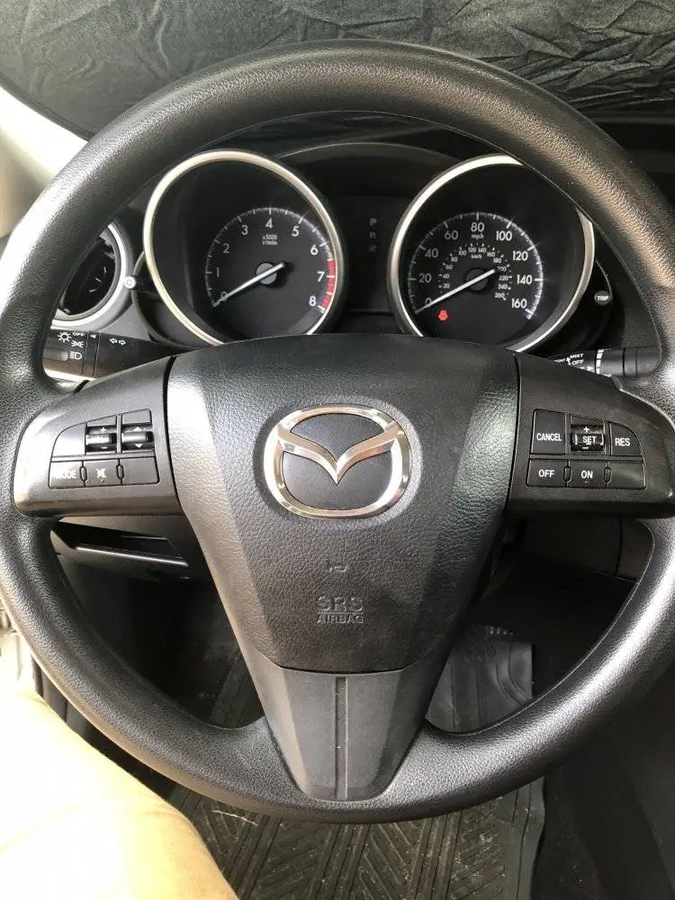

May as well ask a question and throw in my $0.02 here. I have a 2013 Mazda3 but am going down this same path. So far all dealers near me and speed shops have been dead ends on this mostly simple programming procedure for them. NE Illinois, USA area.
Does anyone know if the latest iterations of ForScan have a built in function of turning on cruise? I’ve heard sometimes it does and you don’t have to mess with the hexadecimal. I’m warming up to the idea of just doing this myself.

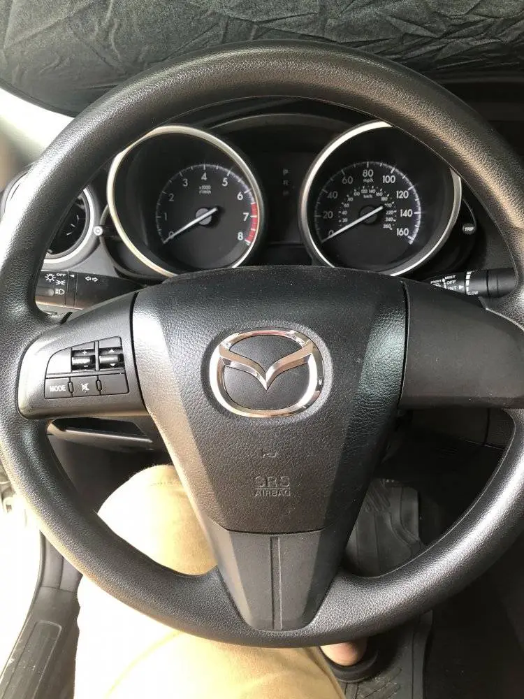

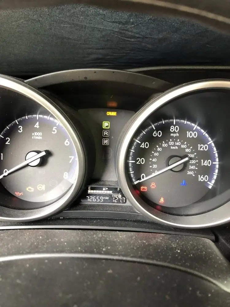

Fwiw pictures of my car and the recent work on the wheel.

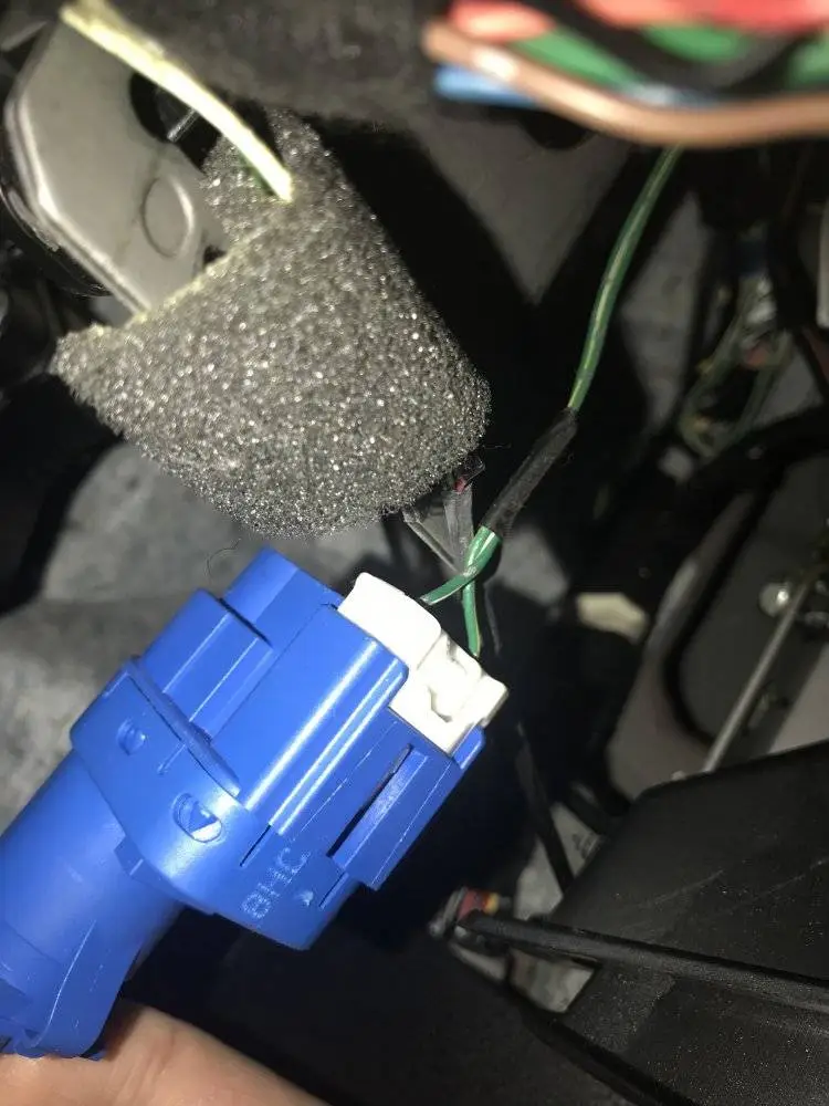

Also I just checked my brake pedal switch as I had not done that part yet. Looks like I only have 2 wires running to the switch. So swapping the switch to the double pole version is not going to achieve much. Will need to investigate what loom I need.

The small white plug looks like the one on the brake pedal switch. I’ll probably have to cut the two wires into my loom as chances of finding a manual one with the clutch switch might be hard.

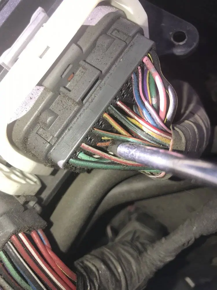

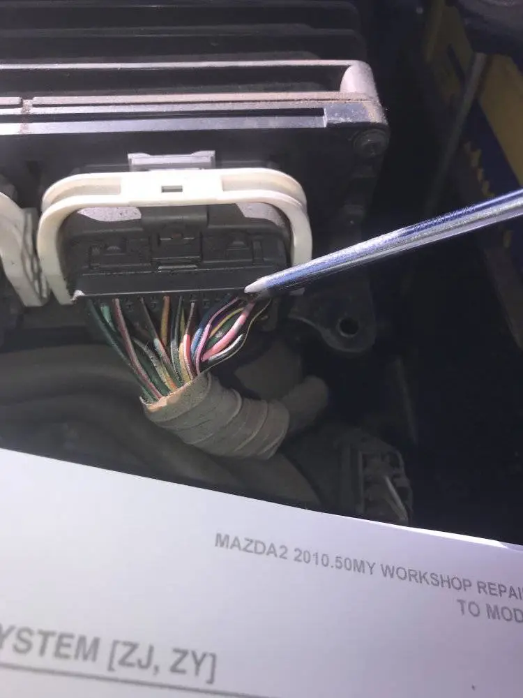

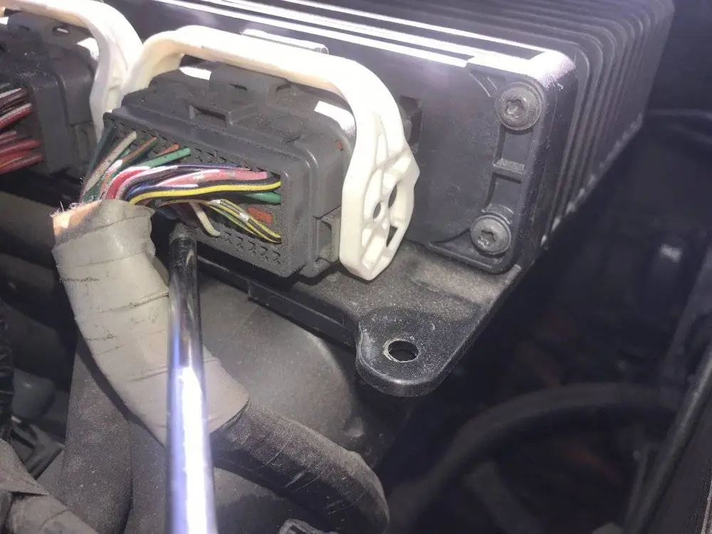

Some pictures of the PCM connector in the engine bay of my 2008 built Australian delivered 2.

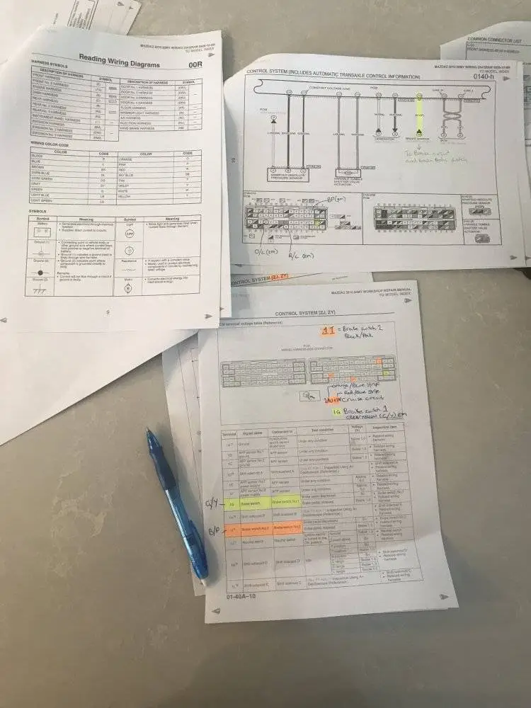

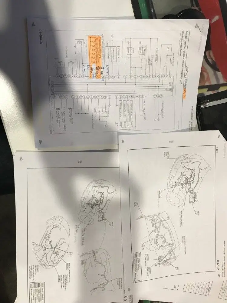

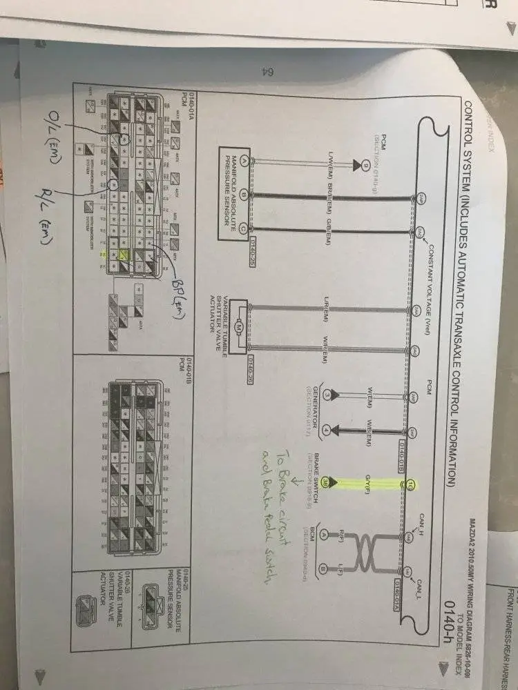

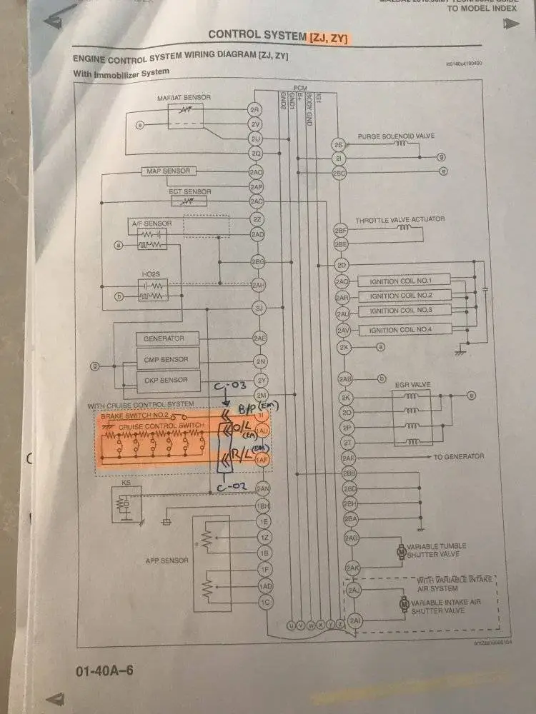

Some mark ups from the manual...

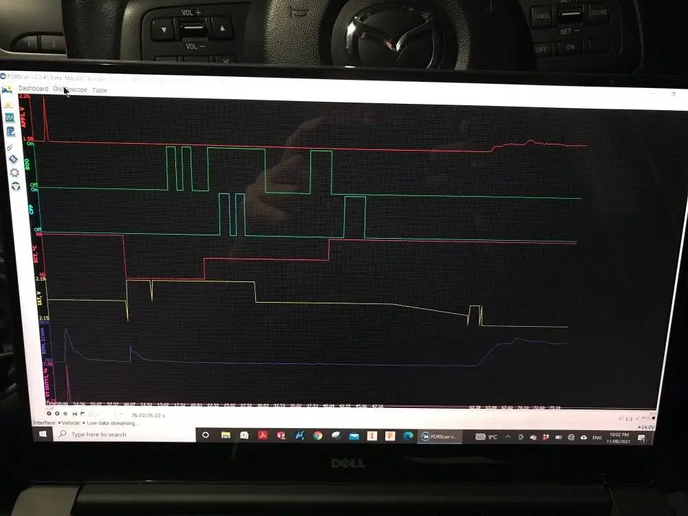

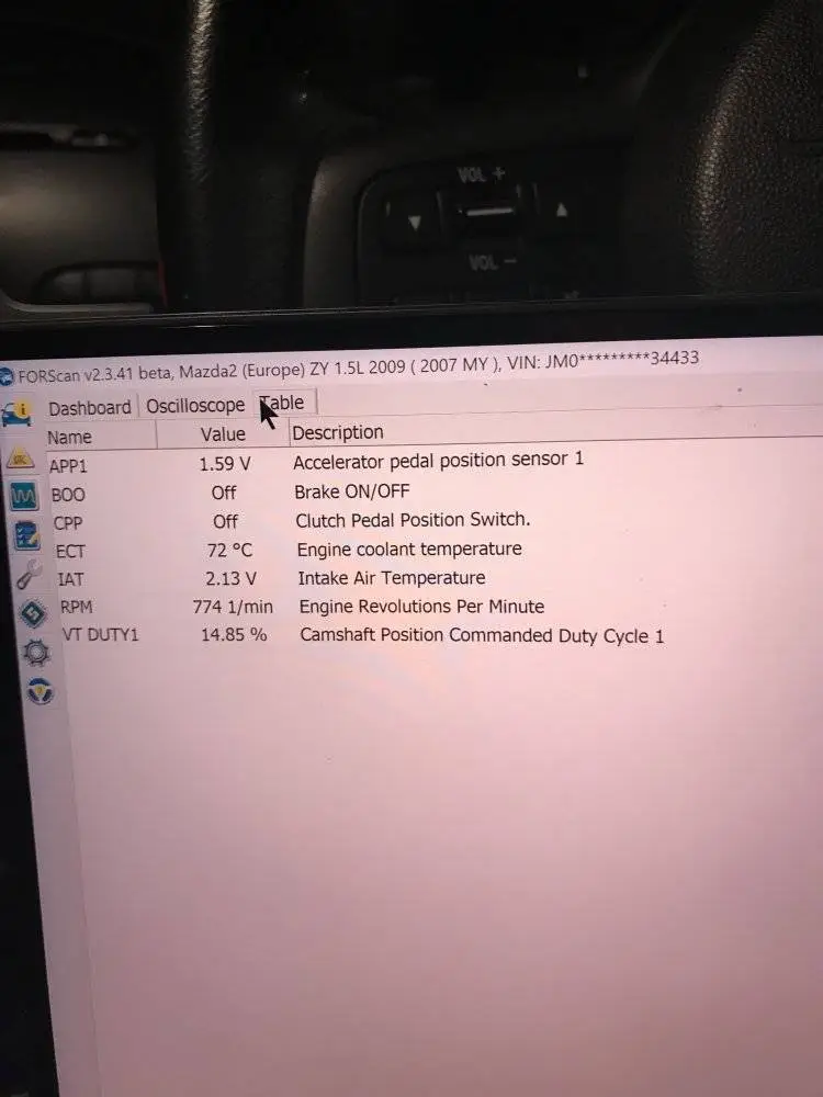

In Forscan I can only see the one brake switch presently. This will be the input on 1G. Can you see brake switch input 2, after you change it?

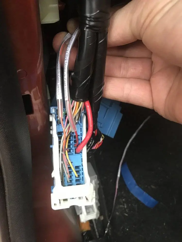

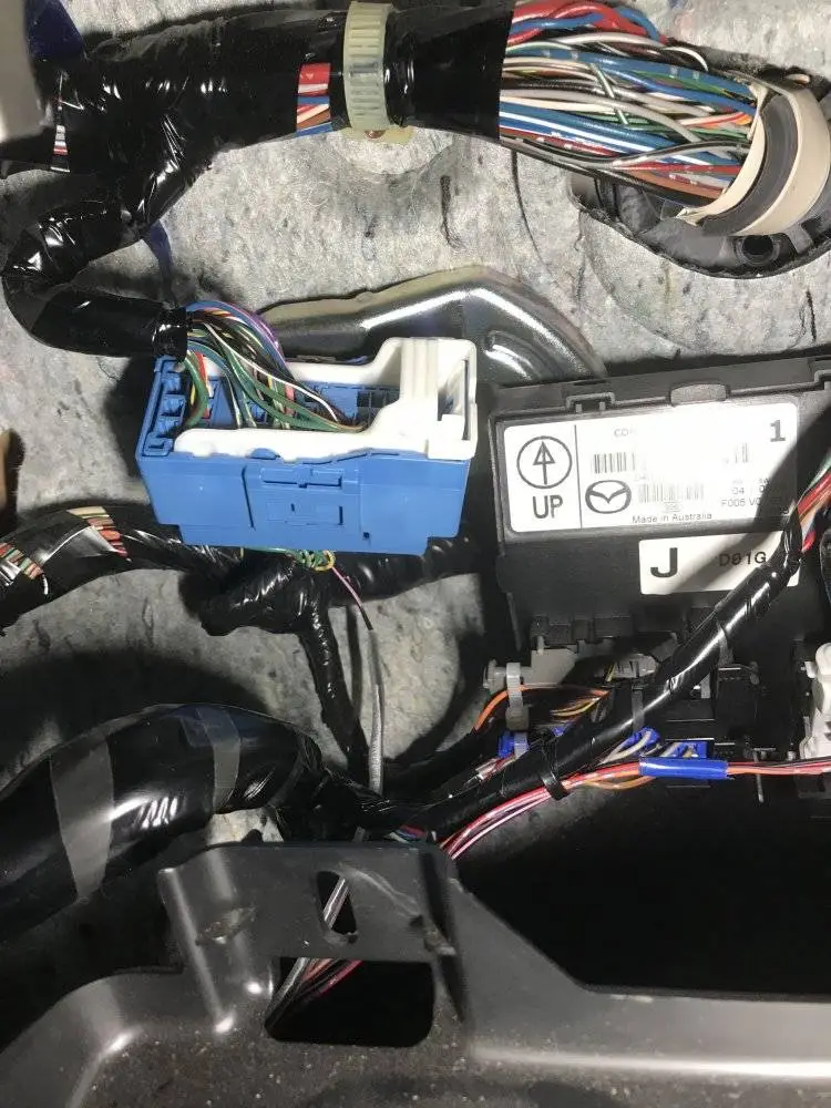

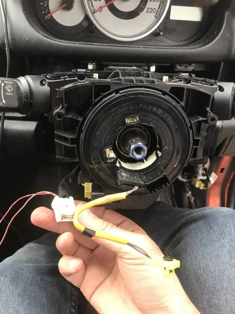

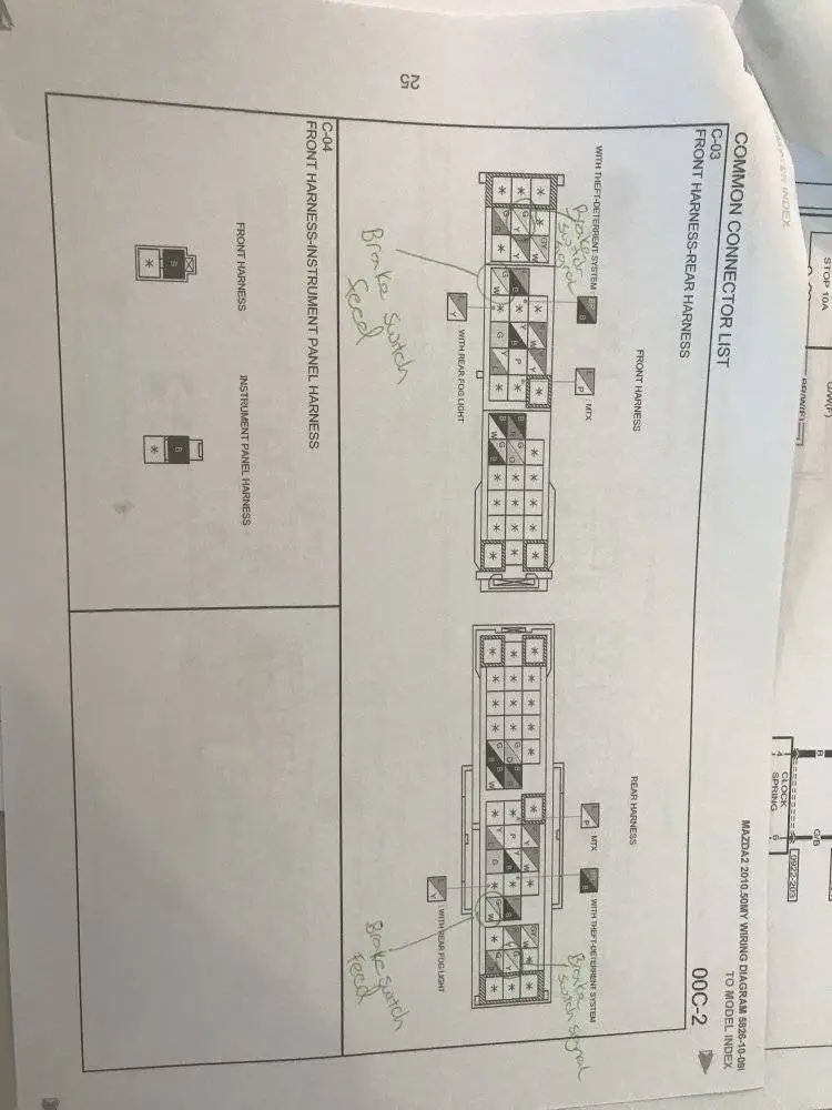

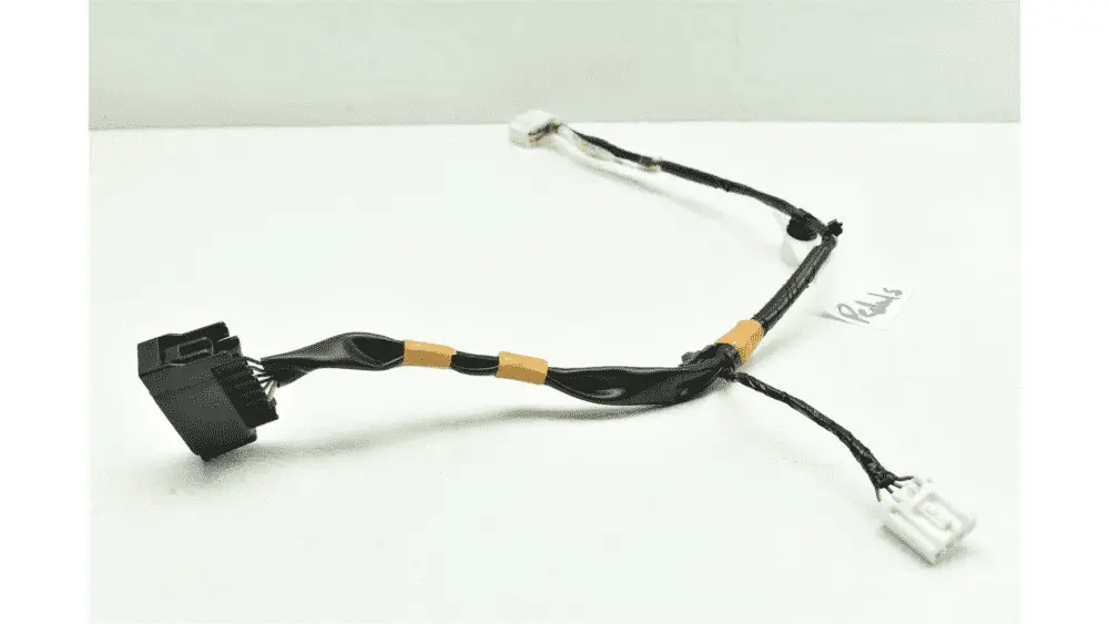

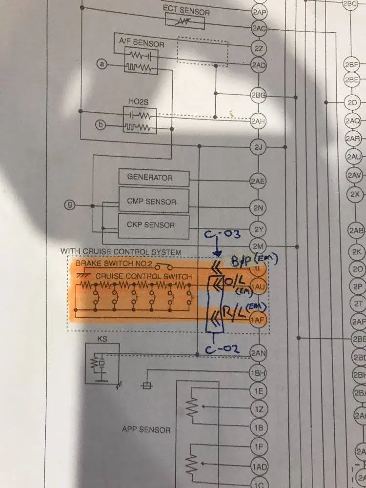

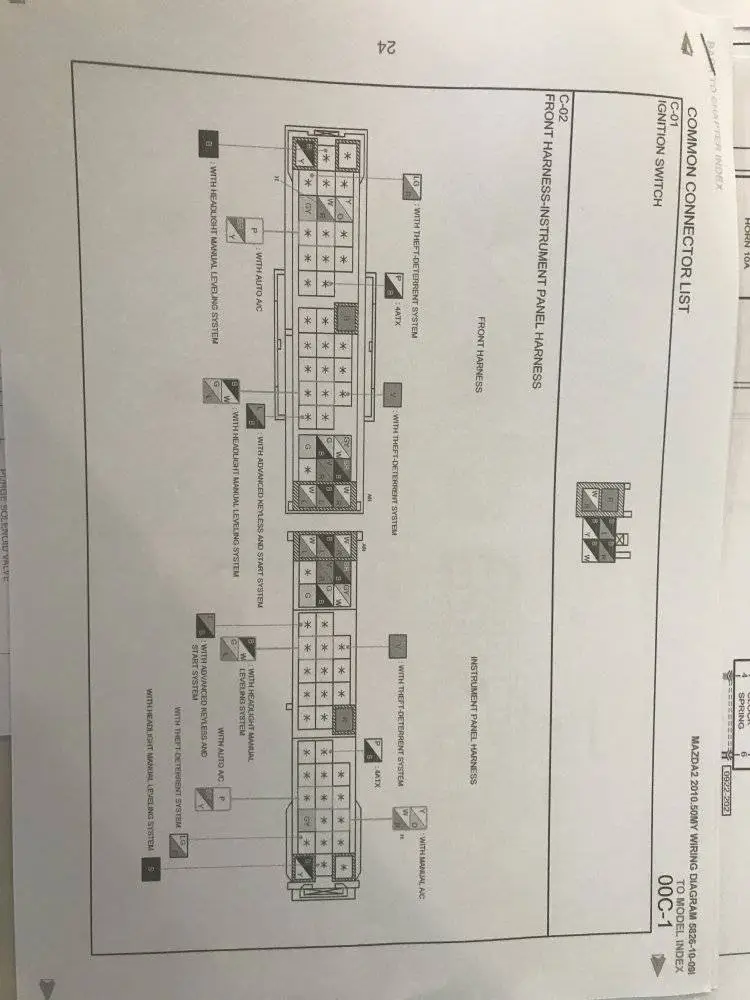

Well I bought a full wiring harness from the UK. My Australian delivered car did not have any of the wiring inside the cabin.
If you go looking on the M2O owners group, or the M2 UK owners group, one of the pages has a link to the workshop manual.
from here I was able to work out what wires were missing.
1 - Brake Switch circuit #2. This needed two wires connected to the brake pedal switch. One of these goes to earth. The other goes to the Black with pink stripe on common connector C-03. Behind the glove box on a right hand drive car.

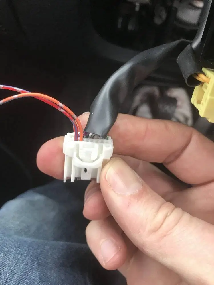

2 - A pair of wires that run to the clock spring on the steering column back to common connector C-02. Located in the left hand kick panel.
I am now up to the point where I can do the Forscan changes.

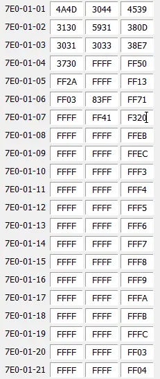

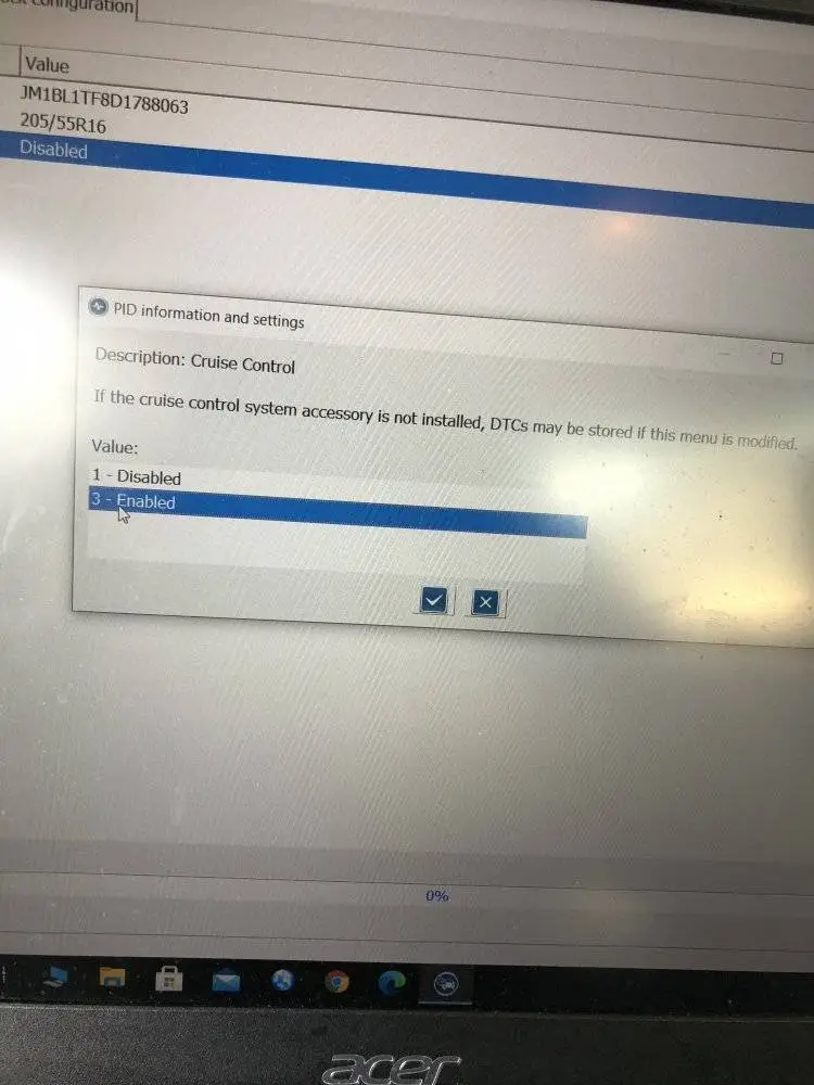

I got this working the other weekend and can confirm it was as simple as changing line 7 and line 25 in the PCM table, as suggested.
Happy days.
Ryan.

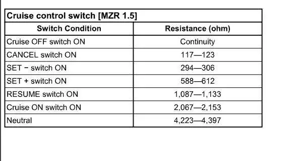

Do any of you fine gentlemen know the resistance values for the cruise control buttons?
I lack the switches and cant seem to find them here in Ontario Canada, and would like to create my own.
I seem to already have the 4 pin brake switch installed in my 2014 Mazda 2, so I am guessing along with the code change with the forscan tool, all I need are the switches which seem easy to create myself.
I attached a photo of a potential answer I found on another forum: Mazda 2 Cruise Control - FORScan forum . I am noticing the Mazda 2 and its drivers are a rare sight here in north America and there are a few differences with the European and other versions of this bad boy. Any additional help would be greatly appreciated!
Those values and table are from the service guide and give the range of resistance the ECM is looking to see on its input pins.
So if you get a resistance in that range it will work.

I've just started to do my install.
i've changed the code on line 7 to F320 as required.
However i'm not sure what the block address should be changed to. I've been trying to follow the post by ezakimak on page 11 of the forscan 2010-2013 Mazda 3 Cruise Control Activation
as i believe we have similar cars.
Any help would be greatly appreciated.
