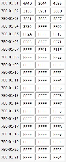

line 7 is where you have to change a bit to activate the cruise control. This is where i changes F11E to F320. This change is a combination of two things.
When you convert that 4 character number from Hexadecimal to Binary, you will see that the following has changes.
F114 = 1111,0001,0001,1110
F320 = 1111,0011,0010,0000
now i have put the commas in to separate out the individual bites.
the last two bites (8 binary bits) are a check sum.
by changing the red 0 to a 1 we have actually added a binary value of 2 to this line. So we have to increase the value of the check sum for the entire line by 2 as well. ie
Binary value:
00011110 + 10 = 10,0000
converting this number back into hex gives us the 20
So this is how we derive the value that we need to put into the line 7.
now as we have added 2 (binary 10) to line 7, we have to subtract that same value from the overall file check sum in line 25, hence my 29 becomes 27.

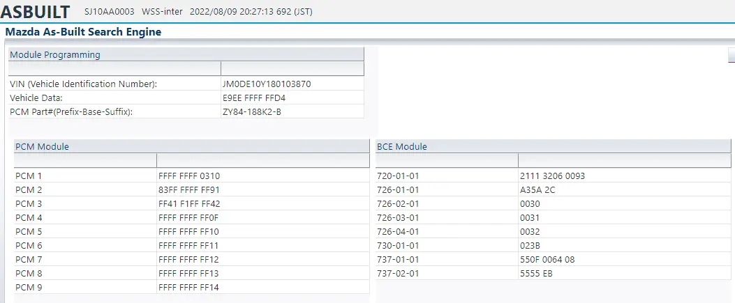

That's my PCM module data fortunately my car is JDM made. I'm still struggling to understand, well everything ill be honest. Coding has never really been my thing and this just proves it haha. Thank you for all your help Ryan!
View attachment 312092View attachment 312093
I've just started to do my install.
i've changed the code on line 7 to F320 as required.
However i'm not sure what the block address should be changed to. I've been trying to follow the post by ezakimak on page 11 of the forscan 2010-2013 Mazda 3 Cruise Control Activation
as i believe we have similar cars.
Any help would be greatly appreciated.
Hi, I have a mazda2 2014 DE 1.3l. Based on your forscan data i think my car is very similar.
I need help figuring out the cruise activation.
I’ve swapped the buttons. I have a 4 pin connector pre-installed (factory, i think). In Forscan i changed the following:
- IC: cruise control enabled
- PCM line 7 (F11E - F320)
- PCM line 25 (F3FC - F1FA)
No errors, but, no cruise light either. Am I missing something?
If necessary I can upload images from forscan. Maybe I need to check the electrical connections of the new buttons? They do light up with headlamps on, and the other side (radio control) works fine.

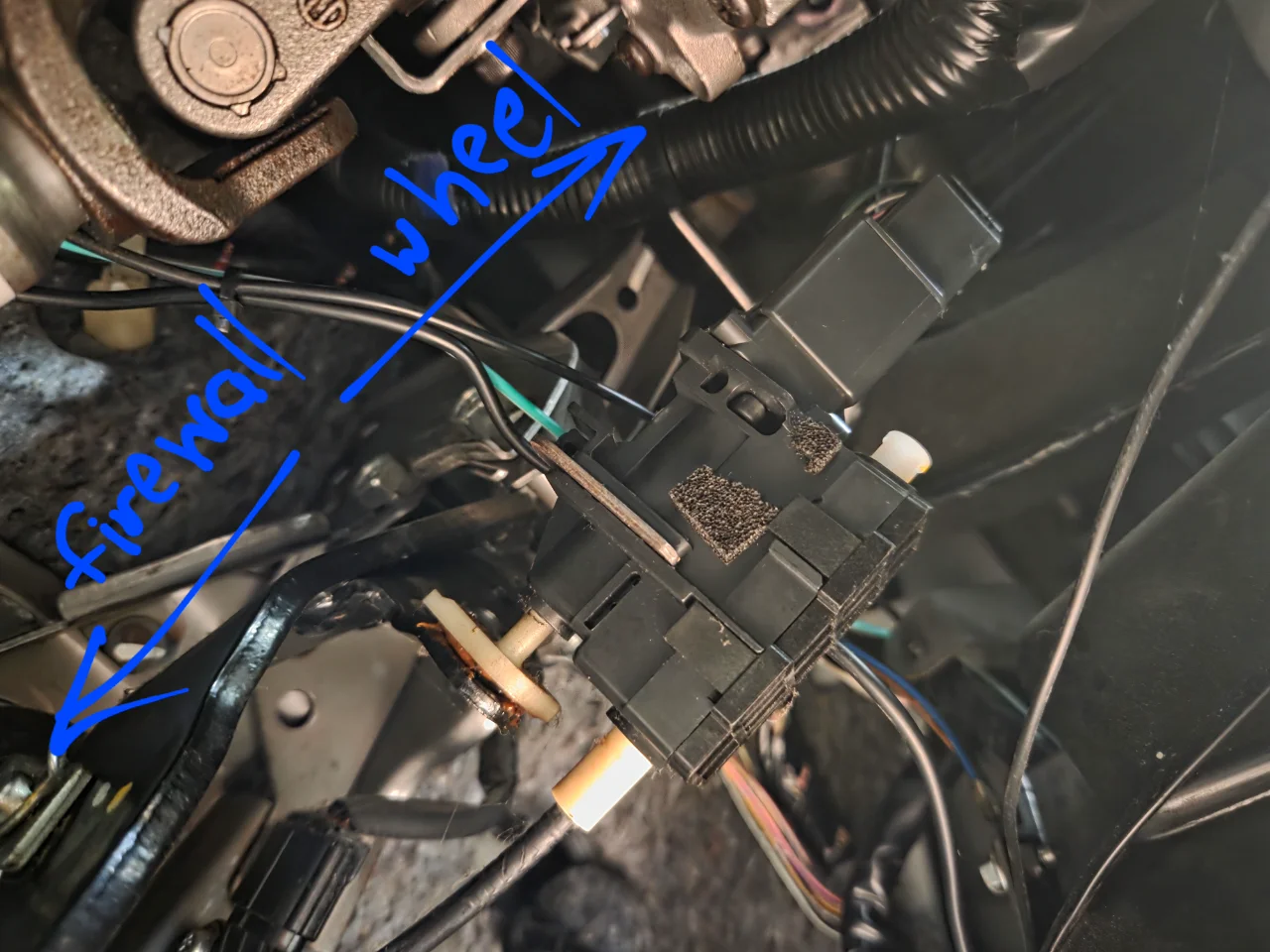

Right an update.
I figured out that the PCM does not have the connectors in 1AF an 1AU. I assume (and I’ll confirm today) that 2C and 2E also have no wire connected. If so, I think (based on the images in this thread) I can just add the needed wires.
The question is now, what gauge and length is needed. And most importantly can i just connect the PCM straight to the ClockSpring or is there a terminal in between?
I’m thinking of buying 5m of 0,75mm2 wire. I’m just not sure if it is the correct wire.

Last update:
2C and 2E actually did have a wire connected to it. So I followed the wire down the harness and ended up behind the kick-panel. There the wires connect to a common connector (C-02 in the wiring diagram). On the other side of the common connector the slots were empty, which explains why no wires are present in the terminals 1AF and 1AU on the PCM connector under the hood. Because the connectors (both PCM and C-02) need special terminals (wire pins) to attach the wires, I went to a scrapyard and found a Mazda 5 form the similar period. There I found the necessary terminals.
Now I just needed a pair of wires. I think the gauge is about 0.65mm2, unfortunately I only found 1,5mm2 wire. Nonetheless, I attached the small wires to the large wire, routed it through the firewall (a random grommet) and connected the terminals to the connectors.
Now because I already did the computer steps I can proudly say that I have a working cruise control in my 1.3L 55kW 2014 Mazda DE!
So, in conclusion, I added the buttons, had the correct clutch and brake switch and wires preinstalled from factory, changed the PCM data using FORScan and extended the existing wires from the cruise buttons (via the kick-panel) to the PCM / ECU.
I want to thank everyone for all the help and information I obtained through this forum, and of course, good luck to all trying to install cruise themselves!

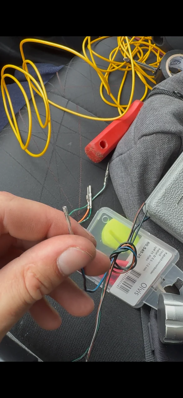

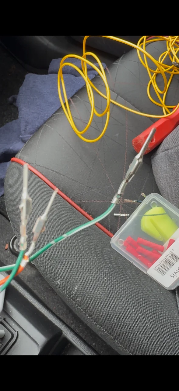

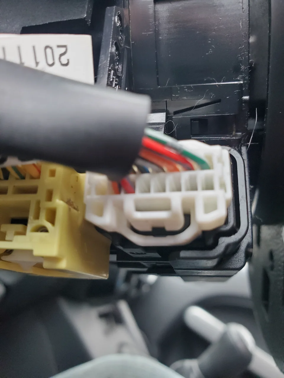

Hi,
In the scrapyard I found a mazda from the similar period. Didn’t matter that it was a mazda 5. There I found the wiring harness and cut some of the wire ends.
I specifically needed two types of wire terminals (metal connector pins) at the end of the wires. One type would only fit the PCM terminal and the other solely the common connector C-02.
See the attached images of the terminals i cut from the scrap car. I then used some wire i had bought to attach the cut ends together and routed them through the firewall, after witch I connected the wires into their respective slot.
I hope this helps.
Hi,
I hope this helps.
Does it matter what kind of wiring harness it is? Or you simply want the cables/wires from the loom? Would it be the engine wiring loom that would do the job?
Thanks!
Thanks!
You simply want the cables and end-terminals from the loom.
What I would do is just look in same place where the terminals are missing on your mazda:
For instance, open up the PCM connector at the end of the loom on the scrap car and yank some of the wires out. And do the same behind the kickpanel or steeringwheel (wherever the terminals you need are missing on you mazda).
It’s difficult to take out the whole loom. That’s why i cut of the wire ends and connected them to a new wire.

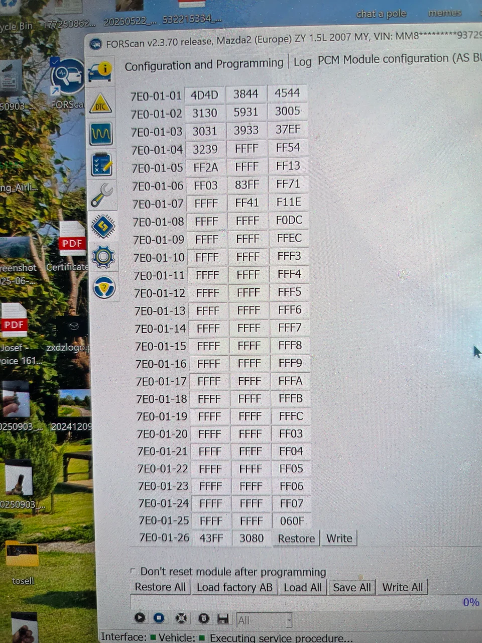

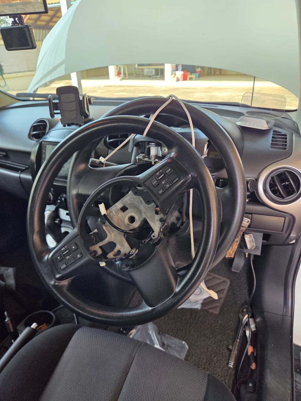

Hi guys, I'm located in Thailand, so I have a Thai built 2012 Mazda 2 DE. I brought over a steering wheel and brake switch from Australia for my car, but it seems my car has a different brake switch setup compared to what everyone else has on this forum. Can anyone verify on what I need to do to get cruise working? I have a sneaky suspicion that it has a different eletrical wiring.
I have tried to reprogram the PCM anyways to give it a shot, but unfortunately the cruise light never came on. Please find my PCM setup below:
Line 7 : F11E -> F320
Line 25 : 060F -> 040D

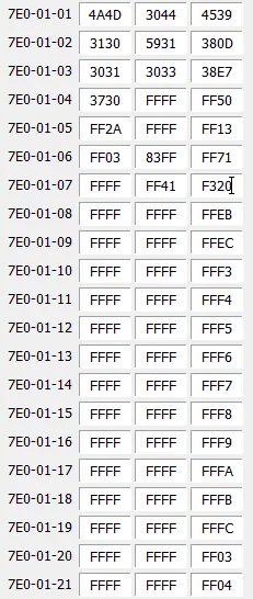

Code is OK. If you don't have the wires in PCM is not going to work. Doesn't even give you an error. Take a close-up picture of the PCM, in special the right connector and post it here. Let's identify the wires.
Just wanted to spell out the coding part since it took me a whole day to understand and maybe others are as dumb as me. Here's the conversions and math:
If line 7 is F11E and you change to F320, you have to modify line 25 to offset that change.
So,
Convert your line 7 into decimal using this:
Hex Decimal
F11E = 61726
F320 = 62240
Find the difference between the two decimal numbers:
62240 minus 61726 equals 514
Convert line 25 into decimal:
040D = 1037
Since line 7 was increased by 514, we need to subtract that:
1037 minus 514 equals 523
Now convert 523 into hexidecimal using this:
523 is 020B in hexidecimal.
Entering 020B in line 25 is what I needed to get my setup to work, your car may be different as your line 25 may be different.

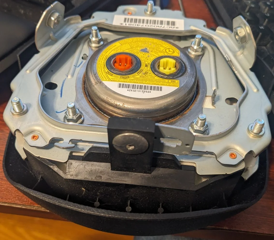

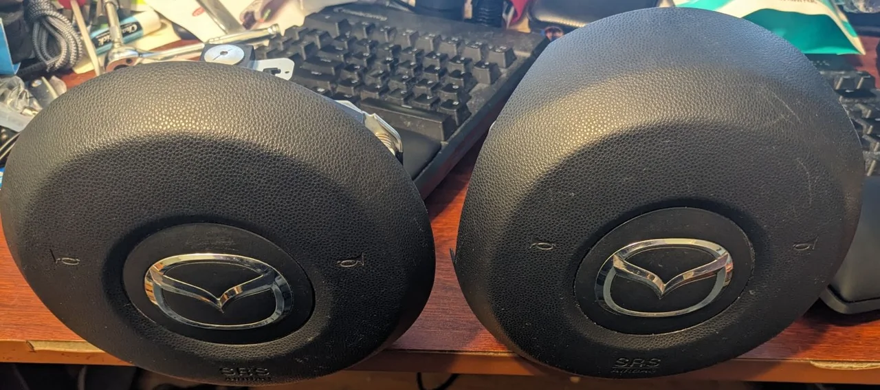

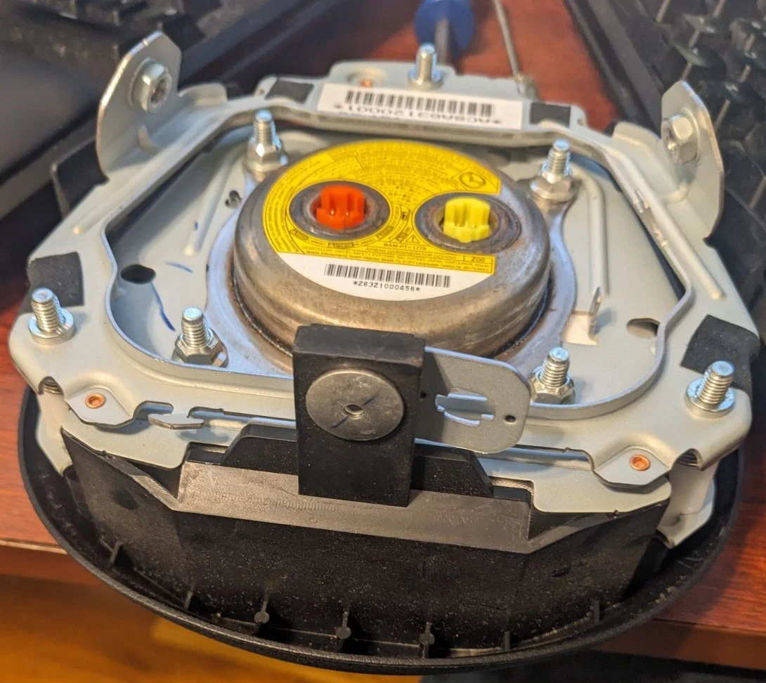

Also wanted to note a trap with this mod: the airbag is superficially different and doesn't fit if you're going from a no option sport to having cruise or radio controls.
The one on the left is the version that fits the cruise control wheel, the left is the base model sport airbag. The connections are identical. Also note that on both of my airbags the clip at the top has broken off that would connect your horn.
When searching on ebay for these they are commonly referred to as "with option" or "without option" to denote with cruise/audio controls or without.
For whatever reason mine is messed up and refuses to not sound the horn all the time. I suspect I have the leads reversed but I have been sick and sleeping during the day so for my neighbor's sake I haven't done the troubleshooting.
Edit: I had the leads swapped for the horn, all is working now and airbag light is cleared.
"With option"
"Without option"

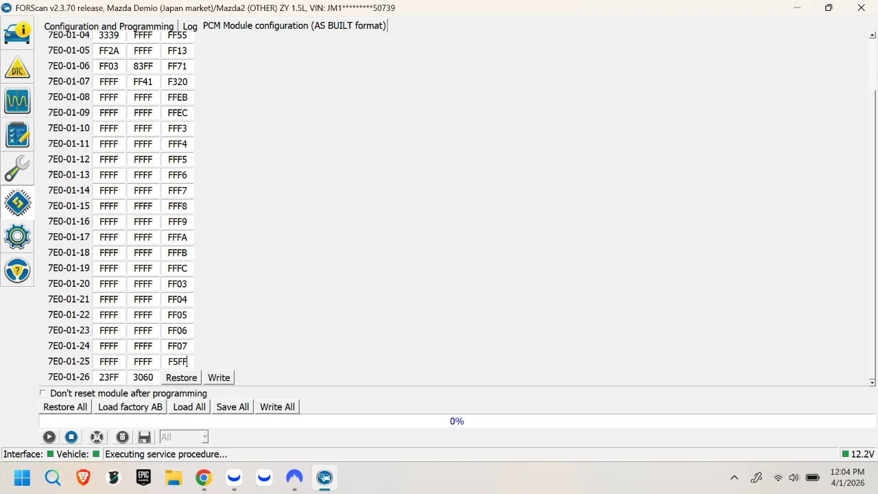

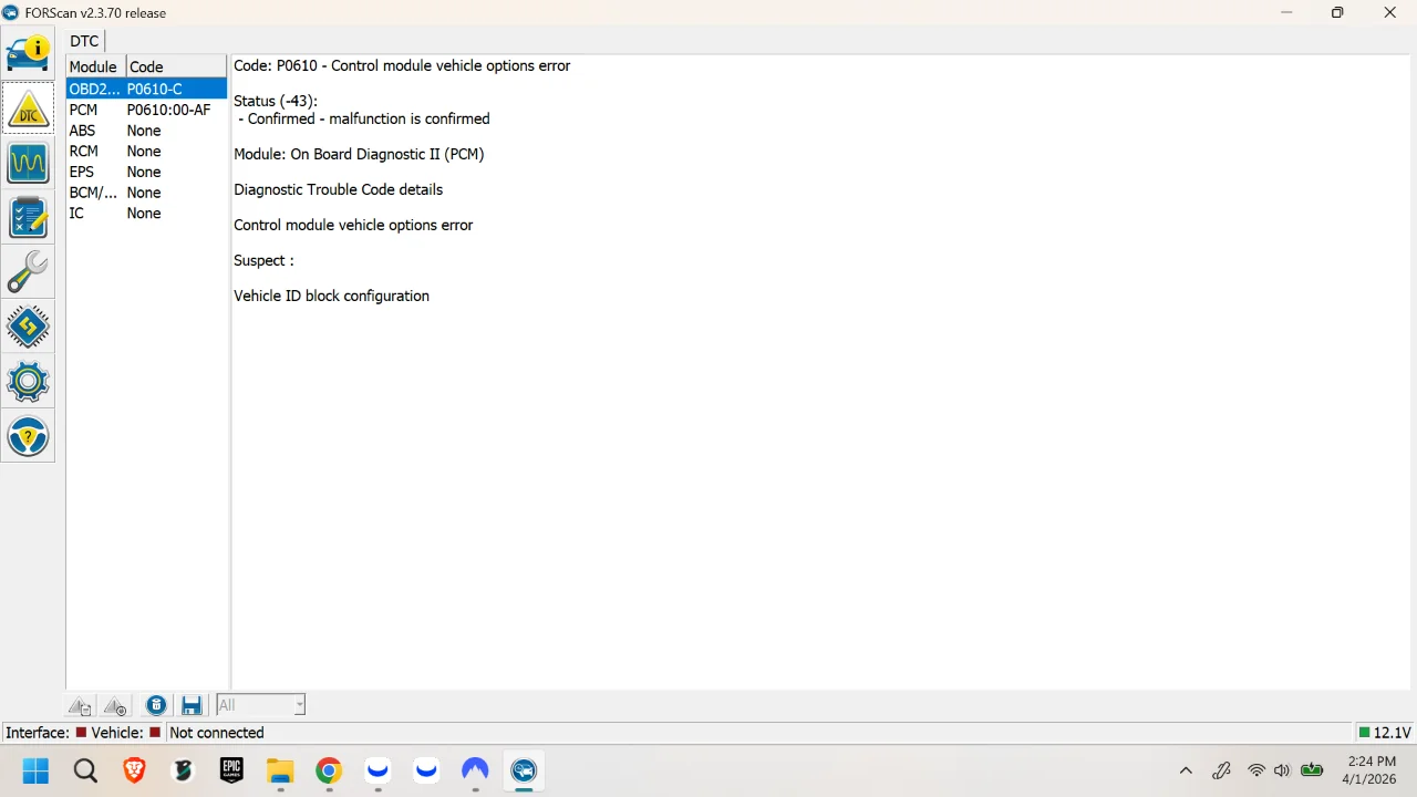

Hey everyone, I am struggling trying to get my cruise control to work as well. I have attached some images, 1st is the PCM prior to making changes, 2nd is after making the changes, 3rd is what line 25 is recalculated to after i select "write all" and the 4th picture is the connector on the back of my clock spring. I believe my new values are correct but when I test out the changes the cruise control light does not appear and I get a check engine light. The code for the check engine light is P0610, see last picture. I have a 4pin brake switch and have done an illumination test and verified my dash does have a cruise control light.
Any suggestions? Do I need to do some wiring?
I believe I needed to click the "Write" button, next to restore to get it to save properly.
It appears that your checksum value changed to F5FE but needs to be F5FF.
Reload the factory default then change both line 7 and 25 at the same time and use the "Write" button then "Save All" and back out and try. The cruise light should turn on even if you're just sitting there which *should* indicate you've done it correctly.
Hi, thanks for your reply. When I change line 25 to F5FF and hit "write" forscan will automatically change the value of line 25 to F5FE and it leaves line 7 at F320. I just tried doing it again and it did the same thing and gave me a check engine light with code P0610.
Can you re-load the factory defaults and clear the code?
