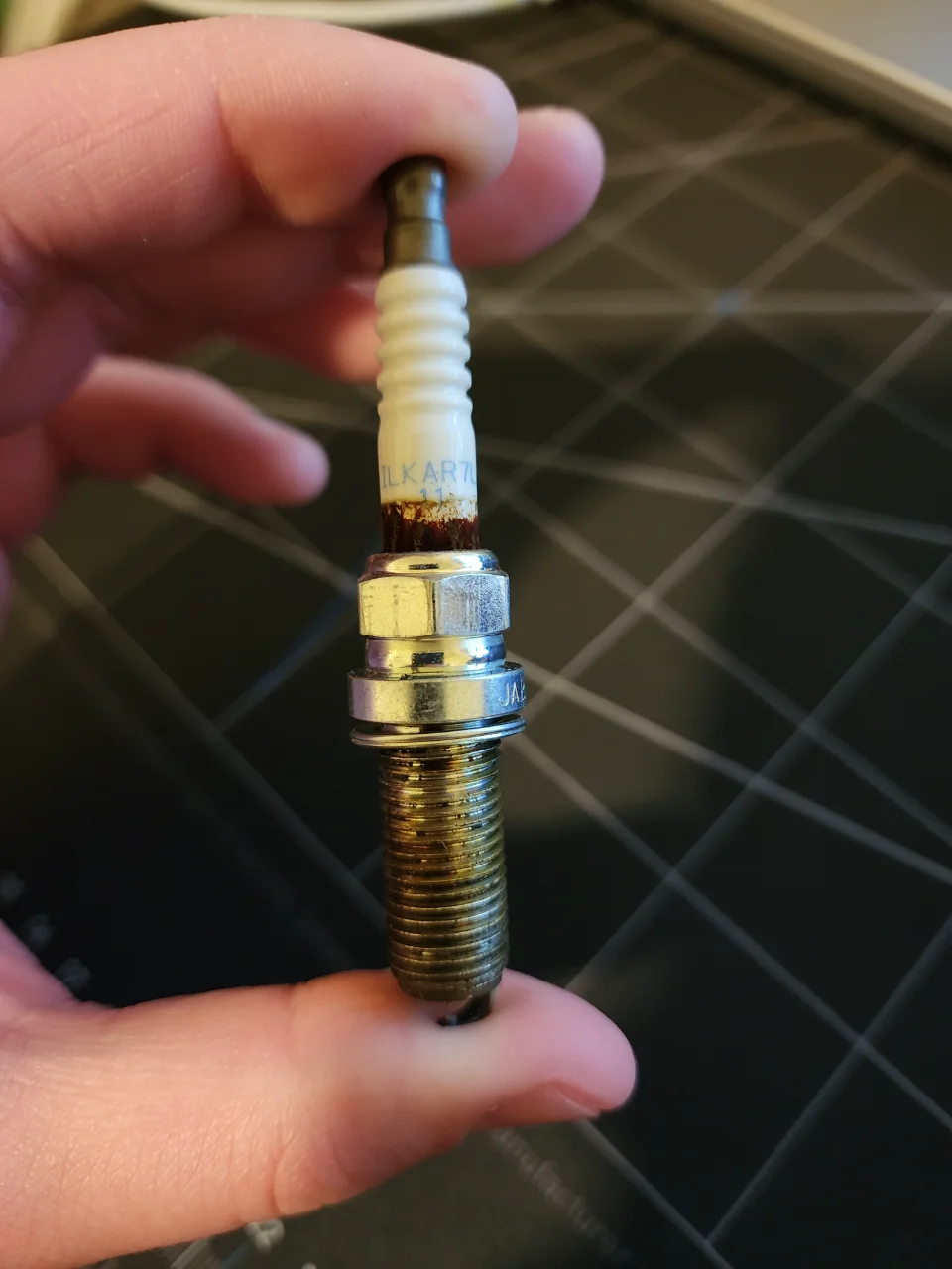

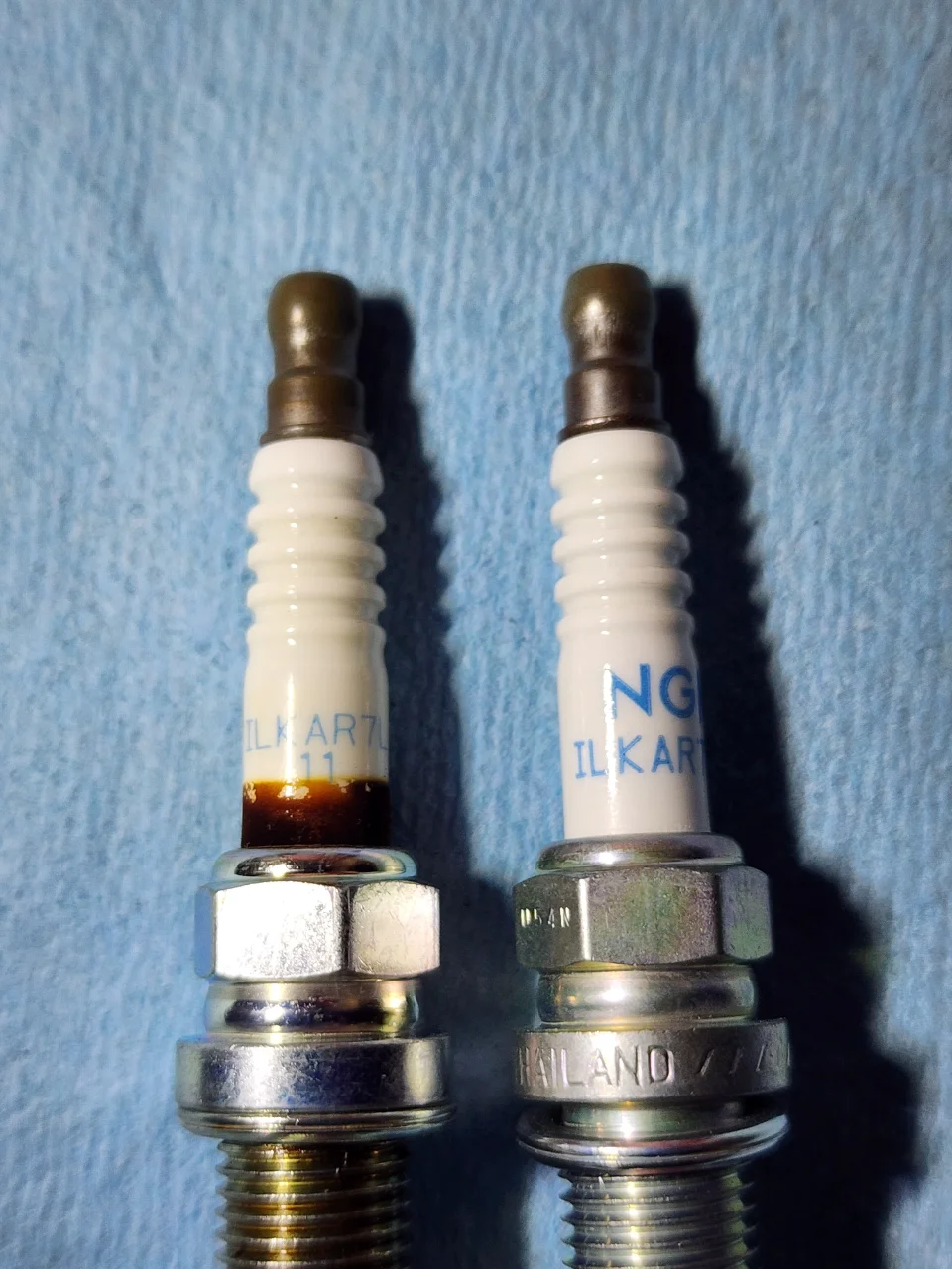

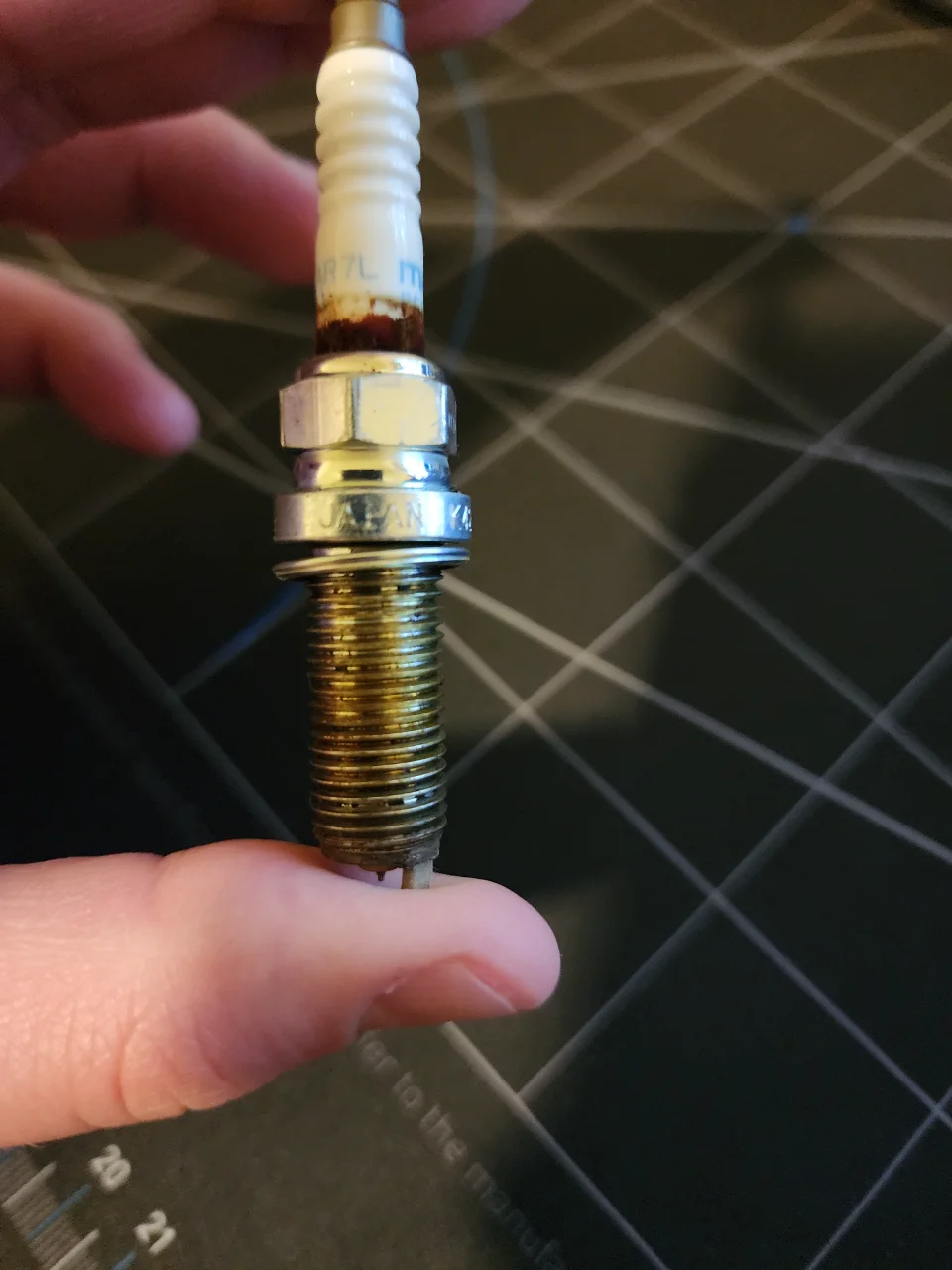

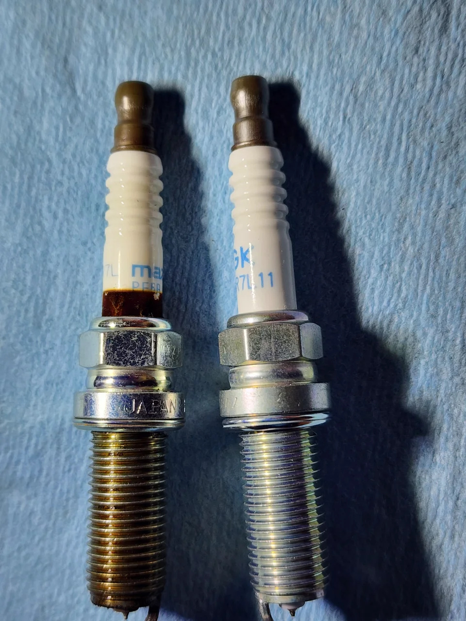

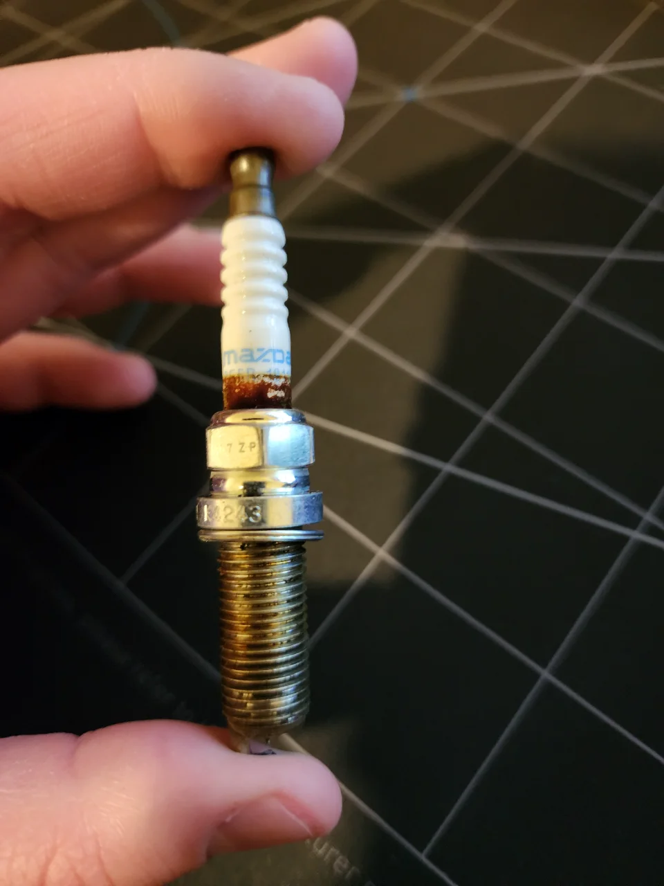

Hi all,
Finally got around to changing the spark plugs today.
As I thought I remembered, the Mazda OEM spark plugs I purchased from Med Center Mazda for my 75k change indeed also possessed NGK's "ILKAR7L11" branding / model number.
Physically these looked identical to the brand new NGK ILKAR7L11 94124 spark plugs I purchased from Rock Auto for my 150k mile change.
The only other difference I could observe was that the Mazda plugs were stamped with "Japan" while the NGK's were stamped with "Thailand".
Otherwise...seems like the same exact plug to me.
Also, protip - the $20 Pittsburgh Locking Extensions worked great for this as did https://www.amazon.com (commissions earned). Was very easy. The coils looked dry so I did add a little dielectric grease to them before reinstalling. And as per the recommendation by NGK, no anti-seize was used. I had no problems removing the old ones.
