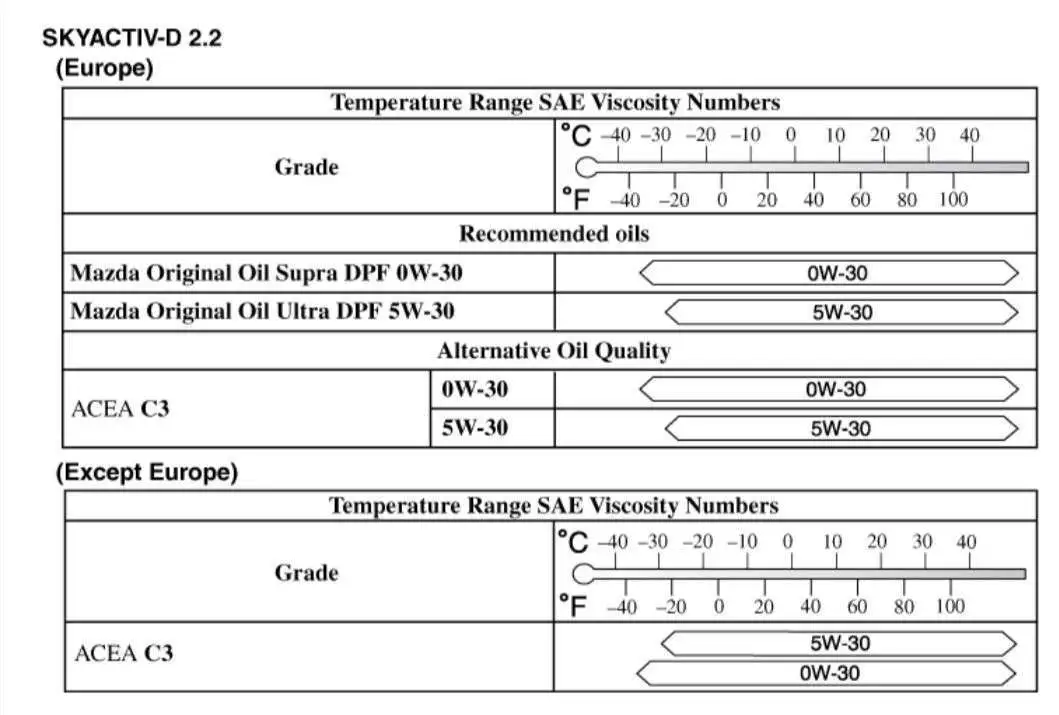

Here’s oil viscosity chart from Mazda CX-5 Owner’s Manual world wide:
Upvote 0
thanks for the charts, basically what it shows in the manual. 5w30 apparently is good till -30C. Up here winter is coming and -30 does happen. So probably best to keep what is "normal" spec for the engine. I do have an oil change coming up and figured using the 5w30 already stocked in my shop would be easier than going to buy another jug of 0/20.
