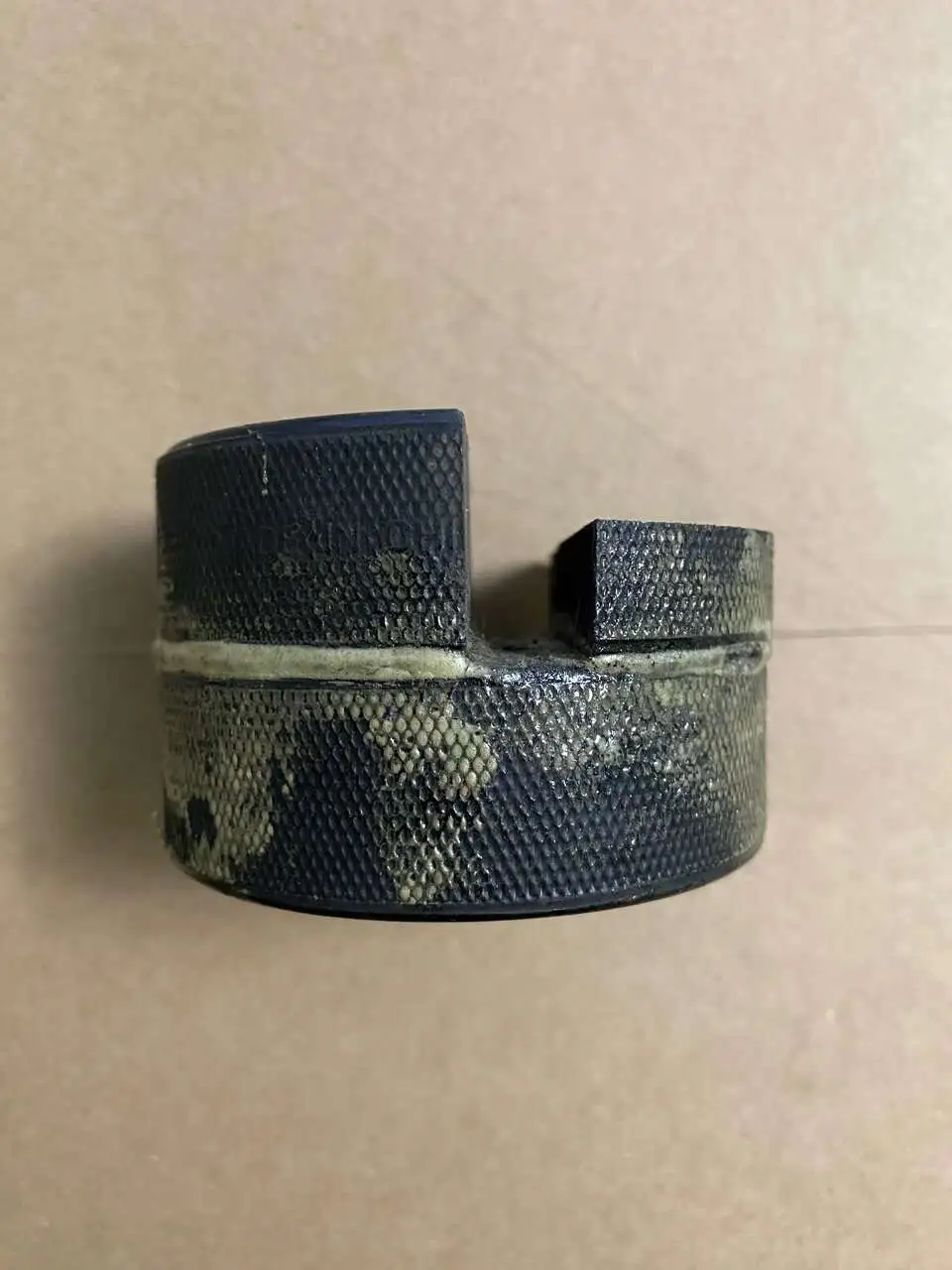

I used two pucks. I sliced one puck into two pieces on the band saw, and then glued (cyanoacrylate glue) and screwed the sliced portions onto the top of the second puck. This gives you a thicker pad with a one inch (depth) slot. It works well on my floor jack for both my CX5 and MX5.

Thanks. That's a great idea. Didn't know you could glue rubber to rubber so gonna try that 2 puck idea for a second set.

Great idea. Thanks for sharing. Does 1 inch suffice with CX5 application? How this set up holding up after the actual use? Any signs of disintegration or holding up strong ?
No issues at all. After using them for a couple of years they are holding up great. The 1 inch slot is more than enough.

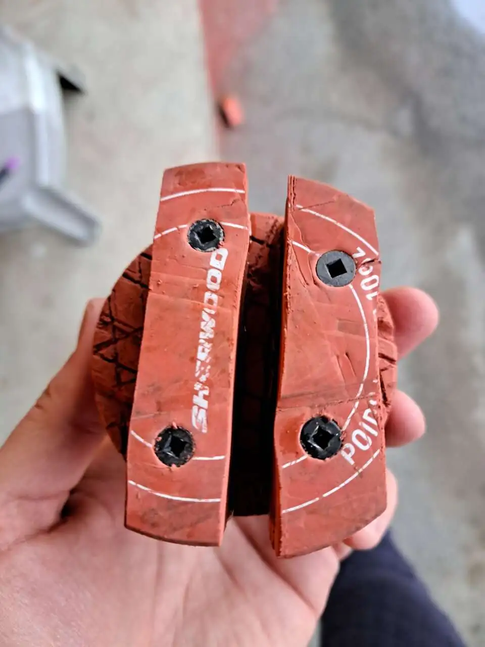

20231104_161803.webpDo not laugh. Not tested. Two packs on Gorilla glue x 1 1/2 screws
So I researched hydraulic bottle jacks versus scissor jacks versus the Toyota mechanical jack and decide on the Toyota jack that @Jmaz recommended.
Now converting it for the pinch welds in the Mazda. Cut a 3/4 inch slit in regular hockey puck so the flat portion will catch the frame but barely any puck left.
May have to buy the mass produced jack pads which are 1.3 inches thick and deepen the slot from 1/2 inch to 3/4 inch.

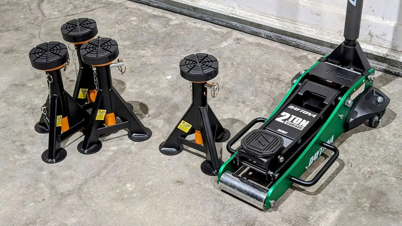

This thread as been informative. I recently got a new jack and a set of stands and did not realize things would be this complicated.
Pucks are pre-installed but I realize they won't work. They are 1" thick and the grooves are 3/16" wide. They are not solid though because they are made to fit onto/into the round metal stand, so cutting them would compromise them. And they may actually bottom out on the metal beneath.
So in addition to the stands, I need to solve the jack problem. I can jack as-is on the front and rear jack points and then place stands to both sides of the car (once I find a solution for them). But if I want to raise just one side of the car with the jack, I would need a puck for the jack like the one at Flyin' Miata.
^^^ You can use hockey pucks like I use. See post #21 above. Much cheaper then the Flyn Miata option.

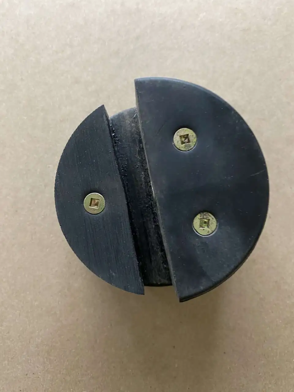

N7turbo... here is a couple photos of the hockey puck pinch seam pads that I use. These ones are glued together using polyurethane glue and a couple of screws. CA glue also works. The larger (taller notched side) of the puck sits on the inside of the pinch weld and carries the load. These notched pucks were made for my MX5 which has a heavier plastic sill on the outboard side of the pinch weld that I don't want to apply any weight to when jacking up the vehicle. They also work on the CX5. I also have a couple of pucks without the notch I use on my Subaru and on my recently sold CX5.

The hockey puck approach still scares me. I went with the aluminum pinch weld adapter with magnets the stick to the car. You just have to remember to remove it when you finish the last lift.
