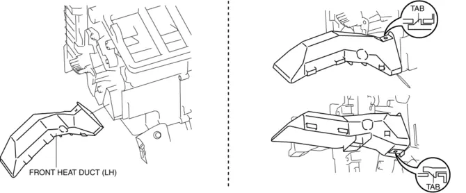

Thanks cz5gt! Those pics align with what I thought would work but no joy. I found actual duct photos on eBay and see there is a second hidden tab at the top. I'm going to make a tool to depress it and give it another go.
May be try to twist the duct up (as in 3. above) to see if it will disengage it. It could be the upper tab is just a "holder".
Hi cz5gt, 3 above is what I meant by pivot in my original post. I don't understand why it won't budge so I'll try to depress the hidden tab to see if that helps.
Hi cz5gt, just found this pic which shows the hidden tab. This design could prevent the upward pivot/rotation.

based on this design shown, the upper tab should unlock automatically when the vent is tilted (after unlocking the bottom one).
But if it doesnt its either stuck or needs more lifting force to push the upper tab. Strange that it doesnt move.

Hi cz5gt, from what I can see, there is a spigot (ie. pipe inside pipe) that fits inside the duct plus there is a vertical end flange on the duct next to the hidden tab. The tab is only ramped for assembly not disassembly. These design features would dictate that the hidden tab needs to be depressed for disassembly. I'll let you know how I make out. Thanks for your help.
Success! Depressed the hidden tab and duct came out easily. Finally, I can actually check the actuator function. Take care cz5gt and thanks again!

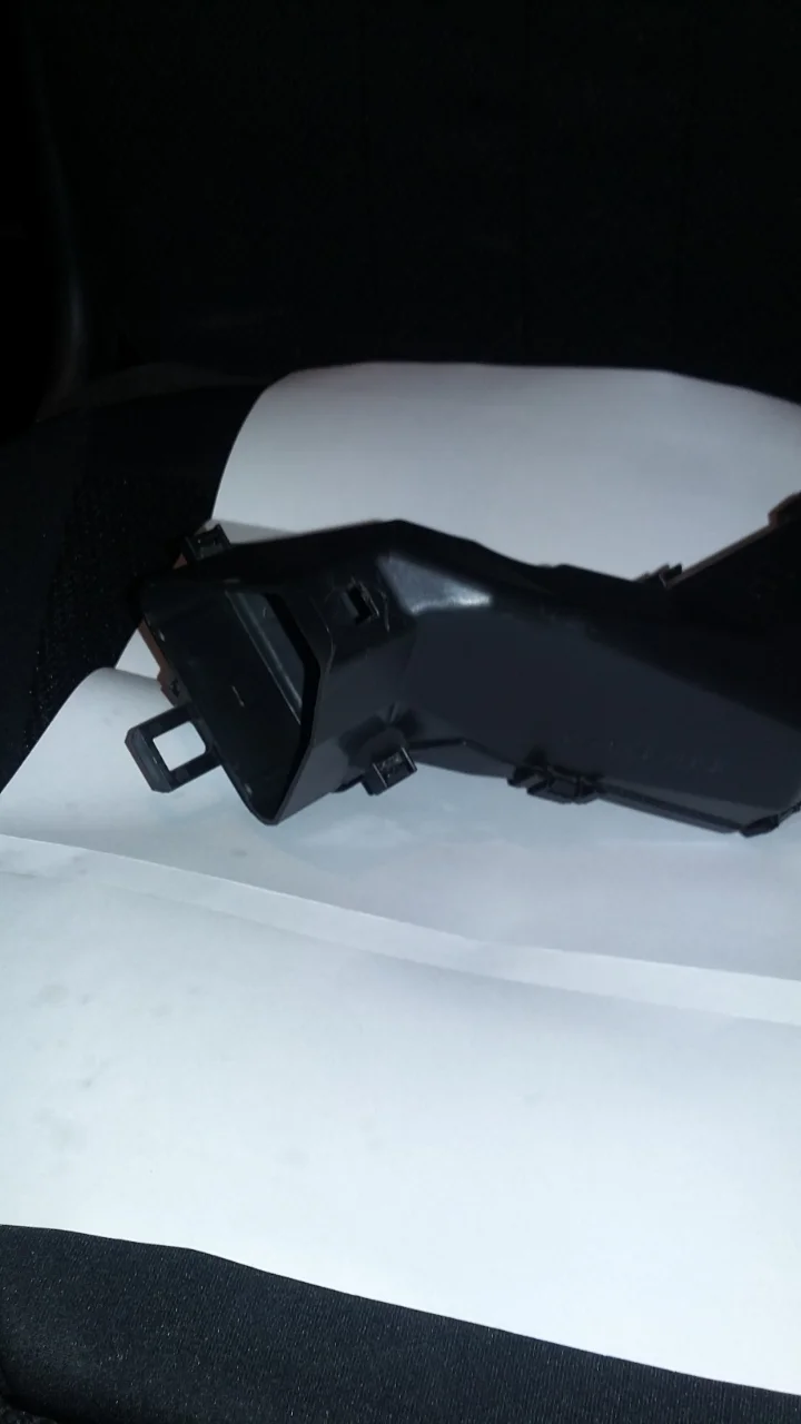

Actuator Function: With the AC running at its coldest (15 deg.C), I marked the door arm location and then I removed the actuator. The door arm could move another 1/8" colder. Therefore, the door was allowing a small amount air from the heater core to enter thus explaining my issue. Now to figure out what I can do about it. I'm wondering if there is a reset or calibration function available. Does anyone know?
