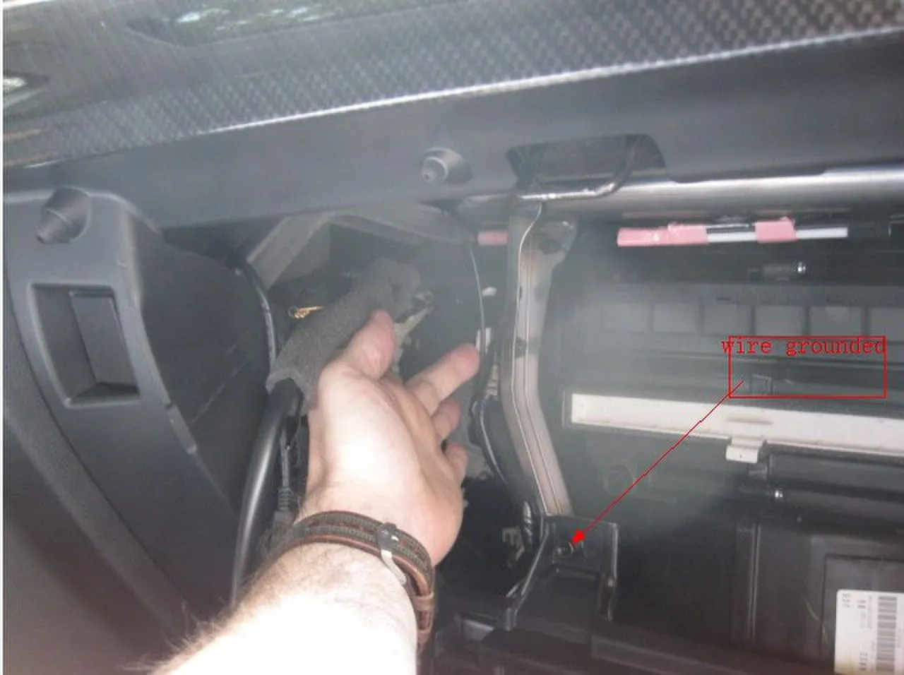

For ground wire, I found the easiest way as PIC shows since the front and the rear metal are connected. I also did not remove the negative battery cable.

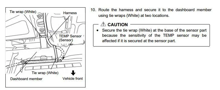

Ok, so after studying your directions and the provided directions, I only have one question about the installation......
Where exactly is the temperature sensor located?
The temp sensor plugs into the wiring bundle that connects the main remote starter unit to the car up above and behind the glove box.
This picture shows where it plugs into that wiring bundle.
