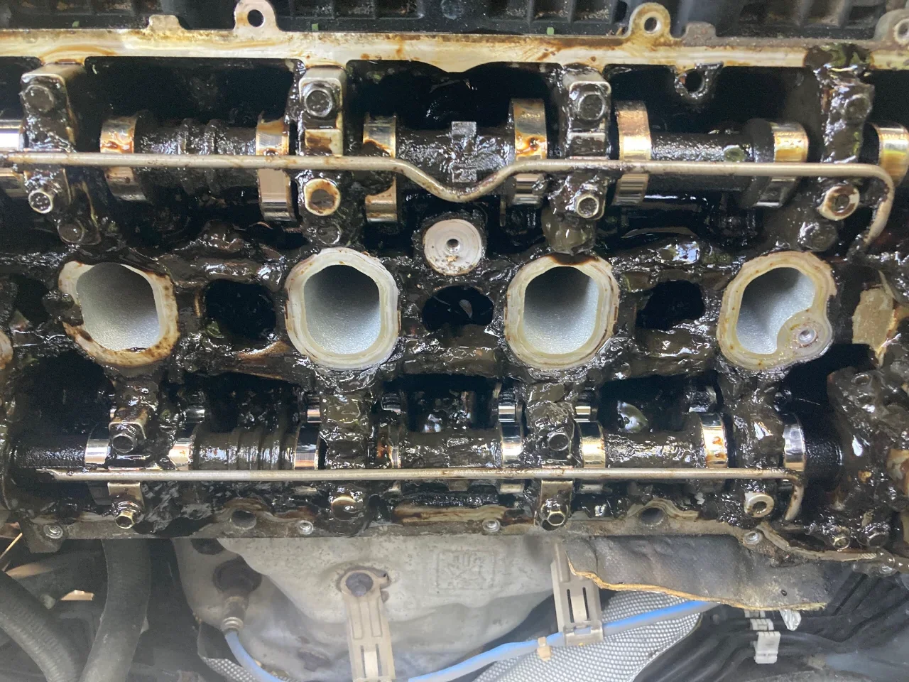

Hello,
I have a 2014 CX-5 that has had an internal coolant leak. I'm not sure from where, I have to refill the coolant reservoir every 400 miles. I did a block test that showed negative results, a shop did a coolant pressure test and held pressure, I had the oil analyzed and the results showed coolant in the oil. The engine has significant sludge buildup, and the engine has developed a concerning noise. A loud ticking that is most evident after letting off the accelerator and RPMs are returning to idle. I replaced the VVT solenoid, but that did not fix the ticking issue.
While performing the VVT solenoid replacement, I was able to see the condition of the engine under the valve cover. It made me lean towards a full engine replacement. I was wondering if anyone has advice on that process or has done it? I've contacted a few shops and they're all in the $7-9K for a replacement Jasper engine. The car is only worth $7,500 according to KBB and JD power, but I like the car and besides the engine the car is in good condition. I'm on the fence about fixing this car or buying a new one.

That is one nasty engine. That is what it looks like when oil is not changed for a long time. Or ever.
The ticking may be a HLA (Hydraulic Lash Adjuster): 2018 CX-5 GT Outer Hydraulic Lash Adjuster Knocking - Covered out of Warranty?
I was going to say that the coolant in the oil is what I would be most worried about. But that sludge...I'm not sure how to clean it out. And if any damage was done by not having proper clean oil in the engine for a period of time. The only way to find out would be to disassemble the engine and run everything through a parts cleaner, but that and reassembly would be a good amount of labor.

The inside of that engine looks horrifying.
I think... Start by cleaning out that engine. And changing your oil on time.

By cleaning, do you guys mean using engine flush type of products? It would be interesting to see the improvement after a few rounds. 🧐
I mean taking the engine apart and putting them through a parts cleaner. Complete chemical removal of the sludge like it never happened. No guarantee there won't be any scored bearings.

That would be the right way to do it, but what do you guys think about doing oil changes and engine flushes until all that crap comes out?
Also, OP mentioned that there is coolant in the oil, but I'm not seeing much of that in the photo if any, just one horrifyingly neglected engine, which should well explain the ticking sound OP has complained about.
If I were the owner I would try to save this engine, and never neglect it again.
