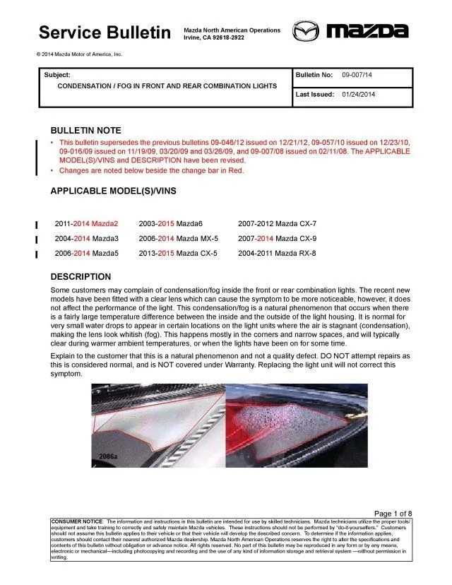

NEW / UPDATED TSB FOR CONDENSATION 2013-2015 CX-5!!!!!!!!!!!!!!!
Dated 1-24-2014

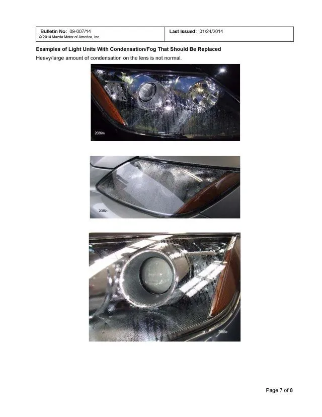

I've attached a couple pages of the TSB in picture format (sorry, that's all I have access to) and it's 8 pages long.
FYI, it says to NOT FIX/REPLACE the lights. They give picture examples of what is normal and what's not and which type of condensation gets a replacement.
