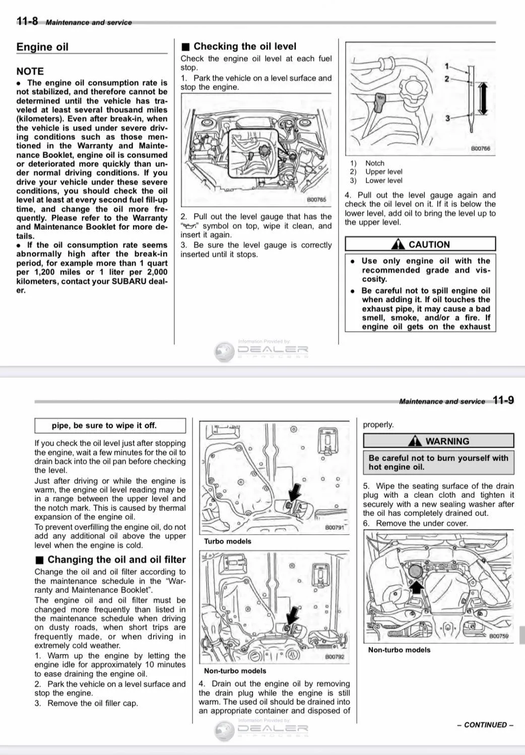

My Subaru had two MAX levels, one for cold and one for hot. 2010. Ed
I checked the 2010 Subaru Forester owner’s manual. There’re 3 marks on the dipstick:
1) Notch
2) Upper level
3) Lower level
And
“• Checking the oil level
Check the engine oil level at each fuel stop.
1. Park the vehicle on a level surface and stop the engine.
2. Pull out the level gauge that has the “ ” symbol on top, wipe it clean, and insert it again.
3. Be sure the level gauge is correctly inserted until it stops.
4. Pull out the level gauge again and check the oil level on it. If it is below the lower level, add oil to bring the level up to the upper level.”
“If you check the oil level just after stopping the engine, wait a few minutes for the oil to drain back into the oil pan before checking the level.
Just after driving or while the engine is warm, the engine oil level reading may be in a range between the upper level and the notch mark. This is caused by thermal expansion of the engine oil.
To prevent overfilling the engine oil, do not add any additional oil above the upper level when the engine is cold.”
So it’s very clear that when you check the engine oil level cold, use the “Upper level” mark for full oil level.
