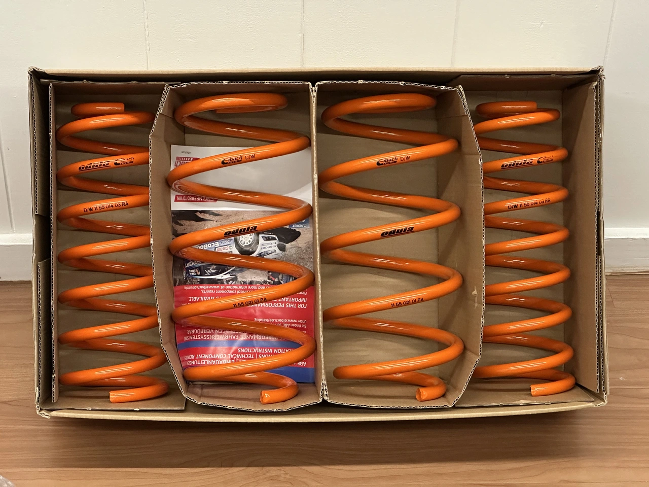

From what I understand, Odula wanted a drop similar to the Eibachs but maintain the performance and ride quality. So, they had Eibach custom wind springs to their specs.
For the TLDR version, here are the specs...

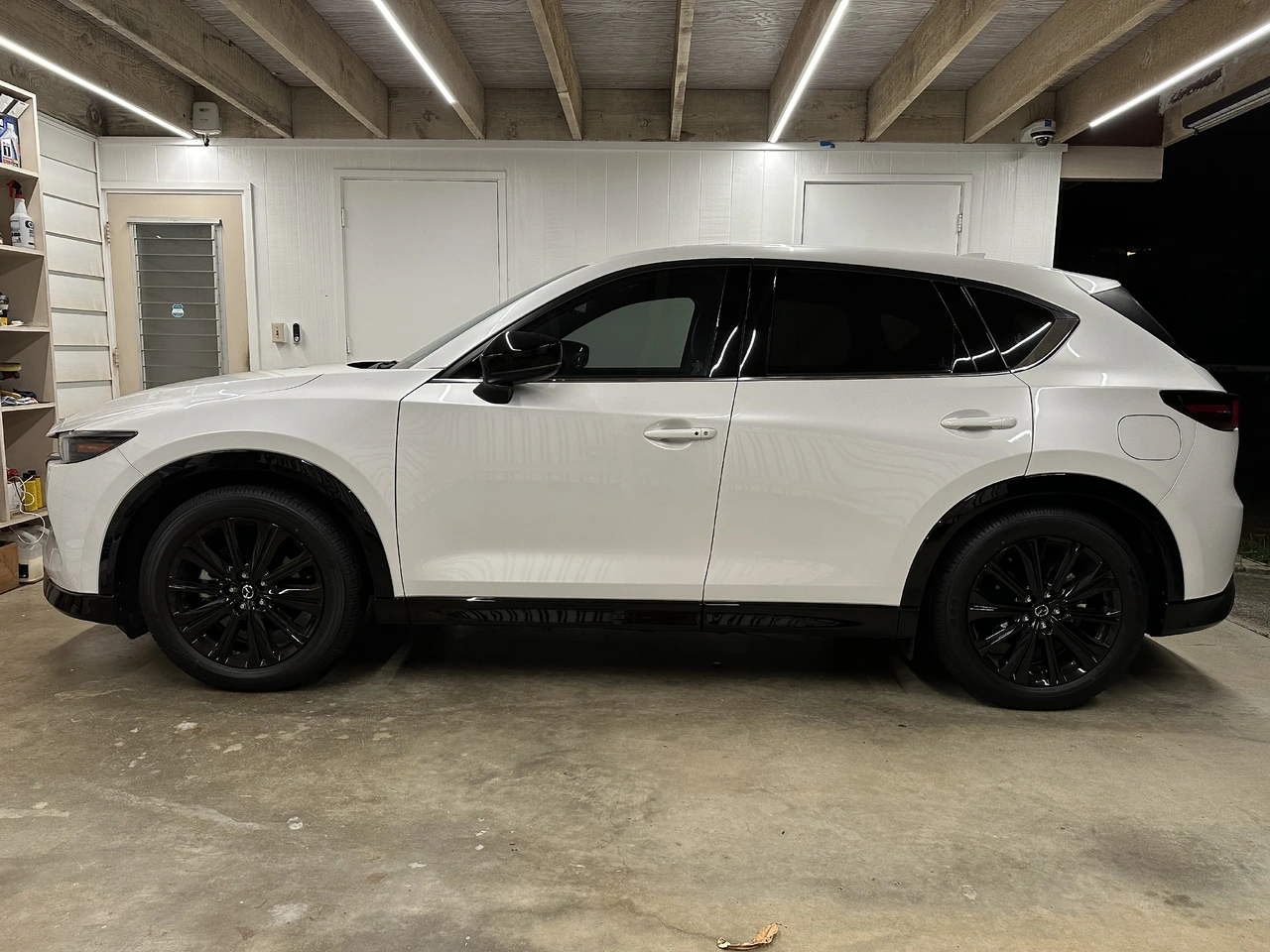

So it seems like I was NOT supposed to trim the bumpstops. The rear came down way more than 40mm. I’m going to try put back the piece I cut tomorrow and see how that changes things.
The spring rate and length were probably calculated with the bumpstop. My previous 5 (think Premacy not CX-5) was the same way. H&R said not to trim the bumpstop as it was part of their calculations.
Fronts seems ok. Measured 17” from center of wheel to the fender. Rears measured 16.25” from center to fender. Probably should have measured before I started.

The bump stop won't affect ride height unless you're talking about riding directly on it--which you don't want to do. The bump stop gets trimmed so you don't hit it, which is unpleasant.
That does look like more than 40mm though.

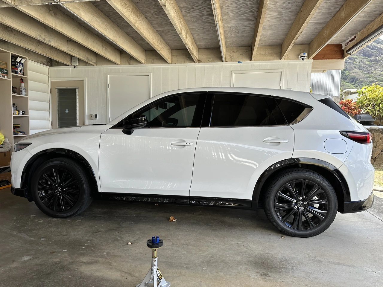

Put the cut pieces of the bumpstops back in the rear. Pretty much confirms that it they were not supposed to be cut. I guess I’ll be ordering replacements so that’s proper. Then get it aligned.
It depends on the drop. Corksport specifically instructs you to cut them for their 2" (51mm) lowering springs. If you don't, you will hate the ride.

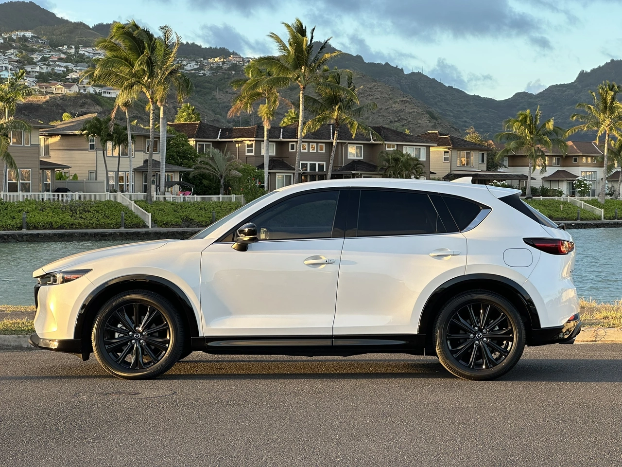

Install new OEM bumpstops for the rears. Ended up grabbing from the local stealership. This is one of those time where I can't say, "Lucky we live Hawaii". Man was it expensive! Guess I could have ordered from mainland but still would have to pay shipping.
Anyway.... No change in ride quality vs with the cut pieces. Maybe a few mm in height in the rear. Here is a pic I took down the street from where I live.

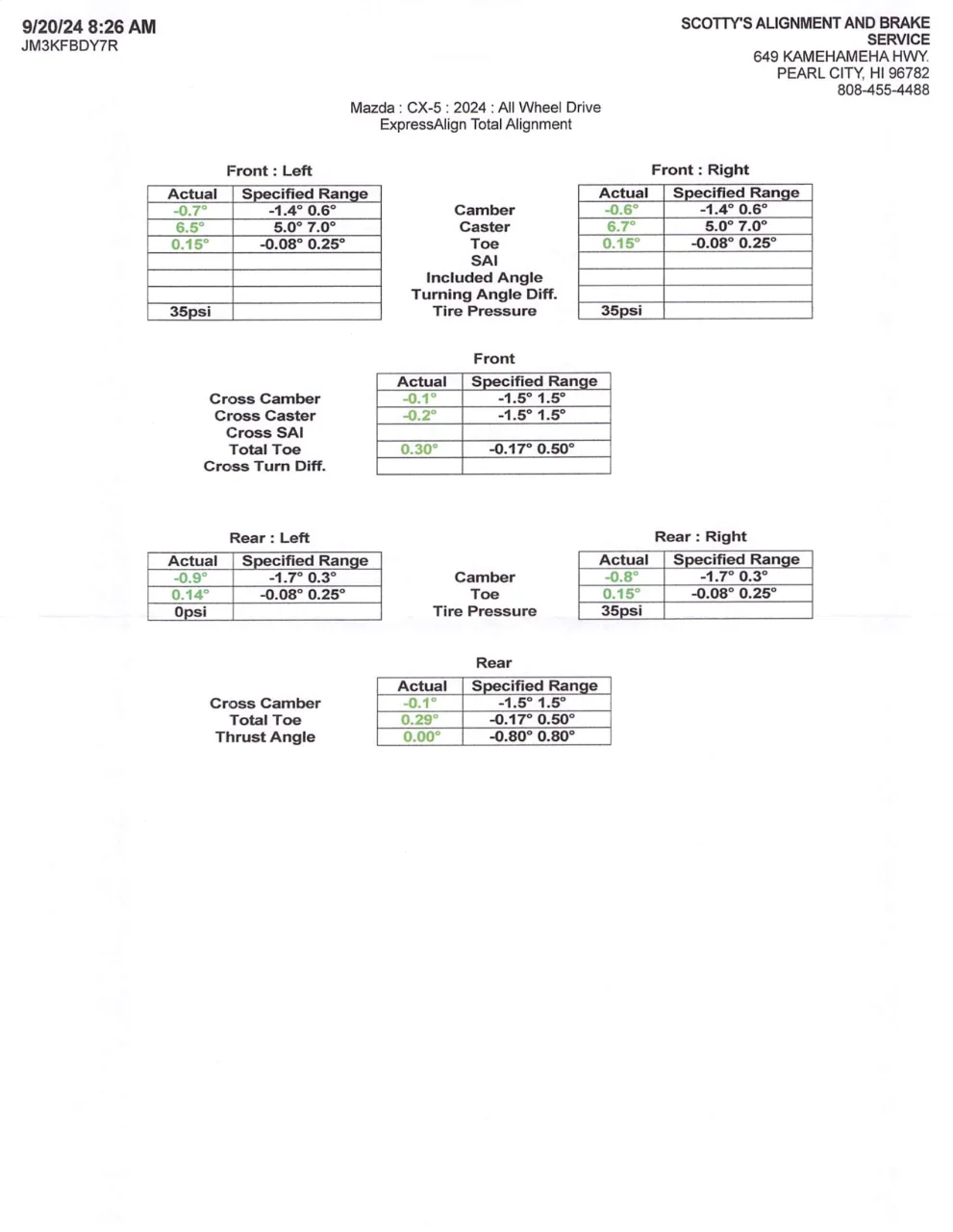

Here is the alignment...
Used the Megan Toe Arms to set toe and the factory toe eccentrics to pull out camber. Sorry didn't get the before printout. They were able to pull camber back from about -2.4°. So for those that have a mild drop, the toe arms may be an alternative to camber arms. No need to drop subframe.
For those of you in Honolulu, Hawaii, Scotty's is the best.
Nice. I used the LYKT control arms and got my rear camber down to -0.75° with a 2" drop. But interestingly, even bone stock I had visible negative rear camber. Must be how Mazda set it up.
