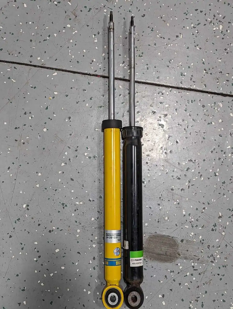

The Bilstein shock tubes and shafts are about an inch longer than the stock ones.
The difference was enough to make us confirm the model number of the shocks to make sure they were for the CX-5 (they are). My guess is that Bilstein was probably thinking that owners would be lifting these, not lowering them.
We also confirmed the travel of the shock wasn't internally limited, its not.

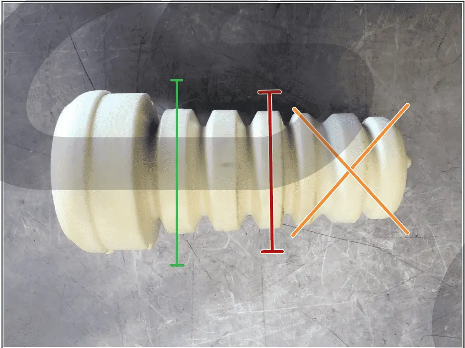

We cut the bump stops to the green line. note that this is the last rib that the dust cover (painstakingly) attaches to.
The ride is much much better now, and feels like it should. Also the rear end lowered to where it looks like it's supposed to be.

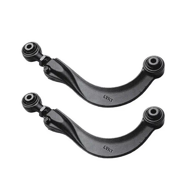

Did you change out the rear camber arms with something like JBR's?
I originally got some godspeed rear arms. Then right before the original install, with some help from someone on reddit, found some more oem-ish ones and used those instead.
