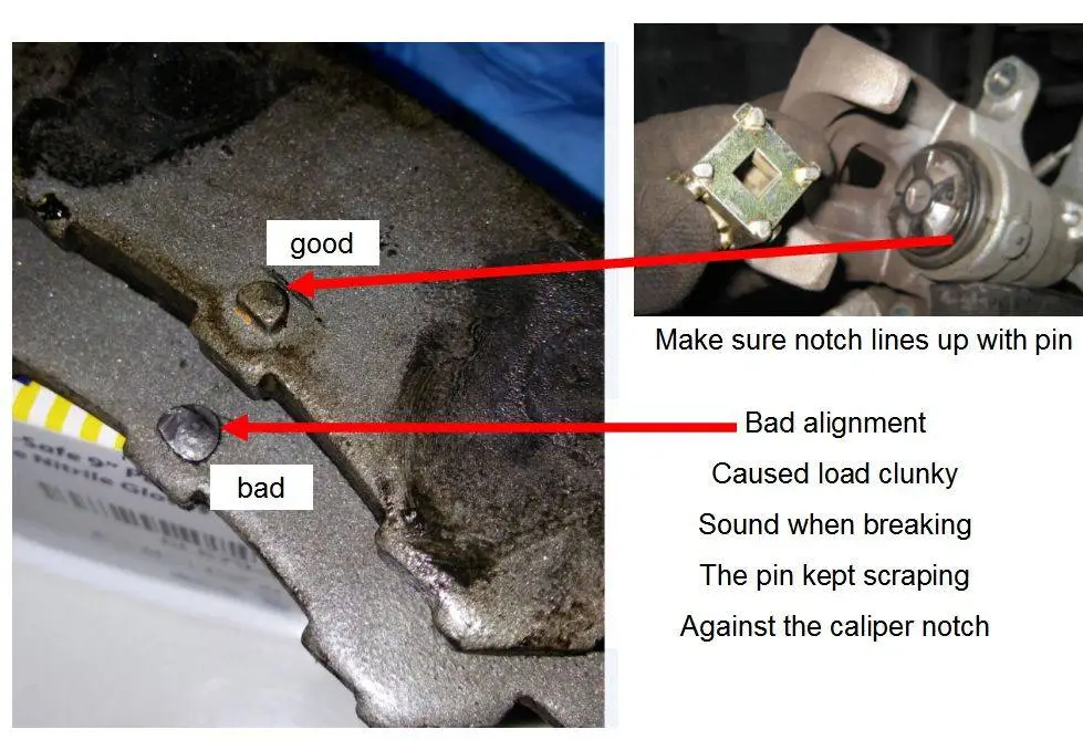

If you don’t feel right when you step on the brake pedal, try to put the rear brake in maintenance mode again, and get out of it. May be a couple of times.
The piston’s grooves have to be lined up in perfect North South orientation:
If you haven’t, read this thread first by tomcat1446:
Maintenance Mode for 2016/2017 CX-5 electronic brakes
