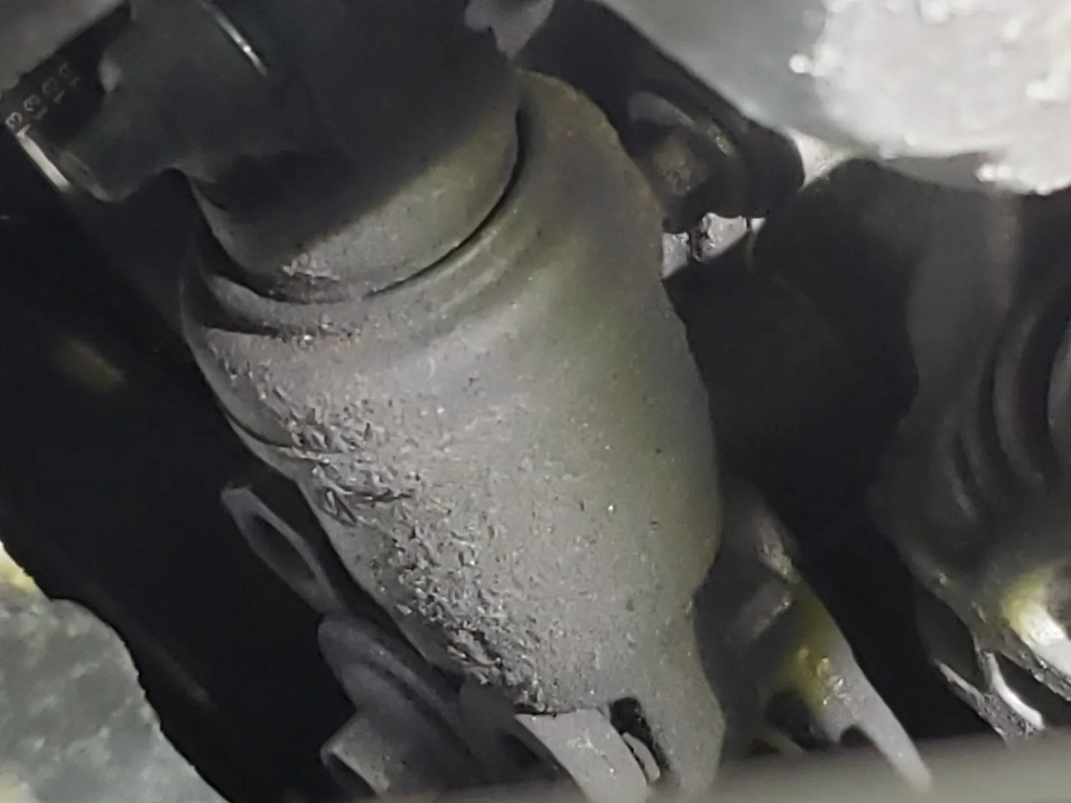

This is a picture of my dirty tensioner. Leaking? Beats me, but it makes no noise.
And after removing the tire and the splash shield, here is the view. Lots of metal in the way of where you need to get too. Tried both from this angle and the top before I gave up. Can't imagine that the standard shop time for the swap is .4 hours of labor!

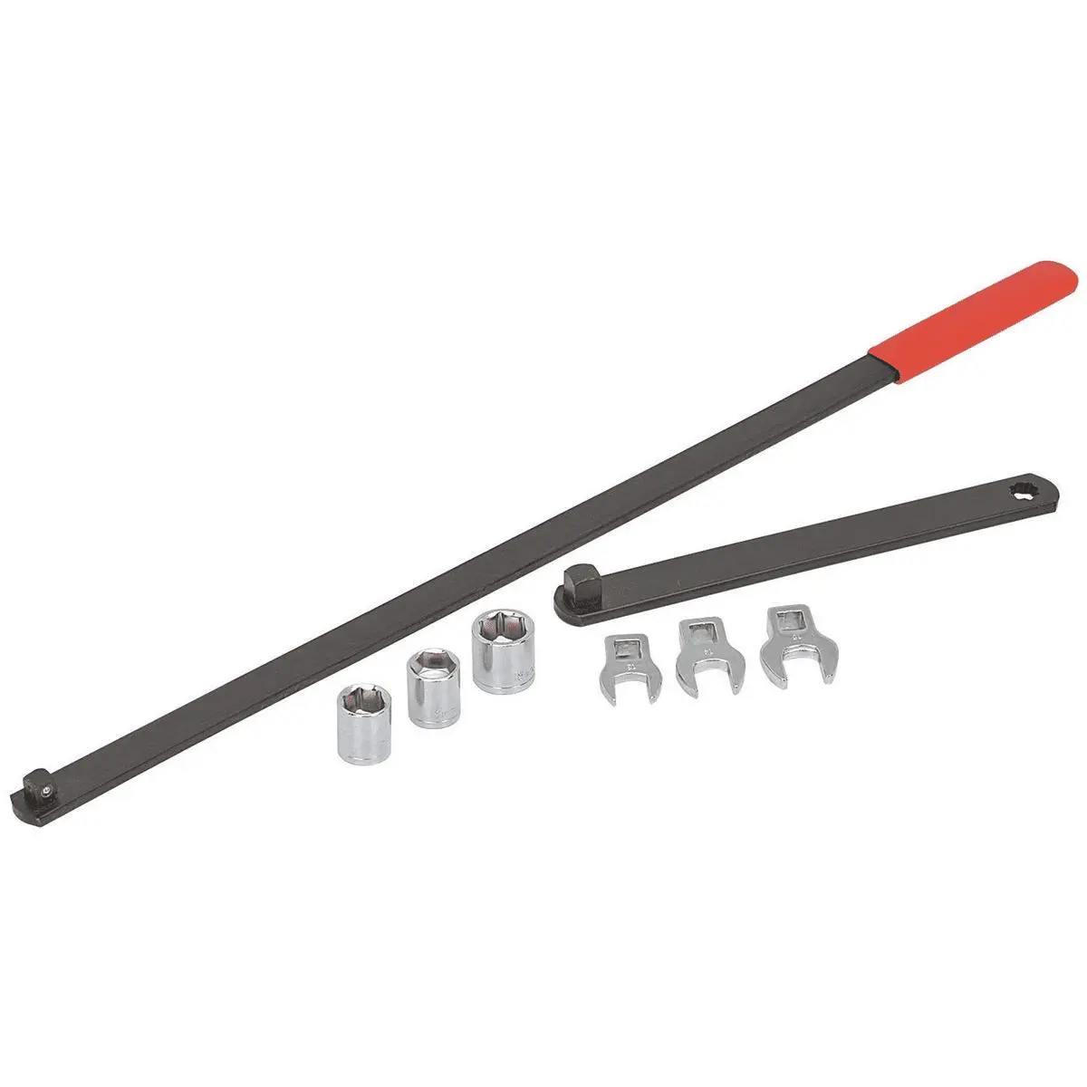

Not a failure lol. You need the right long reach wrenches for leverage or be pretty strong. I purchased a long reach 17mm wrench as shown a couple posts back. For anyone wanting to remove the tensioner just get a kit that contains both the 17mm and 12mm wrenches. And not just long reach but Extra long reach.
Something like this https://www.amazon.com (commissions earned)
Interesting. Your package has part number PET2-15-980, but the tensioner itself says the part number is “PE03-15980 K0255” (PE03-15-980) with serial number “F-569897.10” ⋯
Clarification:
The actual Piston section and facing engine bay says F-569897.07-0100 with date 12/18/2018 but bottom half with roller and facing engine says F-569897.10 with date 12/20/2018.
Must've been assembled in different areas of the plant an on different days to be bolted together.
Another case of a ULT? :) Unidentified Leaking Tensioner
Any chance we can use a breaker bar/socket in there or is there not enough clearance?
FYI, HF sells the long reach metric wrenches for $24.99 if anyone wants to save money :D
Metric Long Handle Combination Wrench Set, 11 Pc.
Sizes: 10mm, 11mm, 12mm, 14mm, 15mm, 17mm, 19mm, 21mm, 22mm, 24mm, 26mm

The tensioner is right up against the engine bay. Space is really tight. You'll need wrenches with a box end.
The HF long reach metric wrenches............trust me you want to go longer. HF's long reach 17mm wrench is 12 inches whereas my extra long one is 16 inches. You could join two wrenches together but with the tight space I prefer the specialty extra long reach wrenches. That said the HF 12mm long wrench is 9 inches is actually not bad. I don't have the strongest arms therefore I'm looking for a 12mm wench at least 1 foot for more leverage.
Here's the 12mm one I'm thinking of getting: 12mm extra long box end to remove the bolts.
Here's the 17mm I currently have. Perfect for releasing Tensioner tension: https://www.amazon.com (commissions earned)
Edit: the reason why Mazda techs and mechanics can get away with using standard sized wrenches- Its because they have the car lifted up. They merely use their body weight and pull/push from below the car. For us DIY's were crouched down inside a wheel well having to use forearm strength. Not fun :(

The wrench I tried to use is 18" long. It has a ratcheting, swivel head with a splined profile insert. The ratchet "catches" after just 4 degrees of movement. https://www.amazon.com (commissions earned)
From the top, I managed to engage the 17mm tension relief hex thing from the top, but there wasn't enough freedom of movement to ratchet even once. I couldn't budge the tension relief at all. Hooked it from the side through the wheel well and again couldn't budge it. I must be too weak. I do think it would be easy enough if it was on a lift. I'm retired and I have enough money, so I'm OK hiring a younger guy to do what I can no longer do! :D

Thanks for the video. At about 15:20, he has a serpentine belt tool and I found it on Harbor Freight. Looks like there's no need for a offset box wrench if that's the case since the tool is slim enough to fit in the crevices. Maybe the only issue that we'll run into is torqueing it down.
Serpentine Belt Tool Kit
Look at a bunch of those online and the common complaint was they broke. Twisted the square socket head right off the body of the tool.
I went through a few of these wrenches on Amazon/Lowes/Home Depot and they had mostly positive reviews, same with HF with the last 1 star review from 2019. I wouldn't read too much into it honestly, there's going to be bad reviews about everything online. Anyways, my plan was to use a flare nut crow foot to see if it'll even fit in the tight space. I'm thinking it will fit so I don't need to buy any more tools but we'll see.
The biggest issue I have with the offset/box wrenches is that it's going to round/strip the bolt head and if that happens, it'll be a huge PITA to remove/extract the bolt and I won't run into that issue with a socket or a flare nut crow foot. Difference is that the box wrenches are 12 point vs a flare nut/6 point wrench having less of a gap
