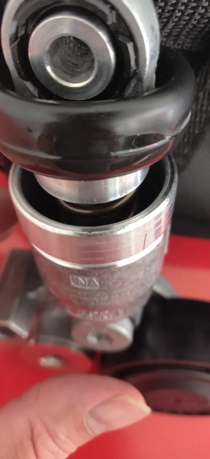

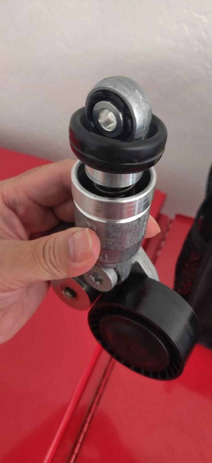

I inspected my new backup OEM INA with numbers F-569897.07 on the metal part and F8435-14 on rubber cover. The rubber cover can be removed easily. In fact, if you pinch the edges of the top or bottom part you can make some oil spill out. It is on snug vs really tight.
I opened it and observed transparent very thin oil like baby oil or mineral oil. Odorless. The oil only fills up no more than 1/3rd of the chamber. No higher than the INA stamped logo. I used a thick dull flathead screwdriver to help carefully replace the rubber part back.
I think I could just refill with oil if under certain conditions. I went back to this Tensioner discussion starting post #18. Here's my insight:
- I agree with the guy that the oil is more for lubricating the spring inside. I'm no expert but I'm 99% sure its not for dampening.
- Oil in there simply swishes around. Only covers the lower porting of the internal spring.
- The rubber seal is not tight at all...its snug. Air and oil can easily escape.....and if that happens then dirt can easily make its way inside possibly causing friction and messing with the tension specs.
- How the heck does a non-air tight seal dampen? The spring pressure was the same as with the rubber top off.
- dude had a 2012 model where he changed the belts and put more oil in his tensioner. He probably did not know how much oil to add. Perhaps added too much, too little?
- dude used hydraulic oil. Its not under high pressure and heat so I guess it works?
- dude did end up changing his tensioner BUT reported the spring part was intact and in good condition......it was the other components of the tensioner that failed. Not the part that has oil in it. Since he changed his belts (high mileage engine) it meant the tensioner's other component failed and made noise. If said components were still good he could've kept it imho.
- seepage seems normal, don't fret....too much at least.
- Try not to let dirt/grease build up around rubber seals.
- if in doubt, replace it:)

The Gates one "appears" to be made of higher quality. Compared to the OEM INA one (no matter the version) the Gates has shiny and smooth metal. Look at the bearing assembly on the roller vs the INA one with a black plastic circle shroud cover. The OEM INA next to it in video is old and dirty but even brand new it has a galvanized unfinished metal surface. The black top part assemble looks thicker as well. Look at the 7:15 mark of Video
Or use unicorn tears.
Actually INA is a well-known auto parts manufacture from Germany. They‘re OE supplier for BMW、Mercedes、Audi、and apparently for Mazda. I’d use INA tensioner without any hesitation.
I wonder if the Gates tensioner has a real damper inside as it looks like a mini shock absorber with a hard plastic top cap. In theory a rubber top should have better sealing preventing dust than a hard plastic with no sealing effect.
As the bearing assembly on the roller between the INA and Gates, the INA one has an additional black plastic circle shroud cover to cover the bearing. It’s like INA one has a wheel hub cap but the Gates one does not. ;)
There is a cutaway view of one of these on the rockauto web site. They are designed to provide more damping force in one direction. It doesn't need to be sealed to work properly, although it certainly would make it less prone to leaking.
Seepage appears normal (for the oem design). You want to minimize oil/dirt accumulation from getting into the black rollers and pivot points (parts on the tensioner that actual move) which could be a cause for squealing noises. I recommend just wiping the top of the tensioner periodically. Using a grocery bag covering the alternator, you could spray the top of the tensioner with mild degreaser like dawn soapy water, hose it down and also rinse off the belts below it too.
Seepage on tensioner damper appears normal for the OEM design in your version with your part number and serial number. But IMO it’s not supposed to be normal. That’s why the “shape” of the tensioner damper has been changed to prevent oil leakage due to insufficient sealing at damper which causes rattling noises.
Also the factory tensioner in your 13’ CX-5 with 100K+ miles Is holding up strong without any oil seepage. We haven’t seen these many complaints until recent years and most likely happens only on OEM PET2-15-980 tensioner with serial number earlier than F569897.13.
That loosk to be an even older design than the TSB says to replace. Yours is .07, the one the TSB says to replace is .10, and the current replacement part is .13. What is the part number on the inner side of the tensioner under the Mazda logo?
Inner part?.........oh yes inner part says .10 I didn't even notice it.

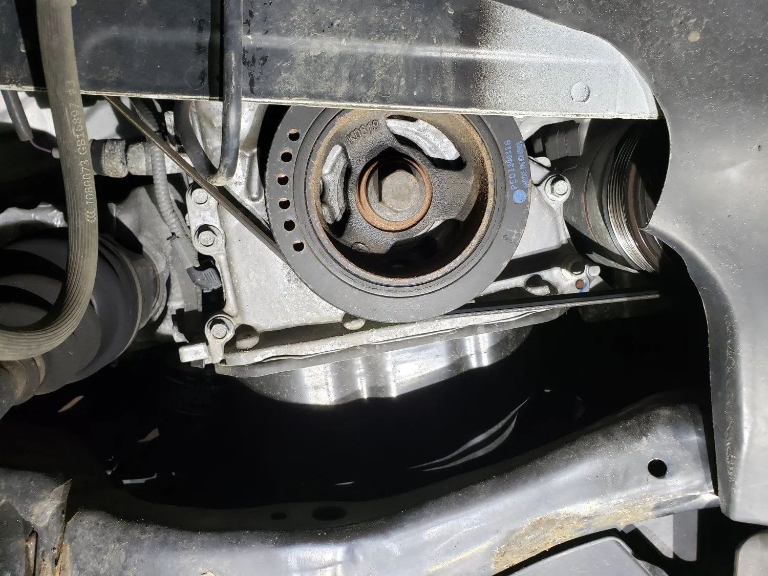

OK, I'm a failure! I did NOT replace the belt tensioner or belts today. I got all ready to decided to due the "take-off-the-right-front-tire-and-splash-shield" method. I did that and unfortunately, unlike the Mazda3 in the video, the belt tensioner in the CX-5 is in an almost impossible position. I gave it a shot but I couldn't even release the tension to remove the serpentine belt. So I closed it all up and I'll bring it (and all the parts) to my favorite mechanic and let him have all the fun! To be fair, this is "probably" DIY doable if you have a lift since the working position would be much better, but I don't have a lift.

And after removing the tire and the splash shield, here is the view. Lots of metal in the way of where you need to get too. Tried both from this angle and the top before I gave up. Can't imagine that the standard shop time for the swap is .4 hours of labor!
Thanks for the info. Now we know accessing the tensioner from wheel well doesn’t work for CX-5! Did you keep the old tensioner where you can check the part number and serial number stamped on the tensioner?
I haven't taken it to my mechanic yet. But I will ask for the old part when I do.
That’s so weird. I was able to remove the belt and tensioner just fine with the wheel and shroud removed. The tensioner pivoted pretty easily with a wrench applied to the proper spot.
