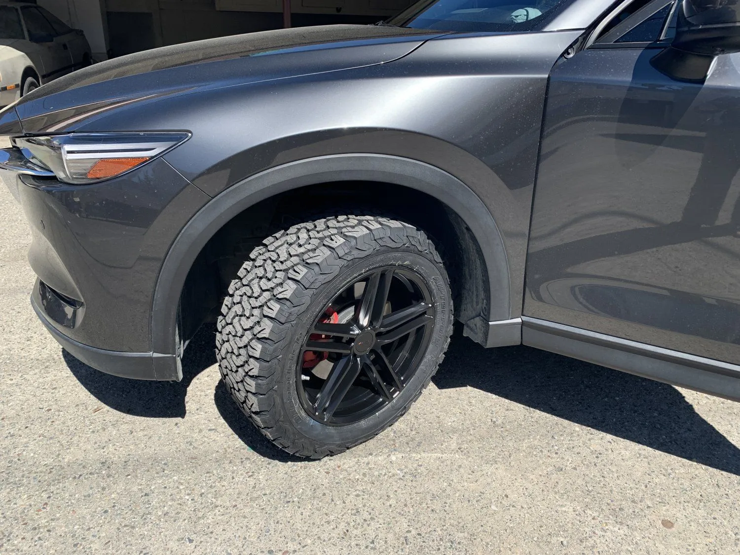

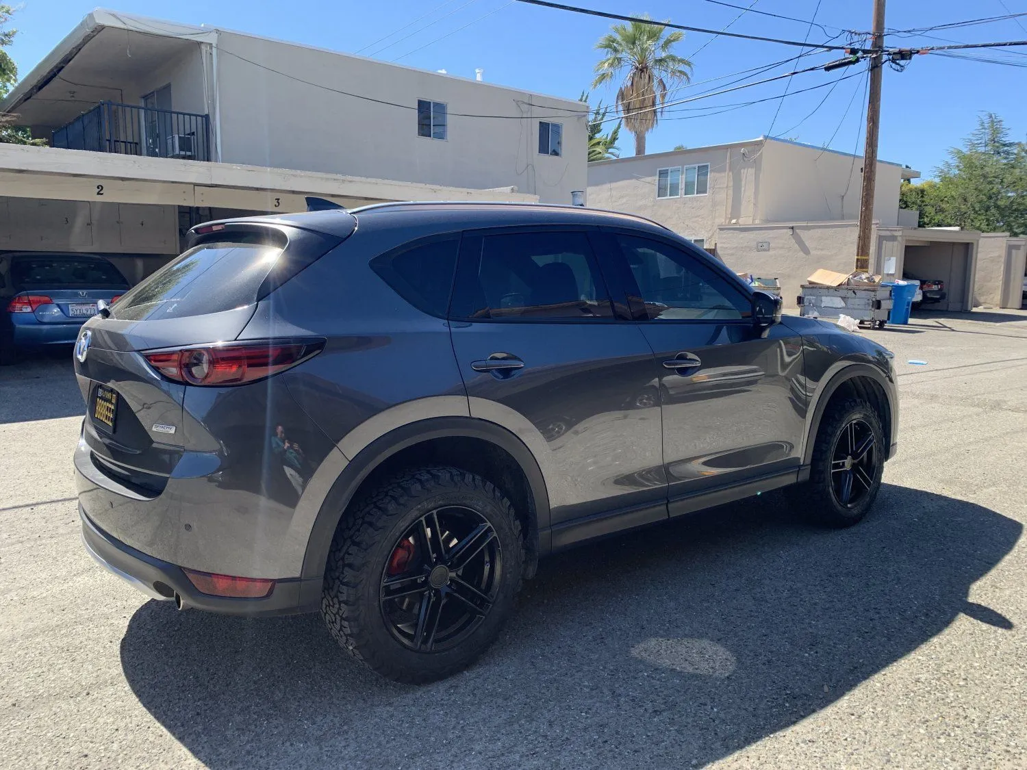

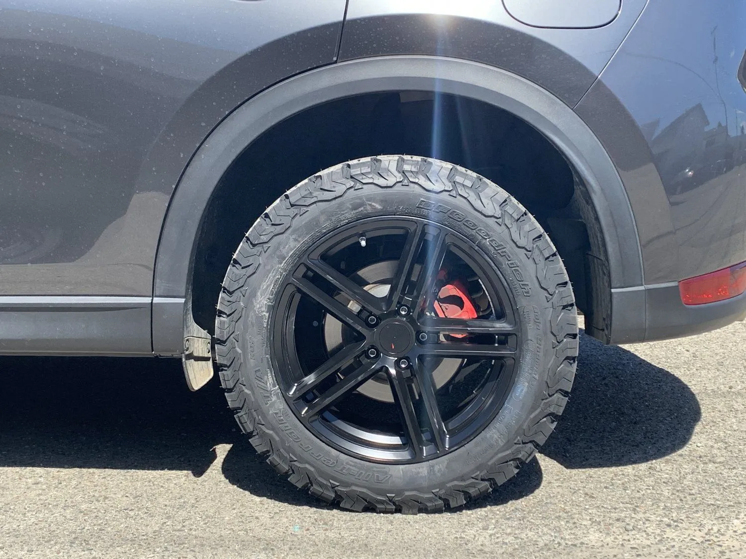

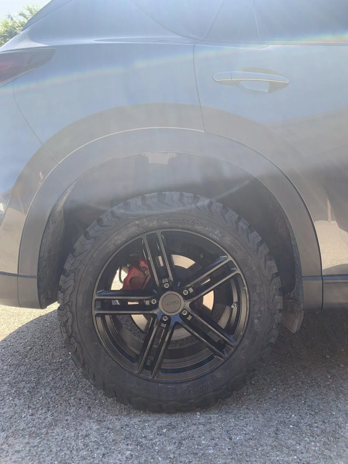

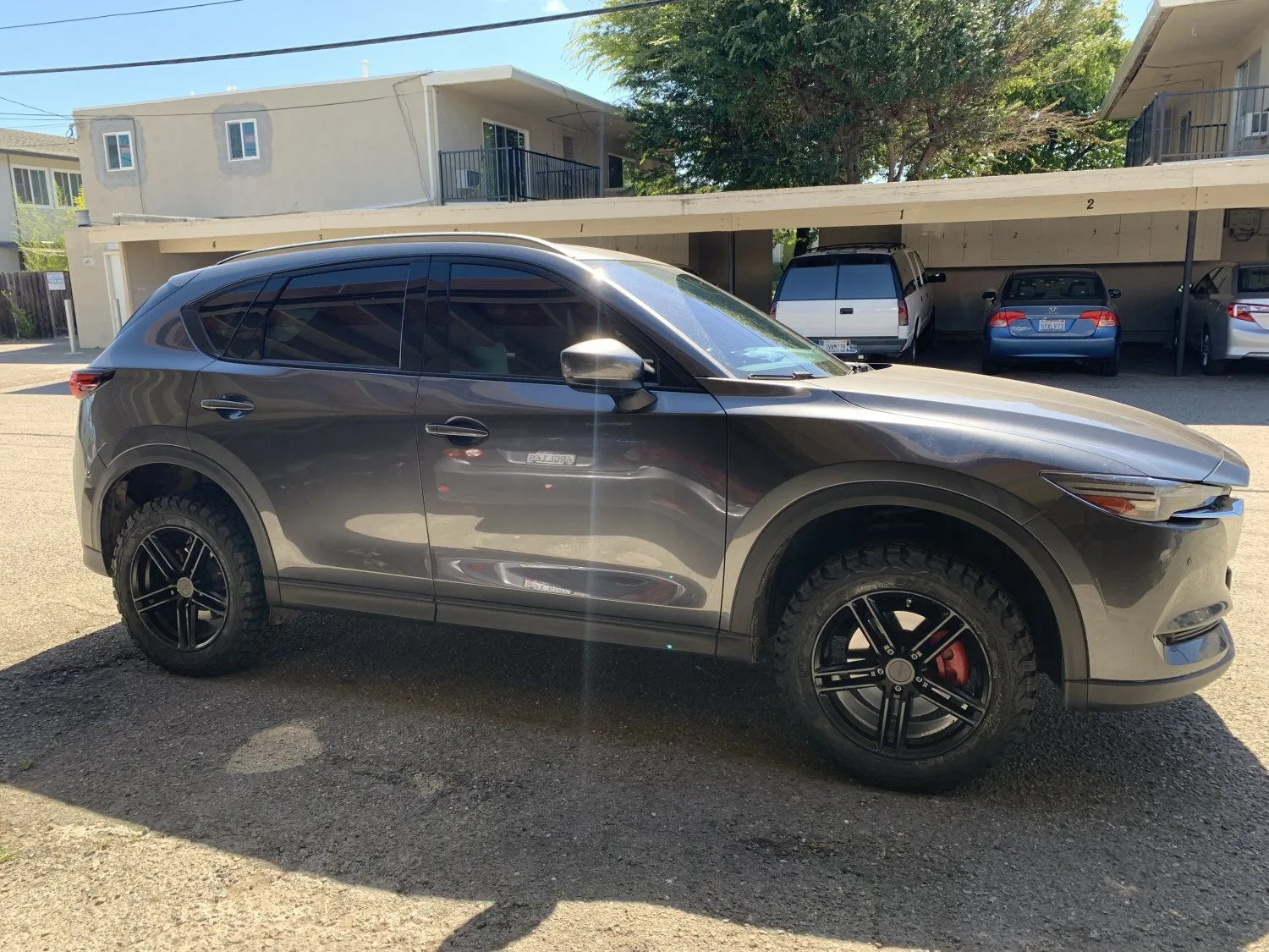

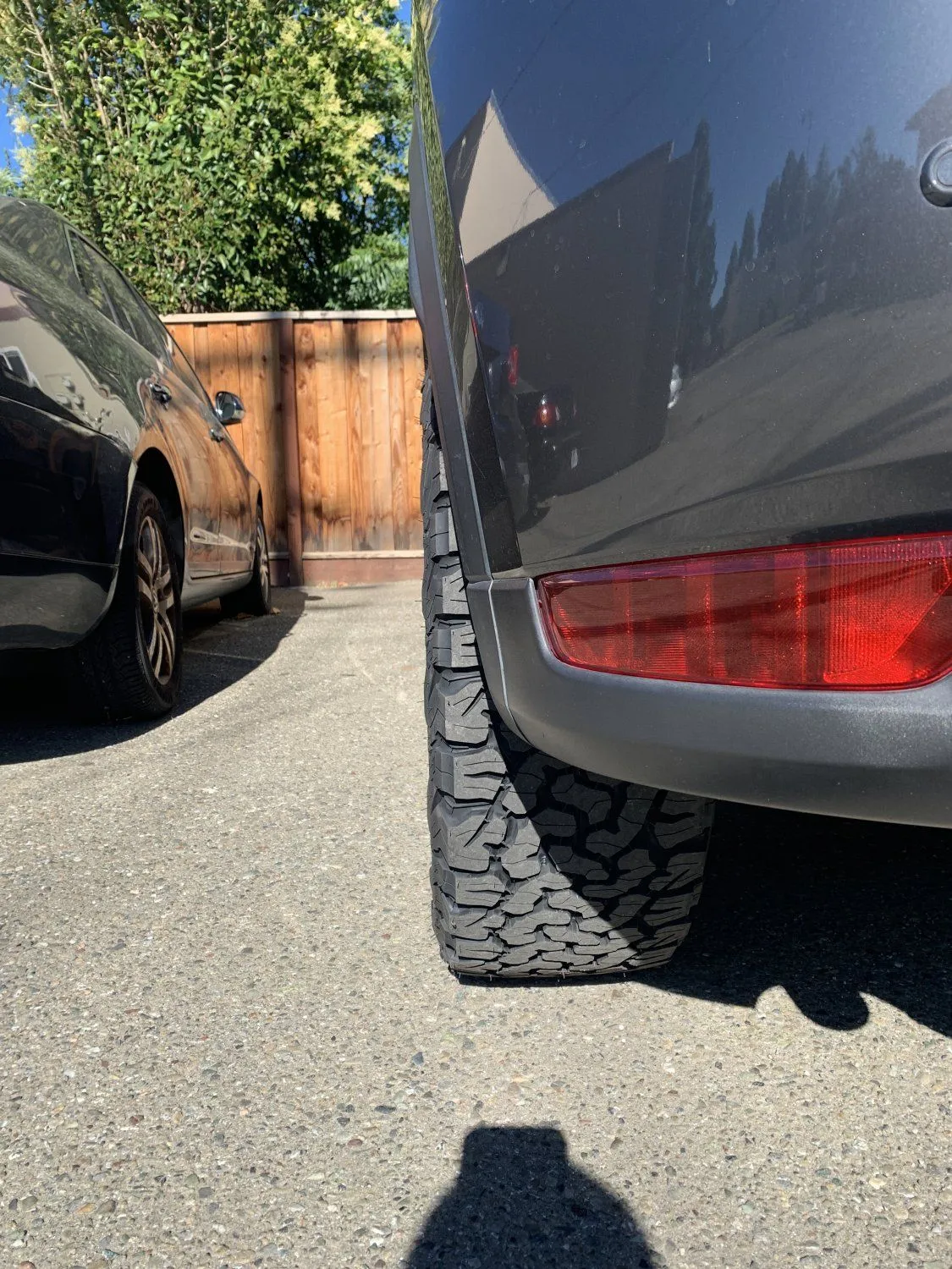

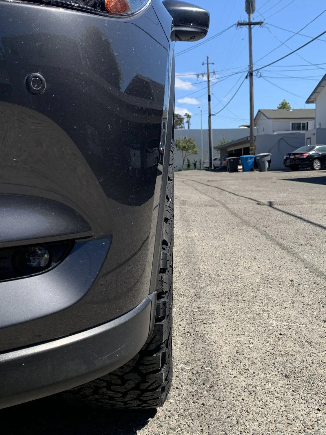

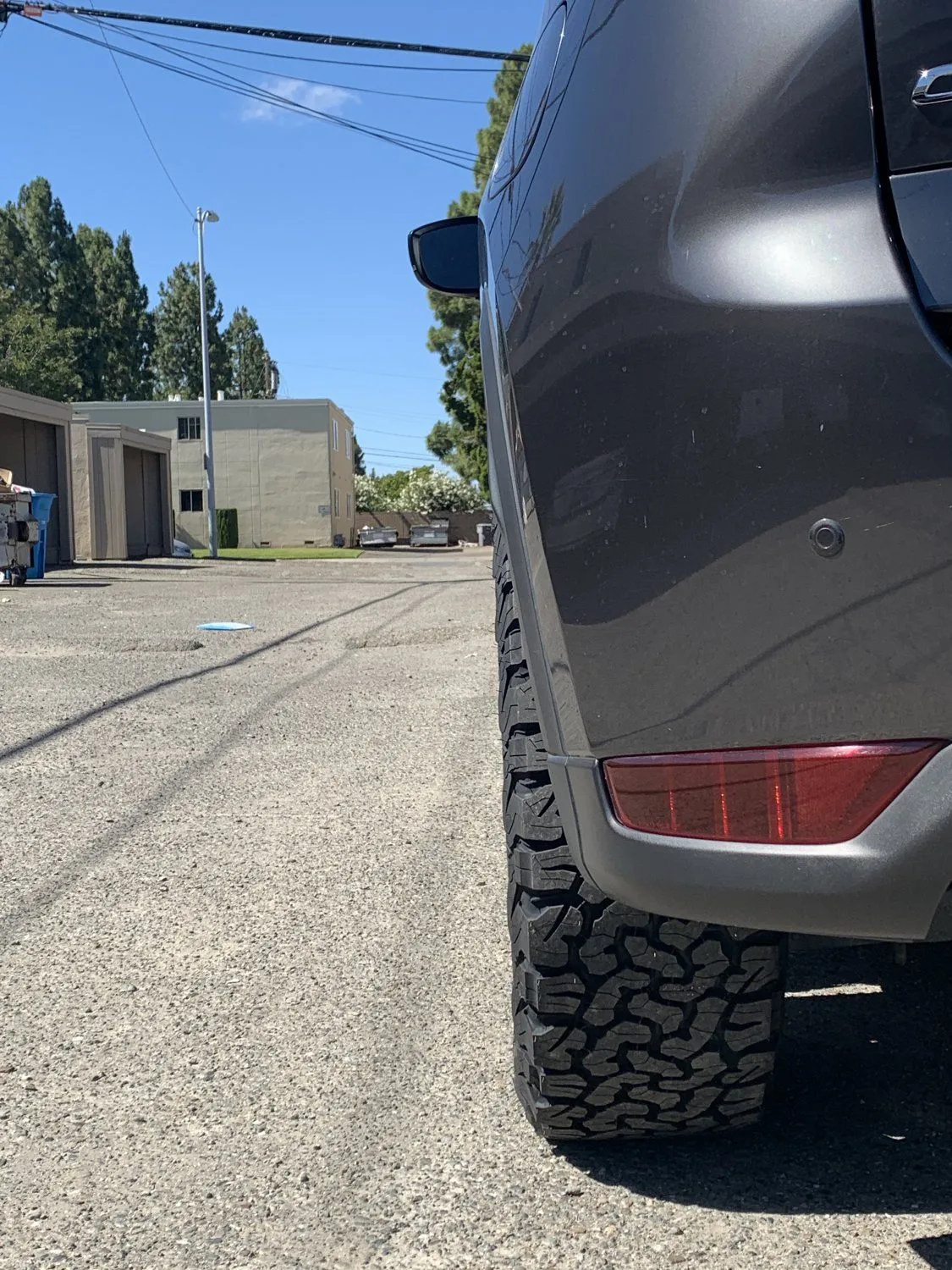

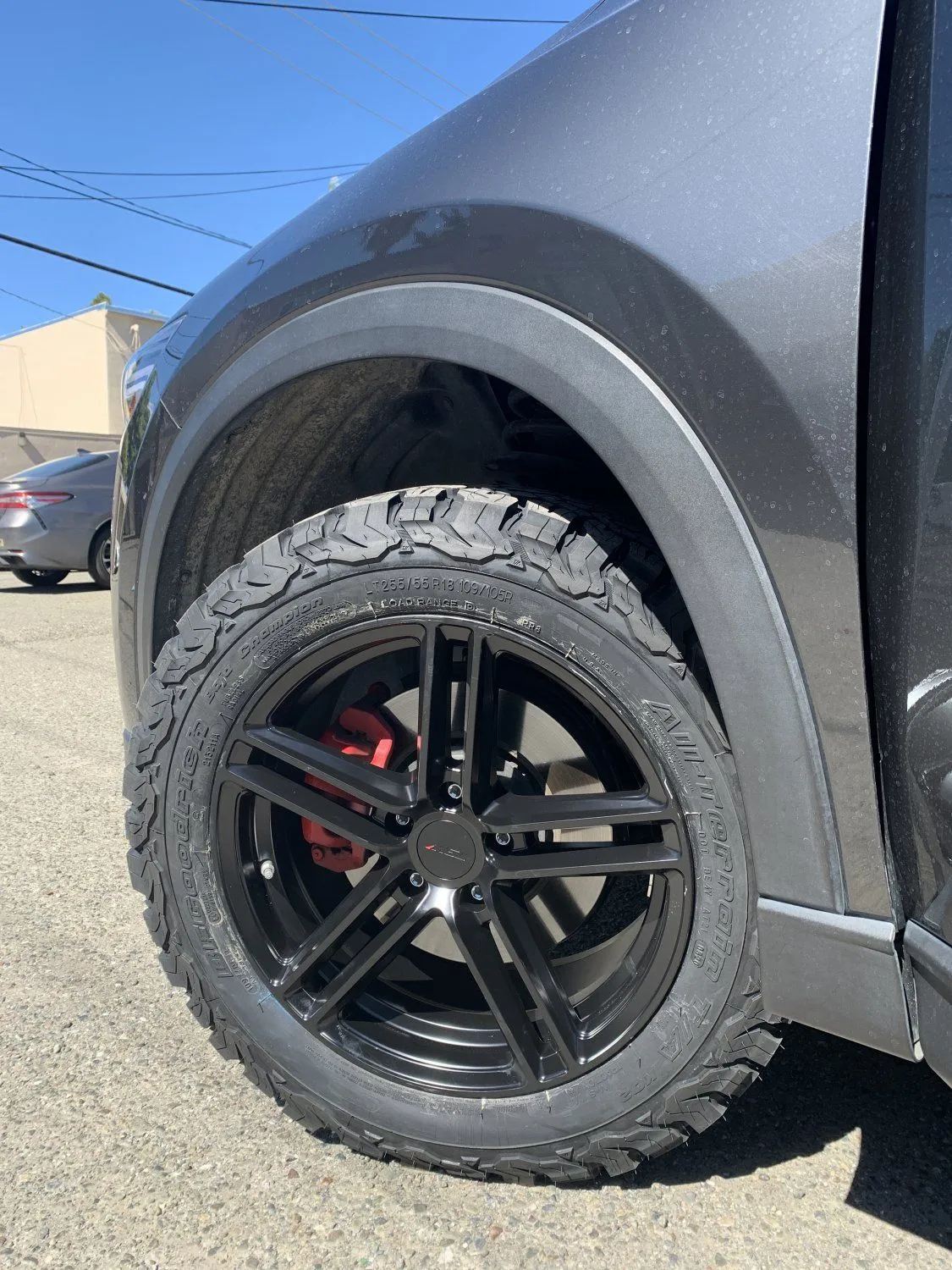

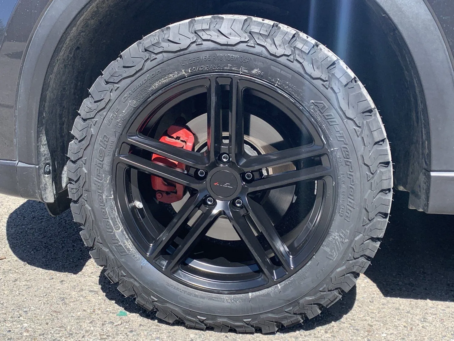

Just sharing my build :
1.5 inch lift
Offroad tire BFG TA KO2 255/55r18
Wheel : TSW chapelle +40m 18x8.5
No rubbing. Road noise coming from the tires did increase but it's not intrusive or annoying. I notice CX5 has a very effective noise insulation because though I can hear the increased noise, it's still pretty quiet as I can still listen to music with perfect clarity. It's like the insulation is just blocking a particular range of frequencies that actually make hearing music, having conversation, etc difficult.
Handling : surprisingly improves a lot. I can't describe it better than by saying that it feels like closer to driving a sedan. Prior to having these tires, I had 235/55r19 geolandar g015 AT on stock wheels 19x7J and it felt springy and mushy when cornering. And at first I thought that downsizing the wheel to 18 inch and having a greater side wall coming from the 255/55r18 would have a more negative impact on the handling but it turned out to be quite the opposite because of the very sturdy sidewall of the BFGs

Considering where I live, I will consider a tire like this is a couple of years when it's time to upgrade. Thanks for the report on fit and noise.
This is different, and I dig it. Nice bonus regarding the upgrade in handling!
very cool look. Have you try full droop to see any issue with your axles? Also some Rally Armor mudflaps, roof rack w/ a full spare some tools and maybe a light bar would definitely finish the offroad look.
x2, this is exactly what I would do to complete the look.

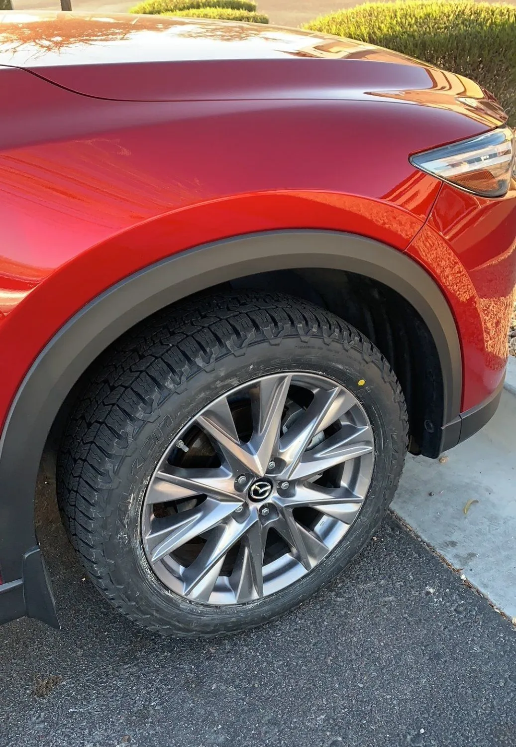

@taba2 I just installed some FALKEN WILDPEAK A/T 225/55R-19 on factory wheels this week. They look good and feel great. I got 33K miles from the stock Toyo A36.
