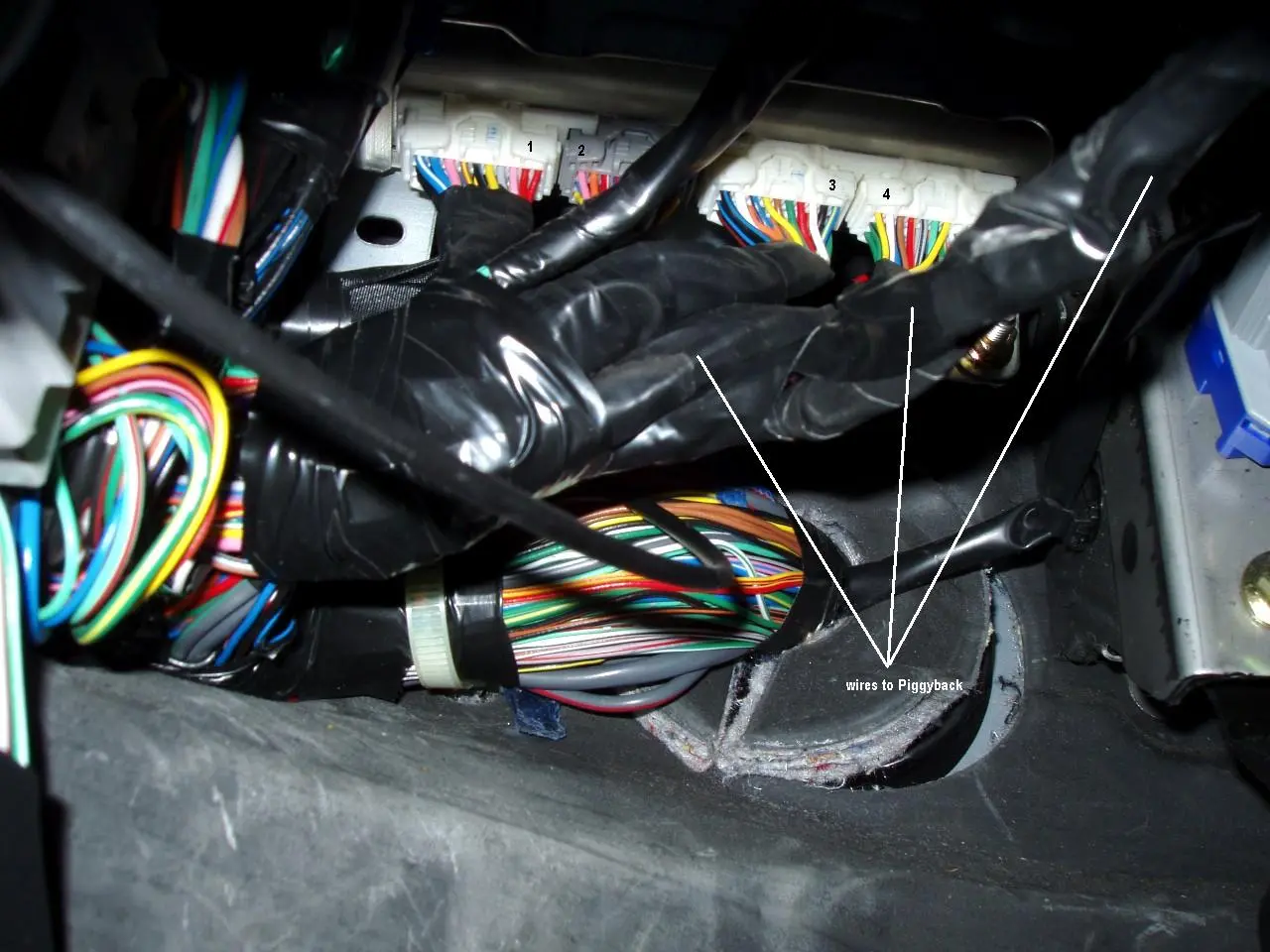

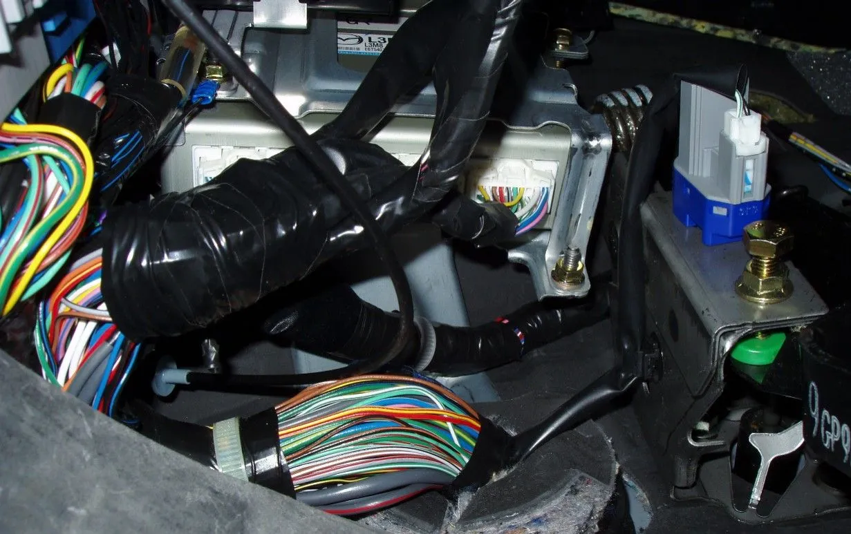

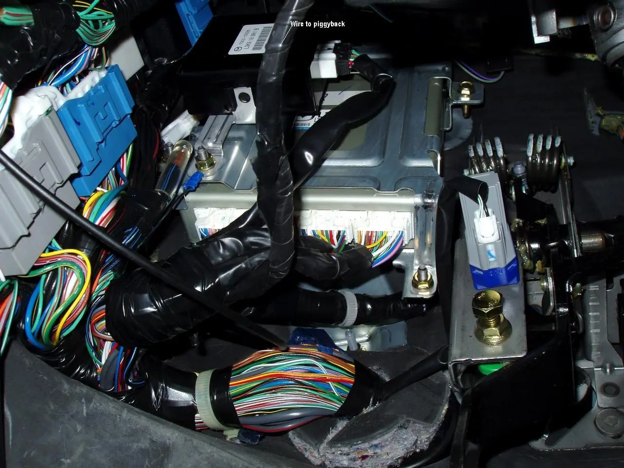

dadasracecar said:I thought I'd post a few more pix of the install. These are higher quality. If you don't know what you're looking for, you'd never see the extra set of wires going to the piggyback. If I have to take it out, it's just cut two zipties. The bypass plug is small and so I could tuck the extra wires around behind the ECU and likely no tech would ever spot it.

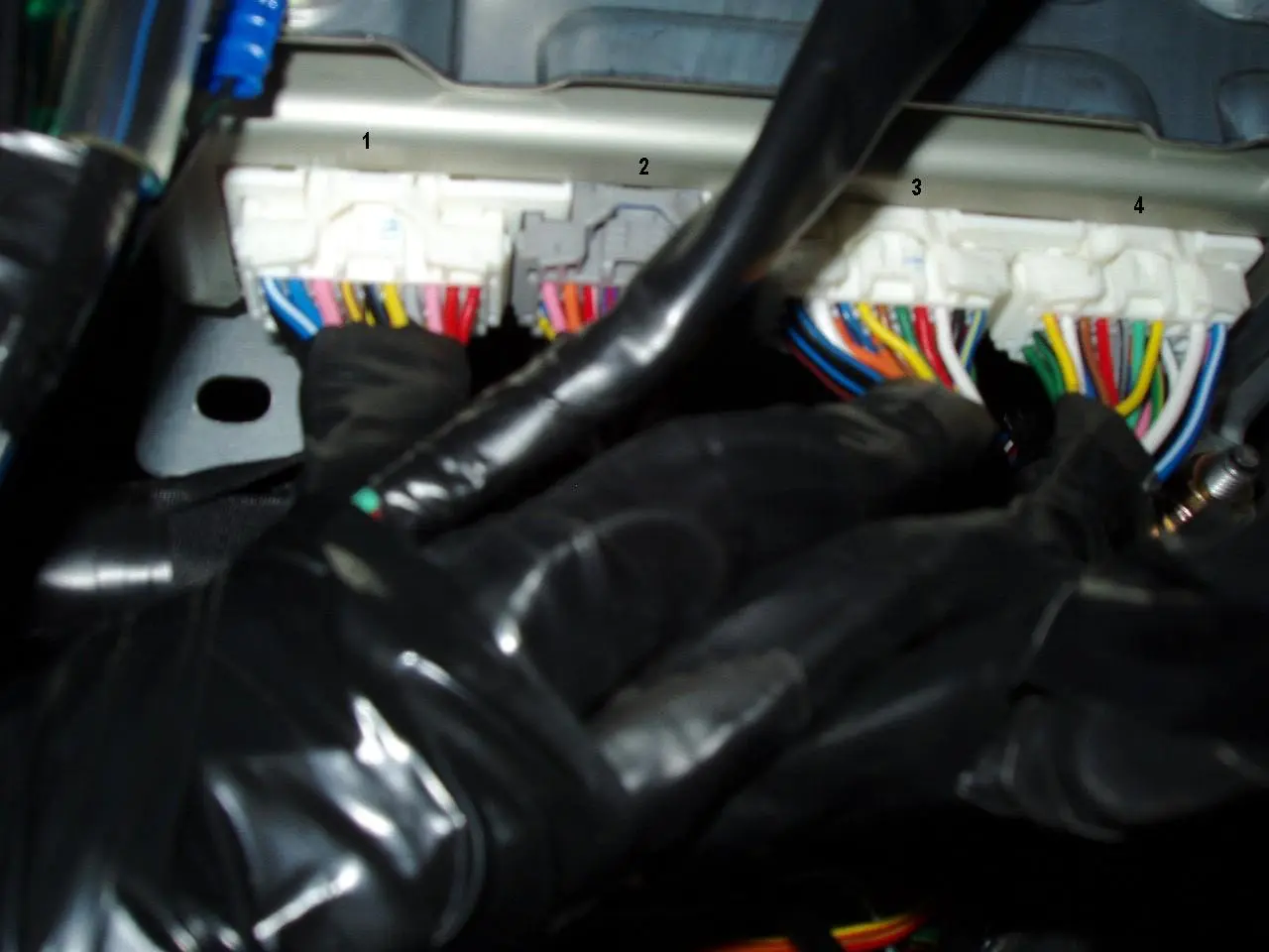

Here's a closeup of the ecu connectors that CPE needs for a PnP setup.
www.cp-e.com said:Right now Dadasracecar is just using the boost control, and it's set at 15psi. The difference he's feeling is probably due to the precise boost management. The stock wastegate control is pretty poor in that your boost goes all over the place, from idle to redline. Our boost control on the other hand uses a PID feedback loop to control the wastegate solenoid, as opposed to a straight duty cycle above or below the factory settings. So if the car is capable of making the boost you're requesting, then you'll get it.
From the tests we ran during development, we were able to hold up to 17psi to redline. It does taper *slightly* towards redline as the throttle does affect things slightly, but not even close to the MS3's throttle dance. Whether the turbo is running out of breath, or if the throttle is playing games with us is up in the air, and requires more testing. But to answer yor question, yes, the piggyback will help the car hold any boost pressure you desire, all the way to redline.
