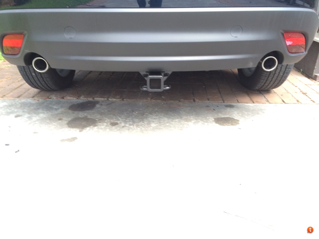

I just installed my 2" Curt III yesterday. It took about 45 minutes by myself with breaks for pictures. A big hitch looks more manly (lol2). Now just need to look for a fairly cheap bike rack that holds my mtn bike by the wheels (bike)

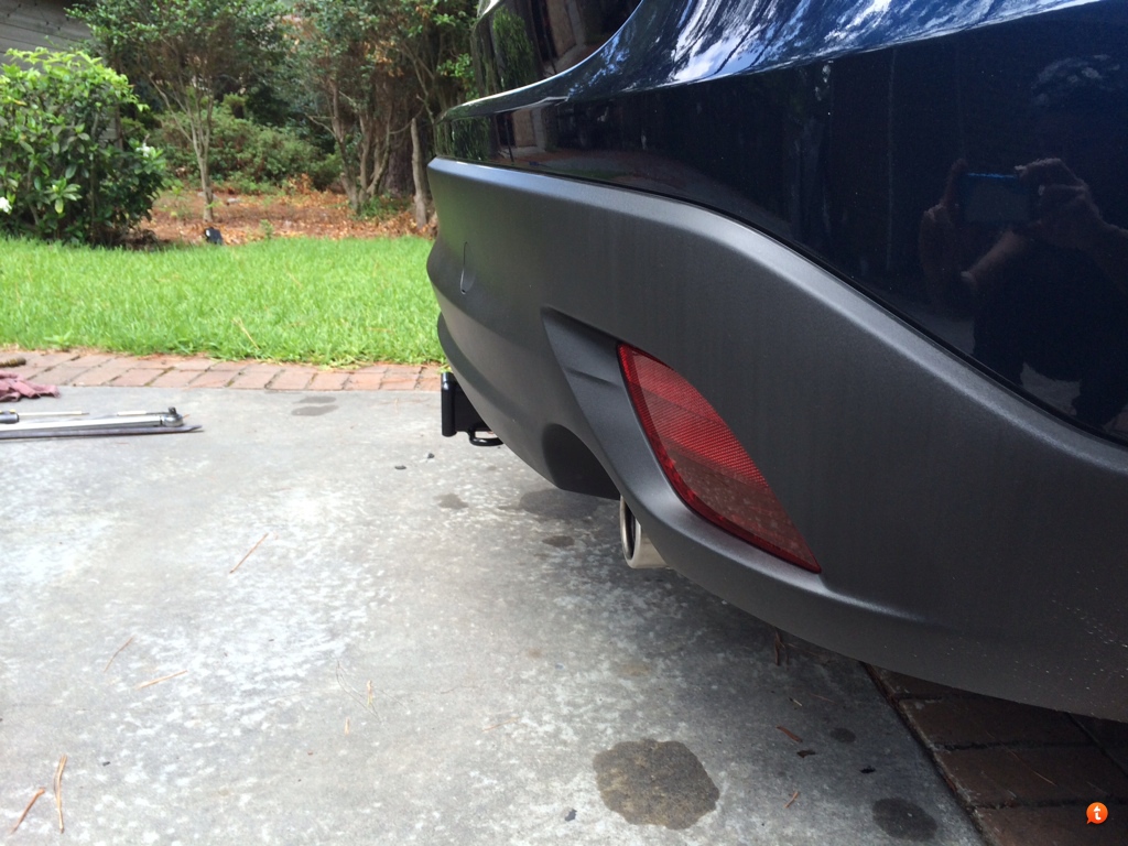

Side view, about flush to bumper

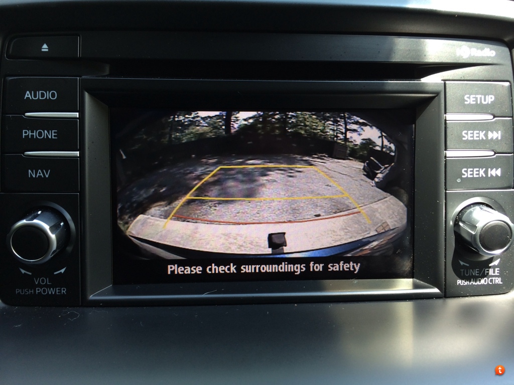

I like that I can see the hitch receiver on the rear cam-

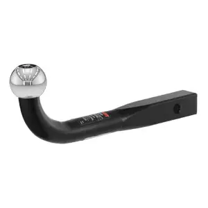

I installed the Curt 1 1/4 inch receiver and bought the euro look ball mount
I tool the ball mount to my local welding shop and had him fill in a bit of the hole for the pin. I then tapped the hole for 1/2-13 THD.
When I put the ball mount on the car it is BOLTED on. It doesn't rattle. It can't rattle.
I am very happy with the performance and the look.
