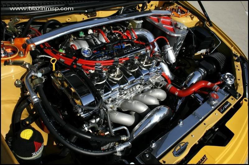

Current Engine bay pics everyone
Latest pic
