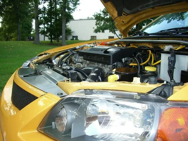

Current Engine bay pics everyone

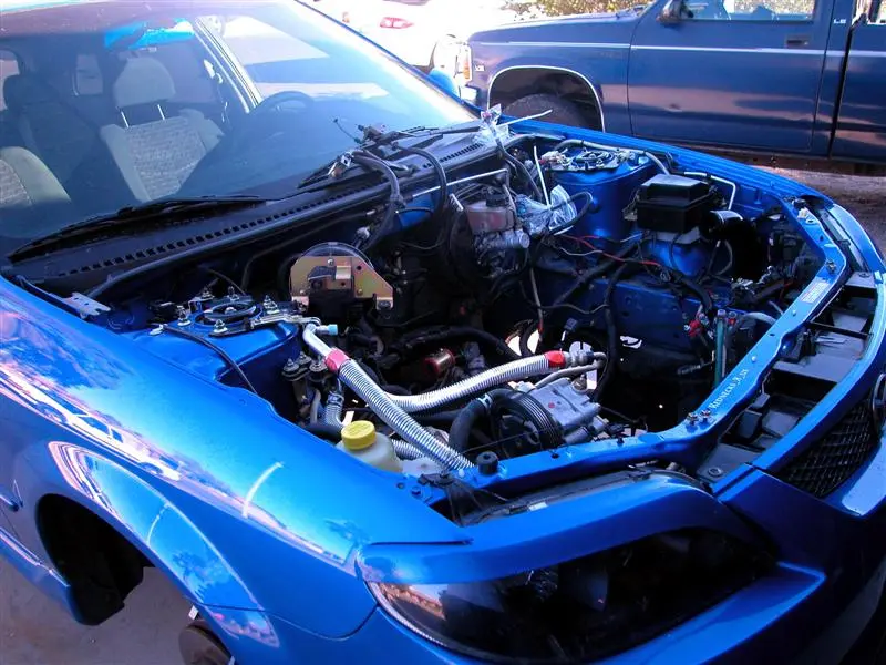

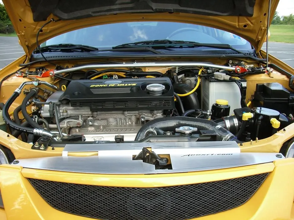

don't mean to put you on the hot seat, but did you notice any difference over the SMIC? You think this would give a better result than an FMIC? And lastly, how is it mounted?-- I've always wondered where/how one would mount it.
its not done yet lol i dunno how it works. elec tape, string and zip ties just dont work well in the booosted environment.
i think throttle response wise, yes its better , but with teh small core i got u get limited on CFM so i cant run big boost (15 psi plus). but i wont need to. its mounted right where u see it. i made some brackets, the end tanks have bosses in them u drill out and tap.

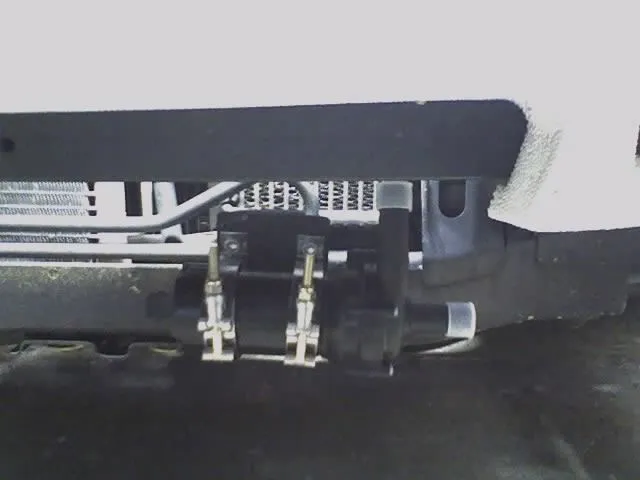

heres a pic of the pump, also crappy.

looking at that pic from your cell phone again, I realized exactly how close the end of the heat exchanger is to your throttle body-- that's very nicely done. Any concerns about the proximity to the block heating up the exchanger? I'd love it if you posted some pics close up of how you mounted it :)
Also, what did you do about a resevoir?
im not worried about it getting superheated really, im taking out the smic so im gonna have a bunch of airflow. the heat exchanger is in the front bumper grill (mounted like a fmic). ill take pics when i get the pipes welded cause i have to redo the brackets. for the water tank i have a 2.0 gallon tank in the trunk. i was going to put it up front but i just dont have the room for anyhting more than a gallon. ( i could if i custom made a tank, but ive spent enough for now).
i actually have a resevoir thats the same shape as the stock smic but it only holds 2 quarts so im afraid it will be too little water. so im going to put a tank in the trunk so that i dont have to custom make anything else cause its a pain in that tight engine bay.
What about using slightly diluted ethylene glycol instead of water?-- that's what I'd do. Pure ethylene glycol has a boiling point of 197.3 degrees celcius as opposed to water's 100 degrees. That might do you better than simply water. What do you think?

yea i havent decided on what im using exactly. i learned a neat trick where u can put that alcohol and distilled (i think) water in frezer (certain mix ratio) and it will get realllllly cold but wont freeze too. i just called the cooling liquid coolant. if i use coolant im not gonna put ice in it so ill probably use a water, alk mix so it doesnt freeze

Boiling point is higher, yes but straight water has more heat-carrying capacity... (It is more efficient.)

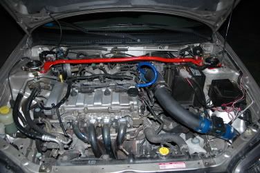

dang still looking good.do you cover anything when you spray it down or do you just go at it?im weary of spraying so i just use a rag to clean as best i can.
i wrapped the delicate components in cling wrap and sprayed down everyting else. i was able to use shop air to blow off what ever parts i didnt want water sitting on when it was soaking. came out decent.
COVER SPARK PLUGS.. trust me you don't want to deal with what I did.
