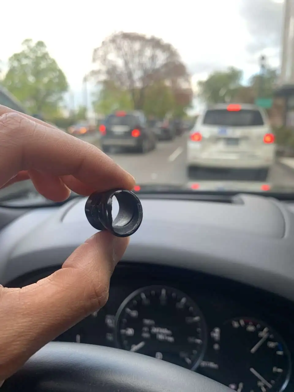

A few weeks ago, i noticed a faint popcorn popping sound possibly coming from the air circulation/line/air intake.
Two days ago, after running idle for 20 to 30 min, my engine started to rough idle and would stall without acceleration/throttle.
Took it to Mazda. The vacuum plug had melted/popped! Mazda was able to same day fix as they were able to find the leak and replacement quick.
I will say that a week ago I came back from a 2500 mi trip from OR to CA and back again, and basically would go straight - i may have made my return trip in 12 hrs 😅

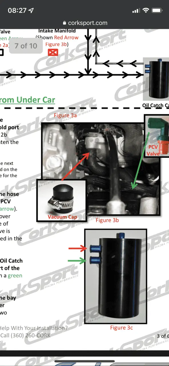

I’ve probably had the Cork Sport Oil Catch for around 15k miles and it’s served me extremely well! Every oil change, which is from 3500-4500 miles, I also empty my OCC, and i usu get what you see in the attached image.
Again, I highly recommend the OCC, just be aware of possible overheating that can melt silicon parts.
