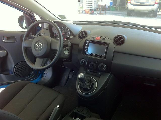

The install was cake. Everything went great.

I've never really been into car audio systems, which is funny because I'm a musician, albeit, not a good one. However, I think I'm gonna add some power to the sounds in my 2. DaleNixon's install looks really good and I bet sounds even better..... Time to research.
