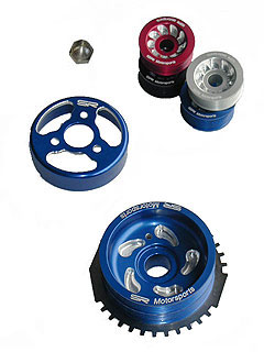

this is srmotorsports pullies and you can see that there are 2 gaps on is very big the other isn't...now if i remember correctly the gaps are only on the CA models 2.0L from what they told me

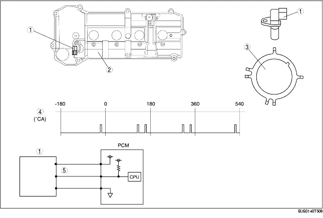

Well does it look like the crank pulley teeth pictured in the attachment named crank below? Which basically it has 2 gaps (or 3 depending no how you interpret) that are 180 degrees from one another.. one gap is just empty, and the other gap has one tooth in the middle of it... or does the crank pulley on your car look totally different.
Also, does the end of the intake camshaft where it meets the cam sensor have 4 nubs on it like is pictured in the other attachment?
check the message again i edited it with a pick of what they look like..and i don't know about the cam question
is that really waht they look like? because instead of having gaps, they have solid filled in sections I'm seeing on there.
thats how the stock ones look as well...i will find my stock pully and take a pic of it so you can see that its the same.
