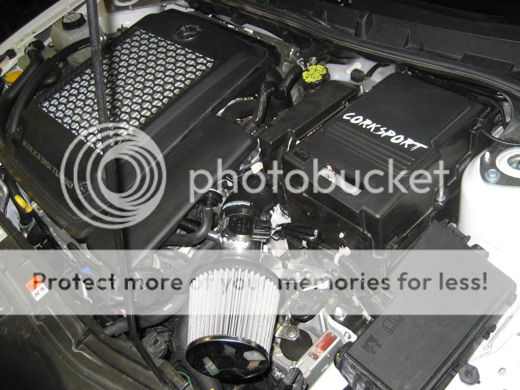

Well I just got back from de-virginizing the intake. The sound is intoxicatingly amazing, the mid range power gain more than caught me off guard. I installed it w/o a problem following CP-E's instructions. It is very quiet until about 2.75k rpm then it opens up and get's louder. No significant sound increase crusing on the highway. Well worth the money IMO.
^ +1 - the install was easy with good vendor instructions. So far, I am happy with the power gains, but not able to really jump on it yet. Sweet mod.

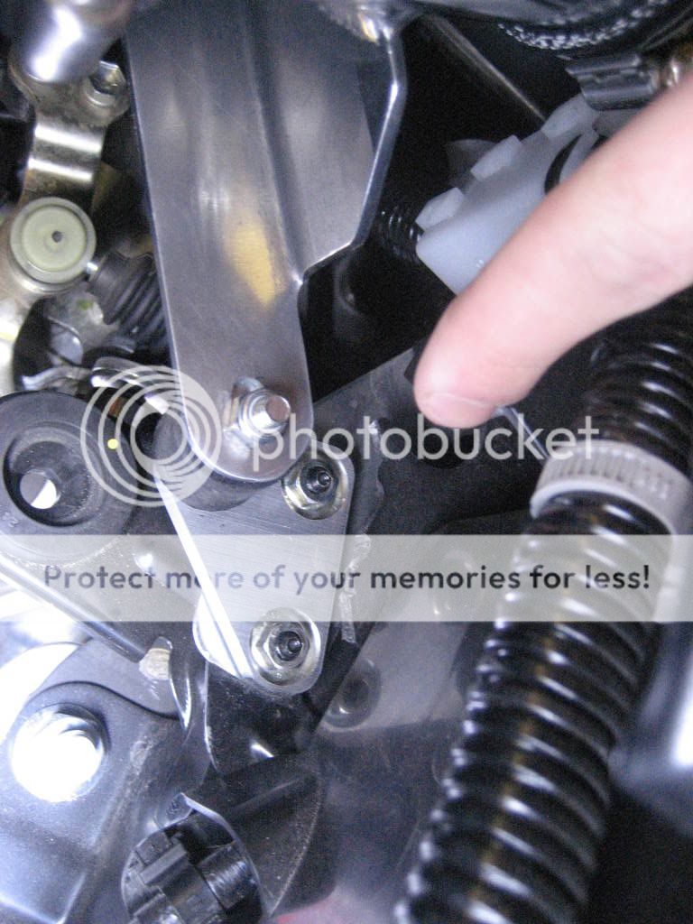

I installed mine last night. This first picture shows the only problem that I ran into, the little plastic piece stuck out and was in the way of the Nano bracket mount. I ended up just clipping it off as best I could so it was no big deal. Love this thing!

It did not have to be cut. A flat head screwdriver to lift up the piece is all you needed.:)
See the bolt and nut that is on the right side of the vibro-mount. When I was taking off this bolt and putting it back on, the first 2 threads got stripped off and now I can't get the damn bolt back on. The rest of the screw is fine but literally the first two threads are stripped. Anyone have any suggestions about retreading the top of this so I can get the bolt back on? I was possibly thinking maybe I could take a metal file and file off the top part until I cleared away the stripped threads. Figured I would ask first before I tried anything.
This is not my picture it is PCspeed3's, I just didn't have a picture I could use to describe what I was talking about.
Well great, I should have looked at this thread before installing mine. Although its not a big deal, I dont think a plastic tab will blow my motor or anything. IKE filing down that bolt is probably your best bet, you may be filing for an hour or two, but I would imagine it would work.
PCspeed3, thanks for the help, the one nice thing about all the houses around me being destroyed by flooding is that all the contractors know how to chase a thread and rethread the top part of bolts, hopefully it will work out, if not im busting out the file.

I decided to go with the Nano instead of the Cobb; I received my CPE Nano on the 12th of this month and installed it in about 1.5 hours; I found that the instructions were a lacking a bit; a downloadable PDF would be better since the color on the manual was washed out. I disconnected the batter to reset the MAF. This is a nice mod; I’ve only had my MZ3 since September. I noticed the car breathes better; and has more power in the upper mid to high band since the turbo seems that it does not have to work as hard in the low range (500 - 2,000). I can hear the Nano at about 2,400 – 2,500 and perhaps the turbo spool at about 3,000. I did notice that my BOV does not hold the boost as well (I would have loved to get both the Nano and the Forge BOV polished, but lacking funds for both). Overall the one thing I noticed was the improved gas mileage. I’ve boosted quite a bit and have only used up about a little less than half a tank when I first installed it and filled the tank all the way. Prior to the mod I would have gone of a tank easily. I hope when I add the BOV it will still keep that MPG. I know once I get a better BOV, I’ll gain some HP/TQ back.
