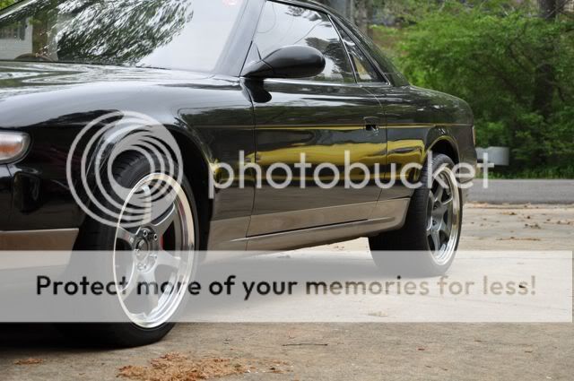

Here are some wheel specs..
I'm currently running Forgeline ZX3 3 piece rims with titanium hardware 18x8 +30 front and 18x9 +42 R. Fits fine but I have slight rub now since lowered the car.
Here is a pic..
I've also put 18x9 front and 18x10.5 SSR comp (type-c) it fits but it looks weird.. I think it would look better if I could lower it. Tire is 295/30/18s for the back..
also the car came with 17x8.5 front and 17x9.5 rear.. I don't remember the offset.. I have to check.. But fronts were 235 and rear was 255.. I think??
Hope this helps. Good thing is that the rear could take 10.5 SSRs.. I think the Antoine post of some cosmo NA race car with SSRs probably had the 10.5s as thats the widest it goes. I have the same set with 275s on, but I like how the forgeline looks.
In regards to wheels, I have a pair of 10 inch SSR's on the back of mine atm. They have a 32 offset AND the car is also lowered on coilovers. I think that we rolled the guards out by 2cm in total. The car can still be lowered more and the wheels have room to tuck in under the body.
I have seen a Cosmo with 12 inch wide rear wheels (18 inch diameter). I will try and dig up the photo's.

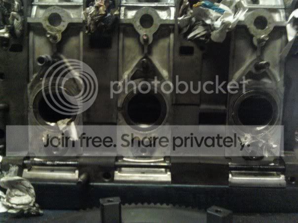

This motor I got built is done that way (see below)... Low mile "D" series engine with all new internal with slightly touched up intake ports and restrictive exhaust sleeves are removed and 13B-REW sleeves in placed with slight porting. Also, If you have "#", "A", or "B" series 20B, I would be worried about making ton of power. I have a "#" series 20B I'm building also but it will go in the Cosmo as a replacement.. Not planning to make ton of power. Currently I have "B" series 20B in the Cosmo. If you don't want to change out the sleeves (not many know how to), you could just get 13B-REW housings and use them.. I wanted to keep 20B logo on the housing and spent the extra labor.
You could see another 3 rotor on the engine stand.. Crank tested every motor before install
end play is near perfect. All new internal, D series housings except one (# series housing), D series Eshaft and rotors, balanced.
Exhaust ports..
Test fitting the manifold and the turbo.. Turbo is a Turbonetic T-76 Dual Ball bearing.. Should be good to about 800. Manifold is made with Inconel and wastegate is greddy race wastegate.
