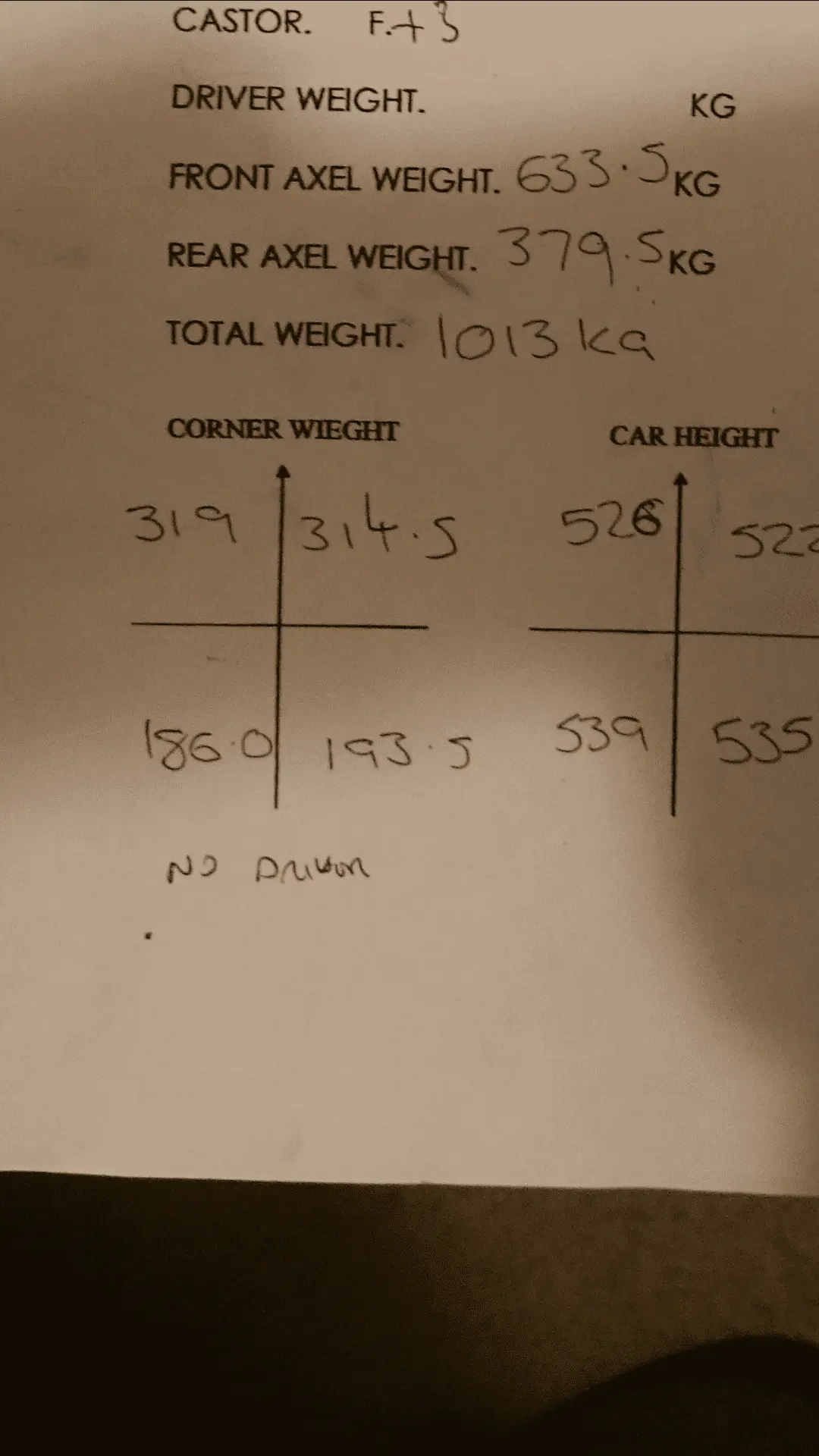

Was about to start adjusting my suspension for the new year and wanted to know what figures people run for corner weights.
My corner weight was not done properly so I will be adjust heights and stuff first then getting it done at a different place.
Sent from my C6903 using Tapatalk
I know but is there a specific amount of weight I should place over the rear and front?
There's a few different chains of thought on this topic. I'll outline them briefly and open it up to discussion of each.
1st is the most common one as Zach mentioned; even cross weights. It's tough to do on our cars without really wonking up the ride heights. The right rear is the lightest corner and the left front the heaviest. It's almost impossible to get a true 50/50. You can get close, but not exact
2nd is a side to side percentage. Since the car will never truly be cornering on one wheel alone and using the entire side to enter and exit a corner, try to get a 50% side load balance to the car.
Ideally you'd like both, but it's tough in our cars especially because the rear beam transfers weight so differently than a fully independent rear.

Thanks heaps. Here is my old one without driver weight and is with full tank and full interior also.
I want to do a new set up that includes the driver and takes out most of the contents of the rear trunk

Jeff is right about the ride height. You will end up with thing being off a good bit to get the cross weights correct. Mine wasn't that bad, but I think one is 1/4" off.
